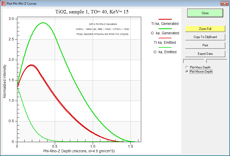

So we used the phi-rhi-z curve plot feature in CalcZAF(!) to try and see where the emitted x-rays are coming from. For reference here is what TiO2 looks like at typical EPMA beam energies (15 keV):

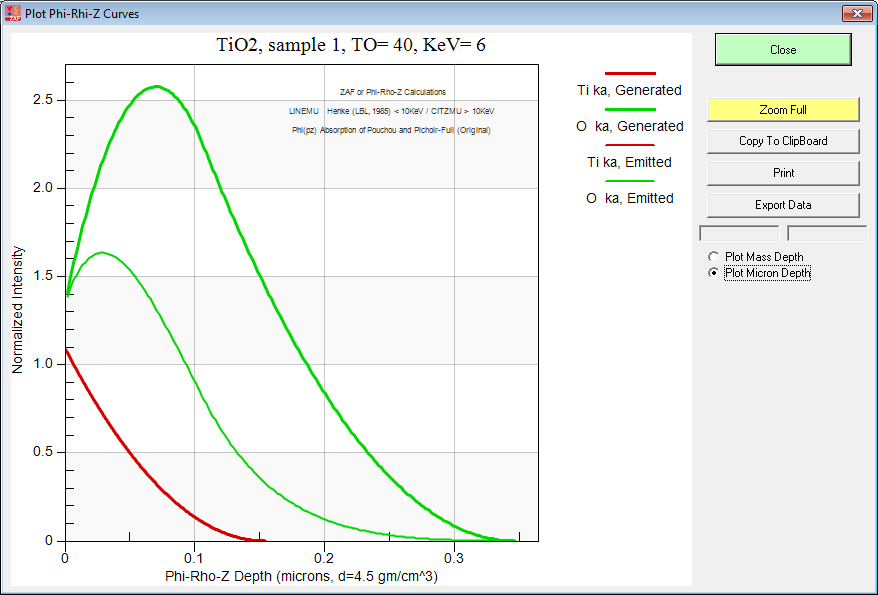

And here is TiO2 at 6 keV:

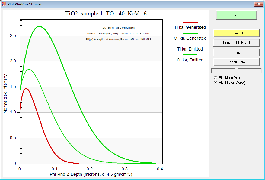

By the way, if you want to do this sort of modeling to decide on your analytical strategy, be sure to utilize either the PAP or XPP methods because they are physically realistic in their depth distribution. After all they were "tuned" using multiple thin film depositions!  Just to demonstrate the point here is the Armstrong pr(z) curves for TiO2 at 6 keV:
Just a wee bit of difference!
Anyway, even at 6 keV we'll be getting significant oxygen emission from the substrate, and also because the film thicknesses varied over the surface of the deposited films, we decided to treat it as a normal multi-voltage thin film analysis, where we don't know the compositions nor the film thicknesses. Which is what we typically do for thin films, and so we measured the Ti K and O K lines at 6 keV and 8 keV.
I will just say that we got results that were consistent with their models, but I've asked them to re-deposit the Ti-O films on a substrate that does not contain oxygen such as Si or C.  They'll probably use carbon substrates because the Si crystal structure will apparently affect their film properties.
