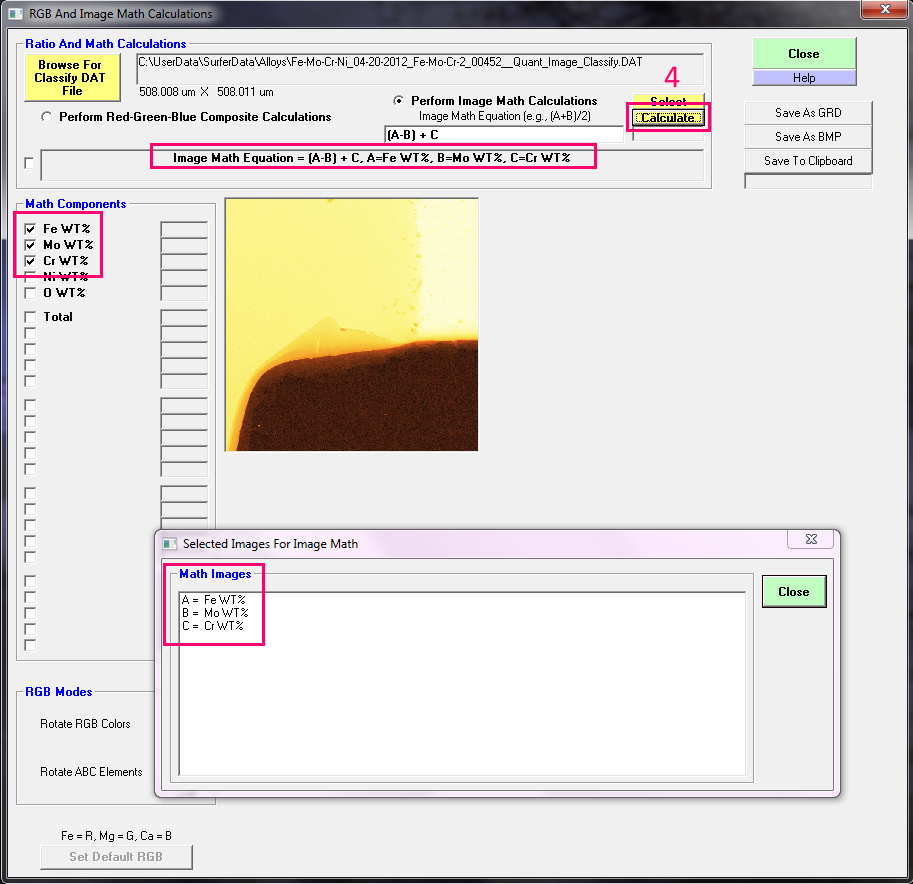

We recently re-wrote the image math code and GUI in CalcImage so it should be much more intuitive and easier to use now.
As you may know the ability to perform mathematical operations on images is accessed from the Image Processing menu in CalcImage as seen here:
The new code and GUI seen here:
now behaves by utilizing the currently opened Classify .DAT file (just like the RGB feature does). So when one clicks the Select button, the user simply checks the element checkboxes listed on the left, that correspond to the variables in the typed equation, where A = an element, B = an element, etc.
Please update PFE, try it out, and let us know what you think.
