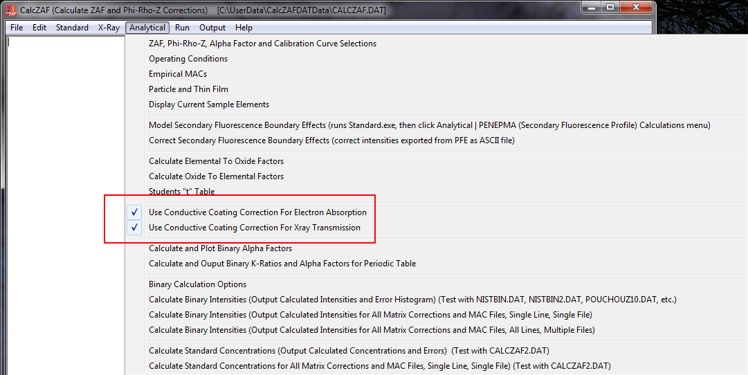

To make things a little more clear I added additional output for CalcZAF which confirms the standard coating parameters (in addition to the already output unknown coating parameters) in the log window.  First thing (after opening your input file) is to remember to turn on the coating correction flags in the CalcZAF Analytical menu as seen here:
Here is the normal output for an unknown sample (2nd sample in the default input file CalcZAF.dat):
Fe2SiO4 from Intensities
Using Conductive Coating Correction For Electron Absorption and X-Ray Transmission:
Standard 895, Coating=C, Density=2.1 gm/cm3, Thickness=200 angstroms, Sin(Thickness)=311.145 angstroms
Standard 14, Coating=C, Density=2.1 gm/cm3, Thickness=200 angstroms, Sin(Thickness)=311.145 angstroms
STANDARD PARAMETERS (TOA= 40):
ELEMENT  STDNUM STDCONC STDKFAC   Z-BAR  ABSCOR  FLUCOR  ZEDCOR  ZAFCOR COATTRNS COATABSR
   Fe Ka     895  72.080   .6781 20.9954   .9969  1.0000  1.0662  1.0629  .99994  .98001
   Si Ka      14  46.740   .4101 10.8047  1.1059  1.0000  1.0306  1.1397  .99703  .98427
    O Ka     895  27.640   .1948 20.9954  1.6505   .9937   .8650  1.4188  .92223  .98449
ELEMENT STP-POW BKS-COR   F(x)e   F(x)s      Eo      Ec   Eo/Ec
   Fe Ka  1.0939   .9747   .9846   .9877   14.99  7.1120  2.1083
   Si Ka  1.0565   .9755   .9056   .8189   14.99  1.8390  8.1533
    O Ka   .7992  1.0823   .7008   .4246   14.99   .5317 28.1999
Sample Coating=C, Density=2.1 gm/cm3, Thickness=200 angstroms, Sin(Thickness)=311.145 angstroms
SAMPLE: 2, TOA: 40, ITERATIONS: 4, Z-BAR: 18.68271
ELEMENT  ABSCOR  FLUCOR  ZEDCOR  ZAFCOR STP-POW BKS-COR   F(x)u      Ec   Eo/Ec    MACs uZAF/sZAF
   Fe ka   .9979  1.0000  1.0977  1.0954  1.1370   .9655   .9867  7.1120  2.1091 60.8022  1.030541
   Si ka  1.4033   .9993   .9549  1.3392   .9279  1.0292   .6453  1.8390  8.1566 1635.92  1.174991
   O  ka  1.8082   .9955   .8887  1.5998   .8337  1.0660   .3876   .5317 28.2114 3698.75  1.127603
ELEMENT   K-RAW K-VALUE ELEMWT% OXIDWT% ATOMIC% FORMULA KILOVOL COATTRN COATU/S KILOVOL COATABS COATU/S
   Fe ka  .73722  .49993  54.762   -----  28.516   5.322   15.00  .99994  .99994   14.99  .98001  .98001
   Si ka  .25234  .10348  13.859   -----  14.349   2.678   15.00  .99703  .99703   14.99  .98427  .98427
   O  ka 1.00861  .19649  31.435   -----  57.135  10.663   15.00  .92223  .92223   14.99  .98449  .98449
   TOTAL:                100.056   ----- 100.000  18.663
However, since the coating is specified as the same for both the standards (#14 and #895) and the unknown, the calculation isn't significantly affected (though it might be if these elements were acquired at a very low overvoltage)...
Now we specify the unknown as having a say, 5 nm Al coating using the Calculation Options button in the CalcZAF program:
Sample Coating=Al, Density=2.7 gm/cm3, Thickness=50 angstroms, Sin(Thickness)=311.145 angstroms
SAMPLE: 2, TOA: 40, ITERATIONS: 4, Z-BAR: 18.85708
   Fe ka   .9980  1.0000  1.0953  1.0932  1.1337   .9662   .9865  7.1120  2.1091 59.6358  1.028473
   Si ka  1.4062   .9993   .9533  1.3397   .9250  1.0307   .6440  1.8390  8.1566 1594.08  1.175423
   O  ka  1.8257   .9954   .8869  1.6118   .8310  1.0673   .3838   .5317 28.2114 3631.83  1.136095
   Fe ka  .72726  .49317  53.913   -----  29.365   5.306   15.00  .99981  .99981   15.00  .99358  .99358
   Si ka  .25058  .10276  13.767   -----  14.910   2.694   15.00  .99327  .99327   15.00  .99494  .99494
   O  ka  .93342  .18185  29.311   -----  55.725  10.069   15.00  .98597  .98597   15.00  .99501  .99501
   TOTAL:                 96.991   ----- 100.000  18.069
Note the effect on the composition since Al absorbs these x-rays differently than carbon (note this isn't a real test as the unknown sample *was not* actually measured with a 20 nm Al coating, so the direction of the coating effect is in the wrong direction).  If I specify the same Al coating for the standards as well using the Standard | Edit Standard Parameters (coating) menu, we essentially get back our original composition:
