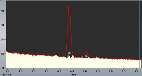

My questions on the topic were: What is the appropriate "background" to use for EDS CDL's?
Is it the intensity of a single channel at the X-ray energy, the summed intensity of all channels in the processed region of interest for an element's peak(s), or the average intensity of all channels in the processed region of interest for an element's peak(s)?
In the attached Fe K example, the top hat filter is processing the spectrum between 5.6 and 7.75 keV. Which channels do we care about?
Also, what is the correct way to calculate a CDL in the presence of interferences?

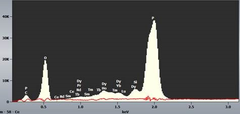

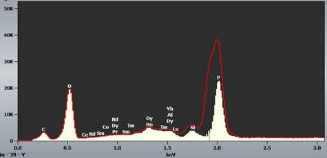

From a spectrum of xenotime (YPO4+REE buddies), I have removed the Y L counts used for quantification (xenotime1, attached). Is that what should be used for the Y detection limit?
Or would it be more appropriate to use just the continuum with all peaks removed (xenotime2, attached)?
Then I did some light reading. Goldstein et al. 2017 (starting at Page 341) and Newbury and Ritchie (2015) have much to say on the topic. They seem to agree that the answer is using just the continuum. I'm still not entirely sure what energy range should be used, though.
