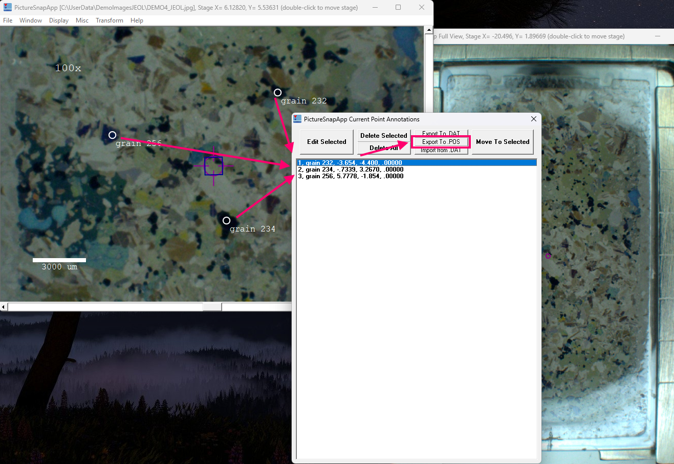

In the Point annotation list in PictureSnapApp we have added a new button called "Export to .POS" as seen here:
Using this button the three calibration points (you must use a three point calibration for this), and the stage coordinates of your annotation points will be exported to a .POS file, which can subsequently be imported into Probe for EPMA from the Automate! window:
https://smf.probesoftware.com/index.php?topic=405.0
One then confirm the original three calibration (fiducial) points in probe for EPMA and then you can navigate to the points annotated on the other optical (or other) microscope).
