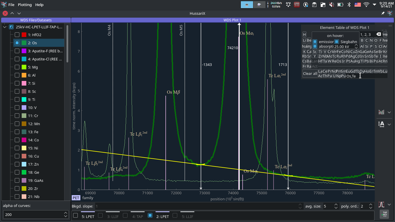

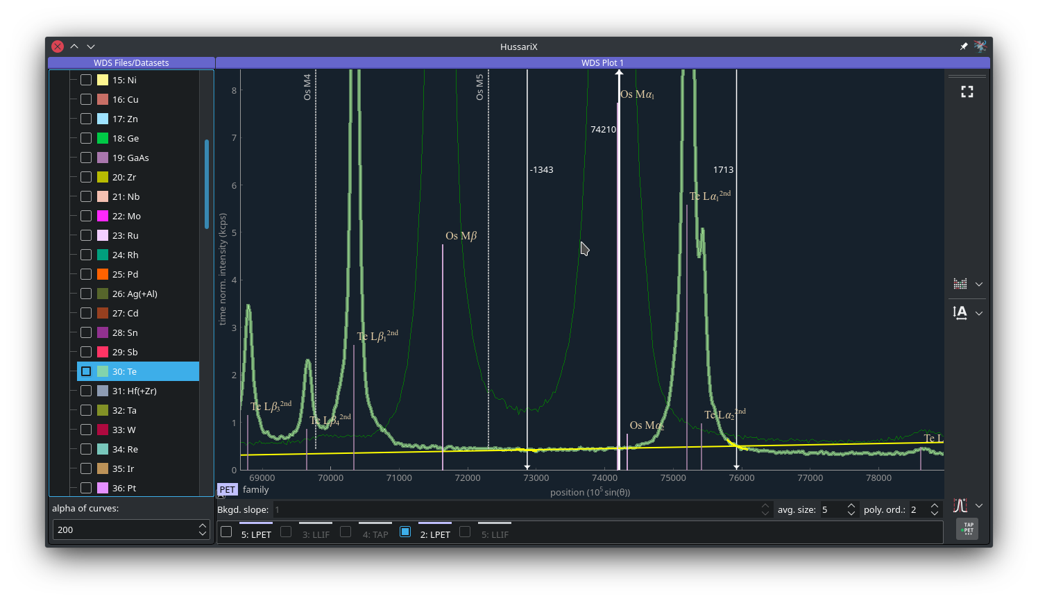

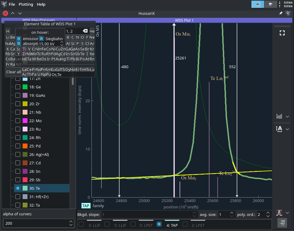

Consider Te as option too, I am attaching the wds scan pictures with metal Os and metal Te overlay (green is Os, teal is Te). In first figure Os is selected and background for it is shown, in second Te is selected and background is shown (at same positions). The truth is it could cause small issues if someone would use such standard without aware where to set bkgd positions, but for anyone aware of it that cause no problem. Also Te overlap is second order, maybe time will come with better PHA, and possibility to cut out 2nd order peaks (and ghm... background). OsTe2 also looks as better standard for EDS than OsS2 or OsSe2 where S and Se lines would be a bit too close to Os M lines (would cause complaint in DTSA-II). Oh, and I see it even does not cause a problem for TAP too, where it is possible to resolve it.

I've found that elemental Se is somewhat beam sensitive.  I've grown PbSe and Ag2Se, and both of these hold up fine under the beam (noting that Ag is often difficult in this respect).  Te Lα(2) is too close to the Os Mα peak position for my liking, especially on TAP.  Generally, I find that second order reflections are difficult to suppress using pulse amplitude discrimination.

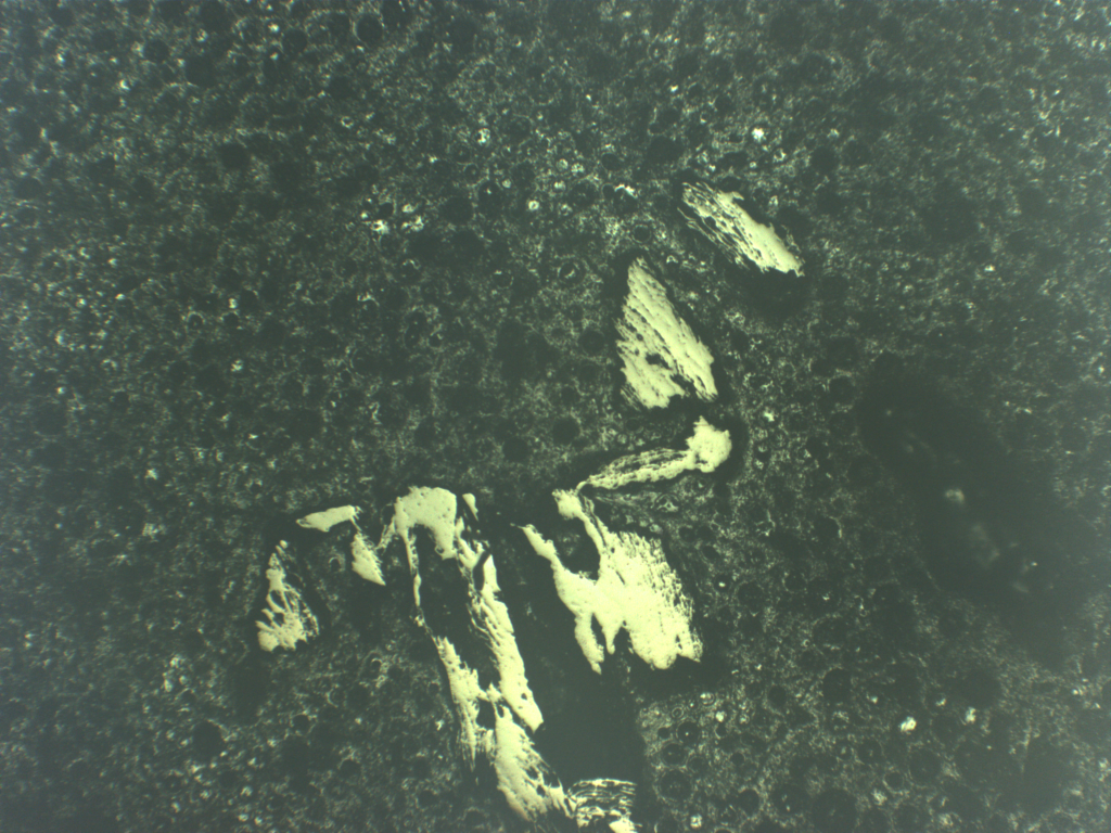

Anyway, I was curious, so today I went into the lab and pulled out my vacuum re-melted osmium standard.  Even after 4 years in the desiccator it still looked smooth and shiny under the reflected light microscope:
Maybe it's because it's coated with 200 angstroms of carbon it's protected from oxidation in the desiccator?  I also looked at my ruthenium, rhenium and boron metal standards in there and they also looked smooth and shiny!  But they also are carbon coated.
