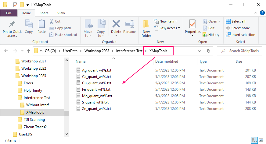

To use, simply open an already quantified map project, and click the menu item. CalcImage will then export the "classify" quant (elemental wt%) into XMapTools format as seen here:
into a sub folder called XMapTools.  If one has multiple projects in the main folder, the XMapTools subfolder can be renamed if desired.
Keep in mind that this export feature currently only exports the elemental wt% maps, as Pierre Lanari informs us that the oxide import in XMapTools is not quite working correctly yet. Also he sent us this link describing how to import already quantified maps into XMapTools:
