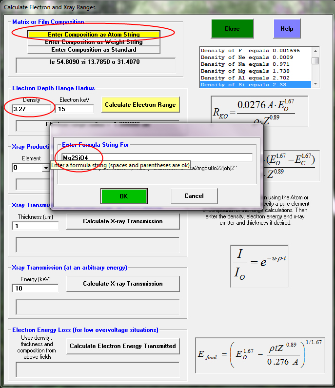

First we can get a rough idea by just using CalcZAF to tell us how efficiently these emitted x-rays transmit in these materials. For the olivine case we will assume two compositions, first pure end-member Fe2SiO4 and second, pure end-member Mg2SiO4. These done by simply clicking the Run | Calculate Electron and X-ray Ranges menu in CalcZAF and entering the appropriate densities and compositions:

So, now let's assume that the buried apatite phase is just at the 99% electron range so there would be a very small amount of primary electron excitation in the apatite, from which any x-ray emissions must then transmit through the olivine to be observed. Let's start by calculating the x-ray transmissions at each electron range distance using the same dialog in CalcZAF by entering the 99% electron distance here:

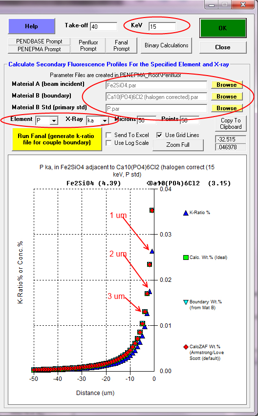

We can calculate this effect as a function of depth by "turning the problem on its side" and modeling this situation as a secondary fluorescent boundary case using Standard.exe and the Penfluor/Fanal SF calculation dialog as seen here with Fe2SiO4 (the only fluorescent x-rays from Mg2SiO4 that could excite the P or Ca k edge are continuum fluorescence because Si ka, Mg ka and O ka cannot excite the P or Ca k-edges in apatite):
which shows the effect for P ka where we can see roughly 35 PPM P ka intensity at a distance of 10 um due to secondary fluorescence.

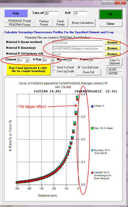

But what about Ca ka? Here is where it gets interesting. The secondary fluorescence effect is about 10 times larger for Ca ka than P ka as seen here:
This is because Fe ka fluorescence more efficiently excites the Ca K edge than the P k edge. Of course these effects at 20 keV will be a little larger but we'll leave that as an exercise for the reader.
