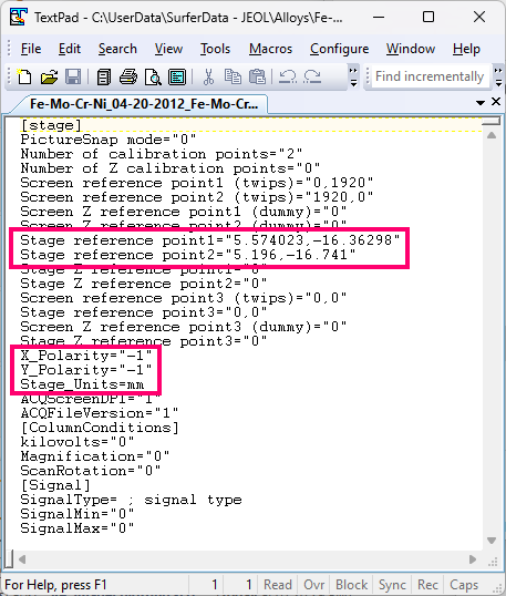

Note that because the GRD file must have cartesian X and Y coordinates (to be a valid GRD file for Surfer), we rely on a small file called GRDInfo.INI which contains the orientation and units:
For Cameca (cartesian) it looks like this:
[Stage]
X_Polarity=0
Y_Polarity=0
Stage_Units=um
For JEOL (anti-cartesian) it looks like this:
[Stage]
X_Polarity=-1
Y_Polarity=-1
Stage_Units=mm

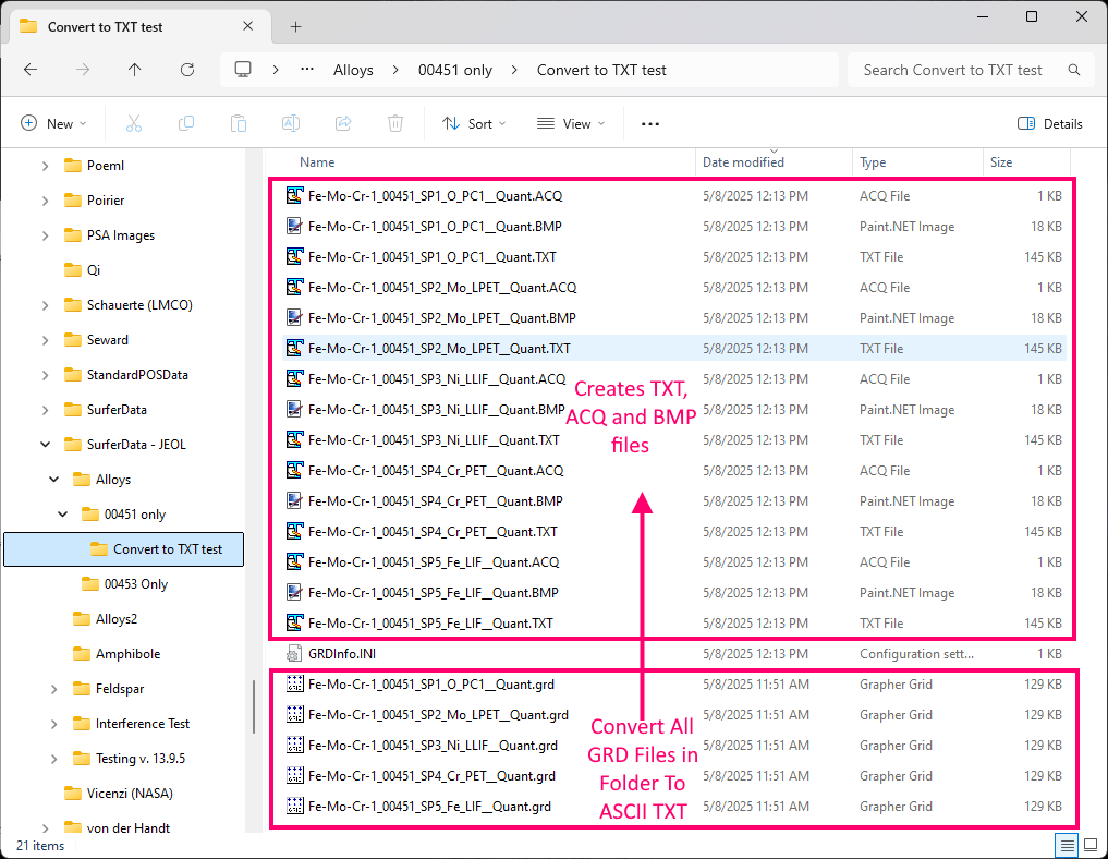

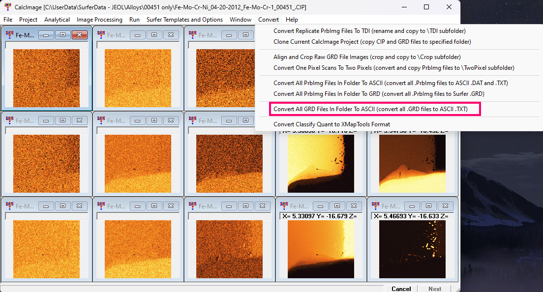

Quote from: Ben Buse on May 07, 2025, 11:13:28 AMSo if put into my scrip which loads oxide.txt files - it's complicated because .txt files have different naming structure to .prbimg files with the calcimg files naming consisting of mdb name in front. So have to loop for matching files. It might be easier if calcimage as well as producing ascii txt file also produce a text file with same name and different extension containing resolution. Or imagej script prompts user to select a single prbimg file as above. Eitherway below script works importing files into imagej and reading resolution from prbimg files
Maybe it would be better if I added the resolution info at the top of the txt files?
If that is OK, I'll put the info from the GRD files in there (X and Y and units from GRDInfo.ini).
Quote from: John Donovan on May 07, 2025, 11:56:23 AMMaybe it would be better if I added  the resolution info at the top of the txt files?
Thanks John for suggestion.
Unfortunately that would be problematic as imagej textimage expects no header, so would be best as currently is (which is why we designed the output as it is  :) )
Quote from: Ben Buse on May 07, 2025, 01:20:29 PMUnfortunately that would be problematic as imagej textimage expects no header, so would be best as currently is (which is why we designed the output as it is  :) )
Very much this! Please don't alter the text image output!

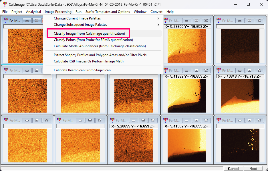

After one has quantified a CalcImage mapping project, open the Image Processing | Classify Image menu as seen here:
That will open the Classify Image windows as discussed here:
https://smf.probesoftware.com/index.php?topic=1071.0
Then perform a quick clustering operation on the map, using the default parameters (because we don't care about the clustering information). When the cluster calculations are finished (usually a few seconds), CalcImage will output GRD files for each cluster, and also a BMP and ACQ file for the project as seen here:

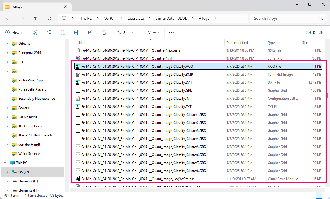

It's this ACQ file that can be used by one's script to read the stage extents, stage orientation and stage units as seen here:
The only reason I am suggesting this method is so you would have an ACQ file that has the same name as the CalcImage project file...
How does that sound?
OK, I think this is a better solution for importing GRD file quant images into ImageJ... we modified the convert code for GRD to TXT to also output an ACQ file for each GRD file:
Now when you run this conversion you get a TXT and ACQ (and BMP) file for each GRD file:
The ACQ file contains the stage calibration information along with the units (um or mm) as shown in the previous post. Now each GRD file will have the same name as the TXT and ACQ file and both are ASCII and can be easily read by a script.
Note you'll probably want to copy the GRD files you actually want to convert, to a separate sub folder, so *every* GRD file doesn't get converted. Unless of course, that is what you want!

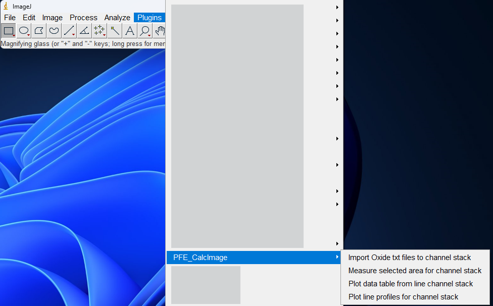

So now have the following in ImageJ, making it really easy
Quote from: Ben Buse on May 12, 2025, 04:17:46 AMSo now have the following in ImageJ, making it really easy
This is awesome.
Could you write up a little step by step procedure for this and post it here for those without programming skills?
Good point,
1. Copy the plugin folder to the plugin folder within ImageJ installation
2. Restart ImageJ if it is open, and should then be visible within ImageJ plugin menu.
To use line options first draw a line on the channel stack (the open window containing all the maps), if double click on line tool can specify line width.
To use the measure option first draw an area on the channel stack - either using rectangle, circle or freehand tool.
(Is it possible to attach files to forum post?; Otherwise can be downloaded from here https://github.com/Benjamin-Buse/PFE-ImageJ/blob/main/PFE_CalcImage.zip)
It is now on ImageJ wiki https://imagej.net/plugins/pfe-calcimage
