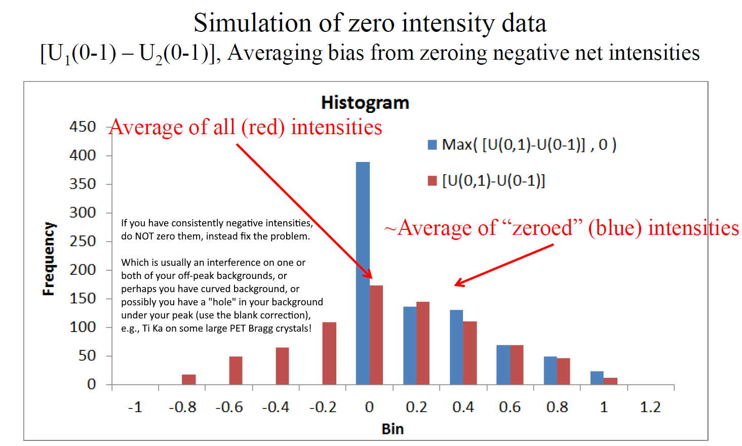

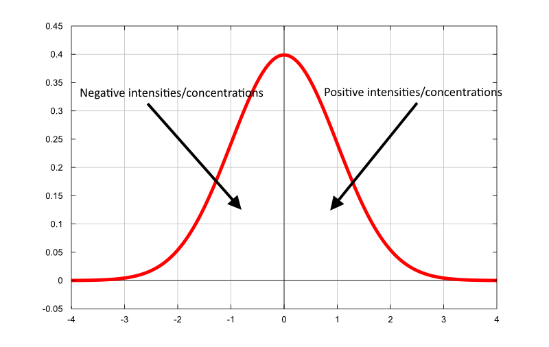

Paul is absolutely correct. It is important to pay attention to negative results as they may indicate an over correction of the background. Also, remember that if one is measuring a zero concentration, one would expect to see some concentrations reported as negative- in fact about half of them!
Why is this?  Because there will always be a variance about the measurement and if the average yields zero, some individual results will be positive and some will be negative as seen in this example:

In the above example we measured Ti, Fe, Al, K and Na in a synthetic quartz. The matrix was specified as SiO2 to assist in the matrix correction. Now although some of the individual data points and even the averages of some elements are negative, these values are just as "real" as the positive values for the reasons mentioned above.
How can we tell this? Because the average values in the AVER: line are all within 1 or 2 standard deviations (the line labeled SDEV:) from zero, except for Al. Now assuming Gaussian statistics we expect that 99% of our data should fall within 3 standard deviations of the accepted value, correct?  But that means that 1% of the time our variance will *exceed* 3 standard deviations so the 0.0029 wt % (29 PPM) reported could be a statistical fluctuation, but the odds are against it.
Again, why? Because we haven't made 100 measurements, only 5 measurements. And in fact, this particular SiO2 material has been checked using bulk techniques and is known to have about 1.4 PPM Ti and 15 PPM Al.
So the 0.0029 wt% measured Al is easily within 2 standard deviations of 0.0015 wt% (15 PPM) accepted value for this standard, as one might expect. So we were correct to be suspicious that this was merely a statistical outlier. It is actually an accurate though not very precise measurement for trying to determine 15 PPM concentrations (Conditions were 15 keV, 100 nA and 180 sec on-peak and 180 off-peak).
In fact, if you use the "Force negative k-ratios to Zero" option, you will actually be biasing your results high because you are eliminating half of the valid measurements (the statistically negative ones).
Why do we have this option?  Personally I would rather not, but some users insist on it, and there may be some valid uses for it, such as when an interference correction is over applied because the interference standard contains more than one interfering element and the amount of over correction is less than the under correction of not using the interference correction at all...

I'm returning to the topic of "negative concentrations" with a graphical explanation.
When we measure a zero concentration of an element using EPMA (e.g., below 1 PPM) we are measuring both the peak intensity and the continuum intensity (let's assume off-peak measurements). When the concentration is essentially zero, the peak intensity and the continuum intensity are essentially equal within statistics. And in fact, the distribution of the net intensities (and resulting concentrations) should ideally be equally distributed around zero. Of course the distribution around zero will be a Poisson distribution, but it will be very close to a Gaussian distribution because both the peak and the continuum raw intensities are well above zero with any reasonable sensitivity.
Above is a schematic plot of a Gaussian distribution around zero, which represents the net intensity (or concentrations) resulting from a peak and background net intensity measurement. Of course most of our measurements will result in net intensities or concentrations close to zero, but there will be some outliers on both sides of zero. In fact half of our net intensity calculations will result in negative intensities, when measuring a zero concentration of an element (e.g., < 1 PPM in EPMA). So there is nothing "non-physical" about working with negative net intensities. They are a result of the measurement process. And in fact they are sometimes extremely useful when they might indicate a problem with the background correction!
But when these negative net intensities are converted to (negative) concentrations, some might object that one cannot have negative concentrations because negative concentrations are "non-physical". I will agree that by themselves these negative concentrations are "non-physical", but what happens when we are calculating the average of these net intensities or concentrations?
Because values that are below zero have equal statistical significance compared to values that are above zero, if we do not include these negative intensities or concentrations in our average, we will bias the average towards more positive values.  So in order to have accurate results for trace elements, I contend we need to include all our measurements (positive and negative) in the calculation of the average.  Otherwise we will bias our results.
Just a few thoughts for the day.
Here's a slide from my recent webinar on improving accuracy and sensitivity of trace element analyses:
https://www.youtube.com/watch?v=9KM5lU403VY&t=1478s
This slide is based on a slide sent to me by one of our commercial EPMA colleagues who asked to remain anonymous, but I think it makes the point well, that we should not be zeroing our negative intensities when measuring trace elements close to zero. If you are seeing consistently negative intensities, instead figure out what is wrong with your analytical approach. Maybe you have:
1. a spectral interference on one (or both) of your off-peak positions (check a wavescan and adjust your off-peak positions)
2. a curved background and you are using a linear interpolation (switch to a curved background model, e.g., exponential or polynomial)
3. perhaps you have a "hole" in your background under your on-peak position (apply a blank correction)
Regarding the last point, note that there are two types of "holes" in the continuum. One is due to an instrumental artifact, e.g., the hole under the Ti Ka peak position on some PET crystals, the other is due to an absorption edge in the sample, e.g., measuring Au Ma in iron sulfides.  The latter requires a zero blank sample that (roughly) matches your unknown matrix, the former could be any high purity material since the artifact will show up in all materials (though in the case of Ti Ka, high purity SiO2 is readily available).
The discussion of this issue is found at time stamp: 47:05 in the webinar video.
