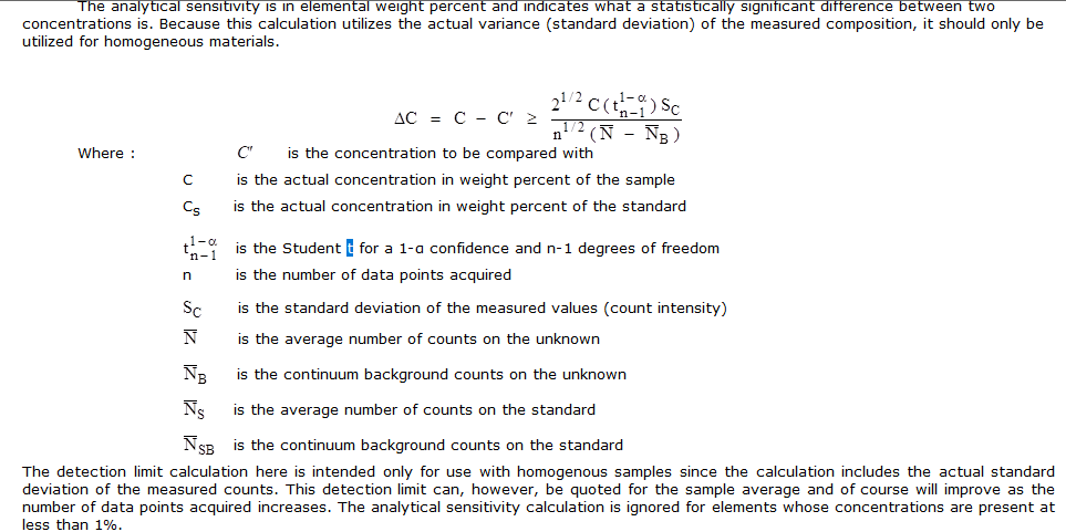

I'm not an expert in t-test statistics, but if someone asked me if two compositions were statistically different I would just apply the analytical sensitivity t-test which is calculated by clicking the Calculate Detection Limits and Sensitivity option in the Calculation Option dialog from the Analyze! window in Probe for EPMA. One can also export these values from a number of output/export formats in PFE.

The analytical sensitivity t-test calculation is documented in the PFE User's Reference manual/help file:
So, if the average of one population is different from another population's average by an amount that exceeds the t-test analytical sensitivity, then I would say the populations are distinct, for that t-test statistics confidence, for that element at least.  Each element will be different of course.
