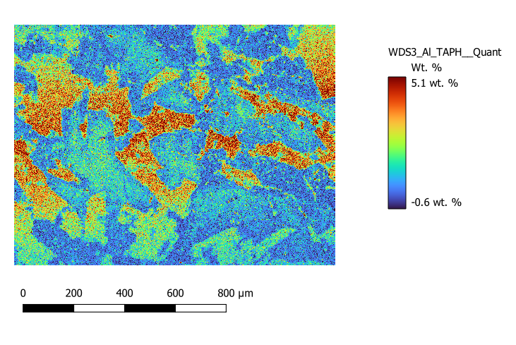

On print layout can have map image, scale bar and color bar. Which with a little tweaking get what you want
Map size function of scale attribute, and can position content by selecting move content
Scale bar can choice map units, and change to display as microns by changing scale factor and label
Colorbar can resize by unselecting link, clicking on color ramp and then format as like as here https://www.youtube.com/watch?v=cHhn1g5B6Do
An example here

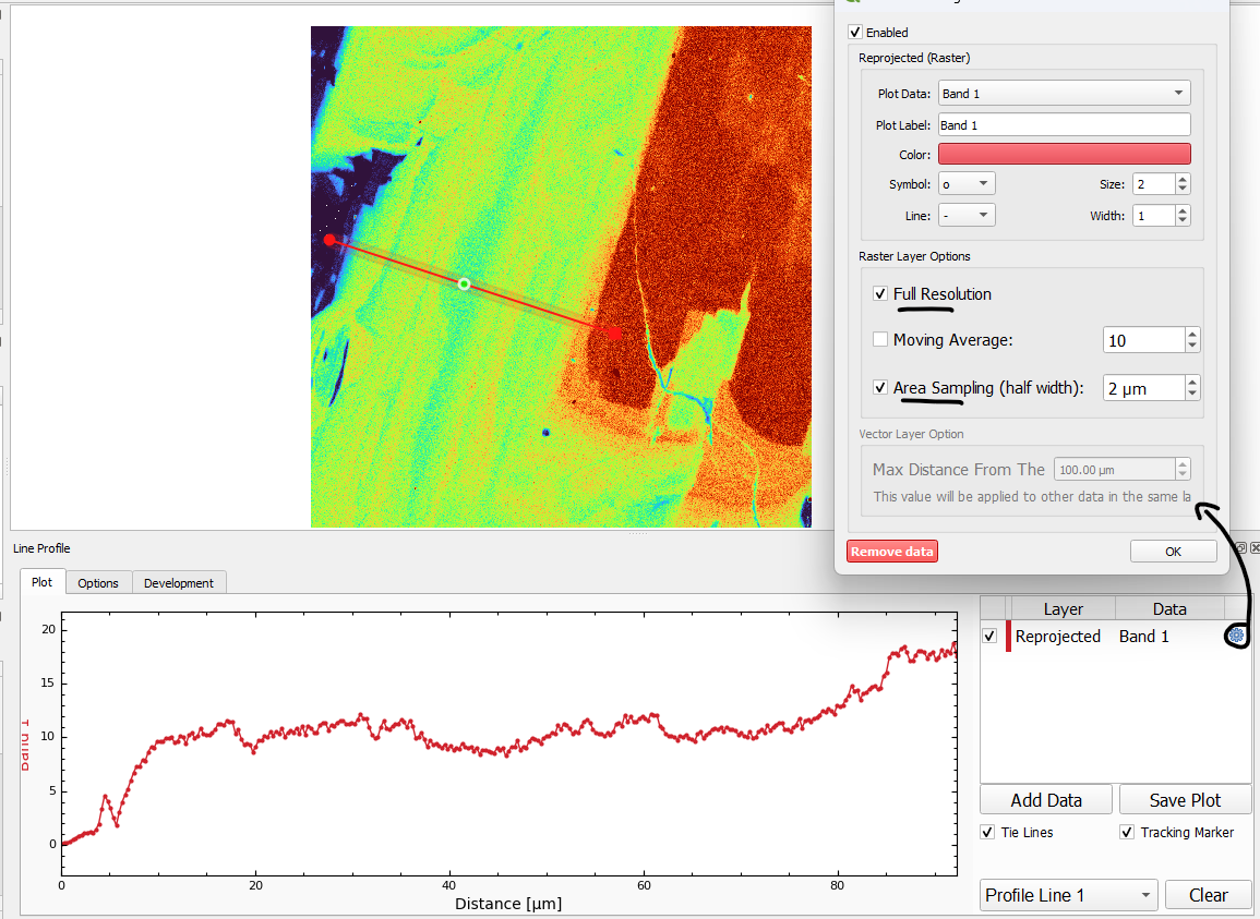

Or using wiscsims line profile plugin which allows wide lines averaging data 90 to line
Unfortunately it expects data to be in microns and wide lines averaging doesn't accept decimals
It would be nice if wiscsims made an adapted version for calcimage grd files expecting values in millimeters
As currently can transform grd from mm to um by using by transformjng from crs m to crs mm
https://github.com/wiscsims
Here's a screenshot of the wiscsims line profile plugin, having first converted the grid using raster>projections>warp menu and setting the source crs to m and the target crs to mm (to convert from mm to um)
The line width is displayed on map by checking the box in development tab
