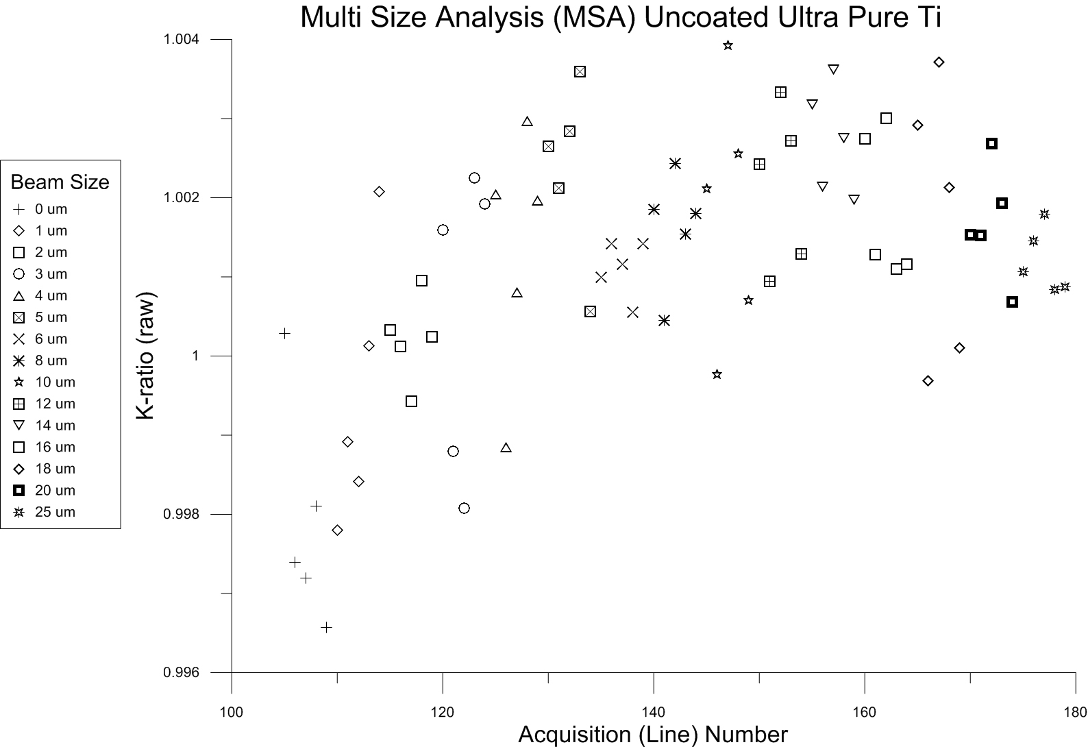

First is a plot of uncoated pure Ti metal at a variety of beam sizes:

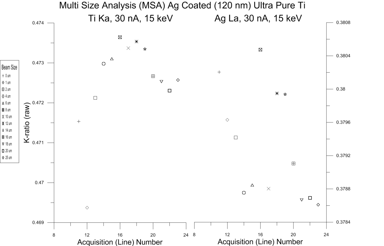

Next a plot of Ti coated with 120 nm of Ag (I do realize that I need to do another measurement of Ag La too!):
Finally a plot of carbon coated TiO2:
We would expect (hope) that beam size does not affect the analysis, and to a reasonable precision that seems to be the case.  More measurements would be needed to decide if any of these trends are significant and/or interesting...
Unfortunately I was in a bit of a rush last night and only digitized a single point for each beam size, so I'm re-doing the measurements tonight with more points... but the results for the Ag (coating material) La x-ray line, seem to indicate that all is well by assuming that beam size does *not* matter for conductive bulk and thin films and substrates to around 0.2% precision levels:

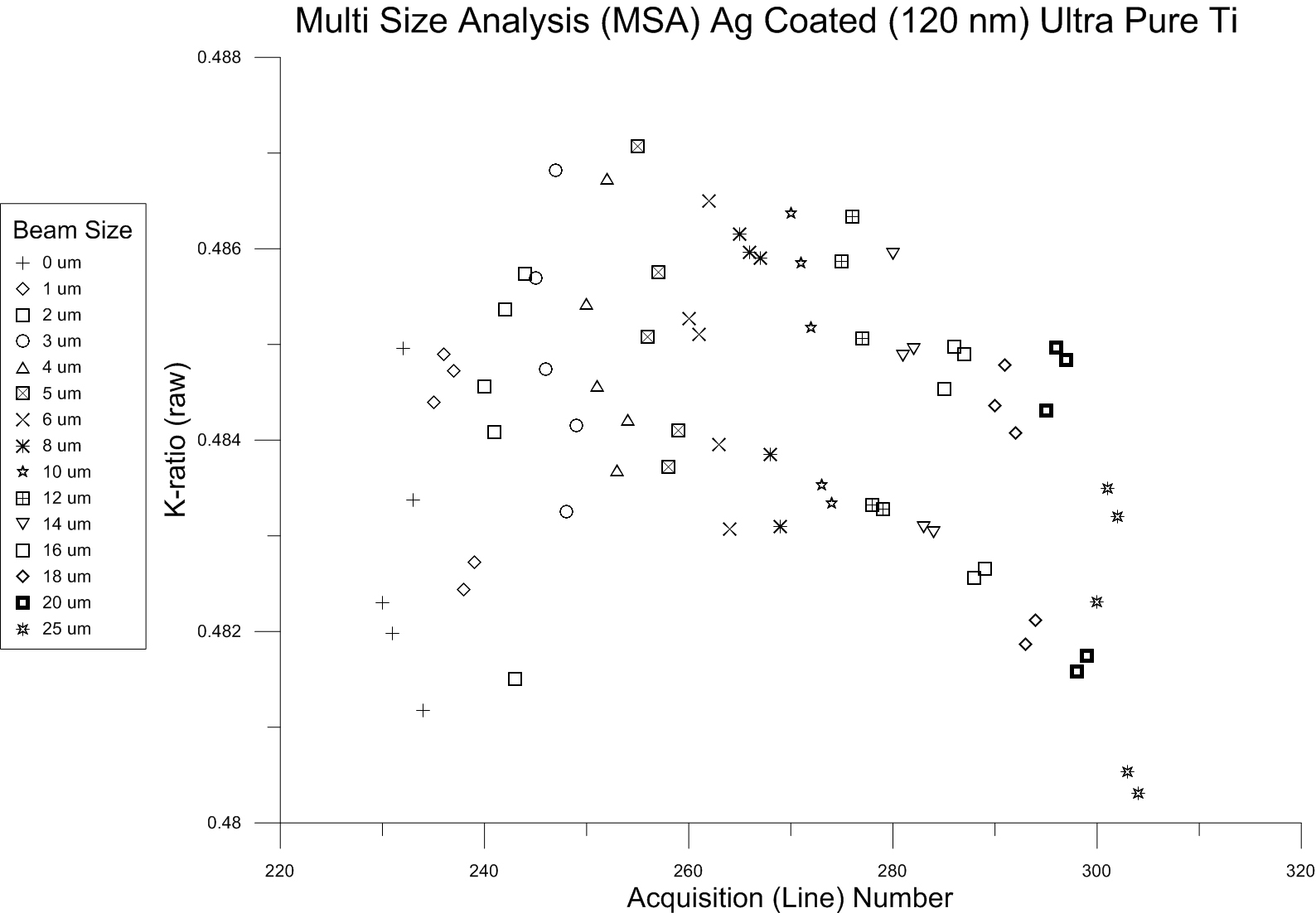

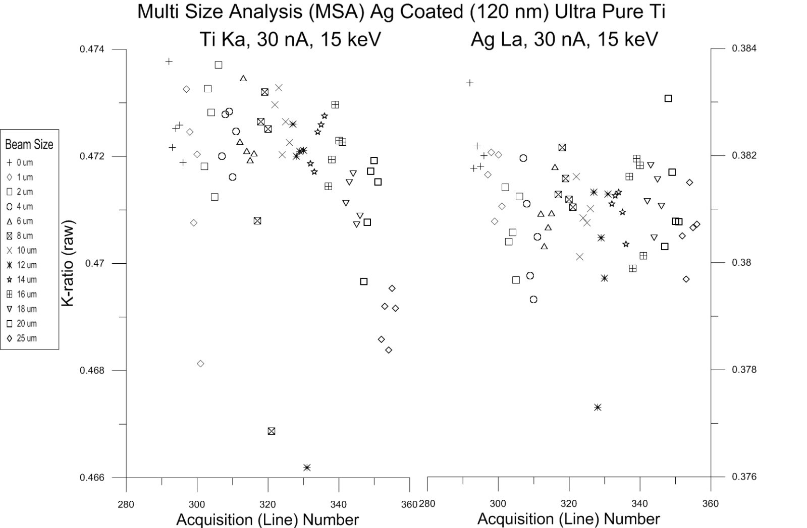

Ok, I re-ran the 120 nm Ag on Ti with 5 points each at beam sizes ranging from 0 (focussed) to 25 um and here are the results for Ti ka and Ag La:
So it would appear that beam size does not affect intensity in conductive materials, although there may be a slight drop off in intensity at the largest beam sizes (20 to 25 um) for Ti ka due to Bragg defocussing. I hope to have results for Mg Ka in MgO and Al Ka in Al2O3 tomorrow...

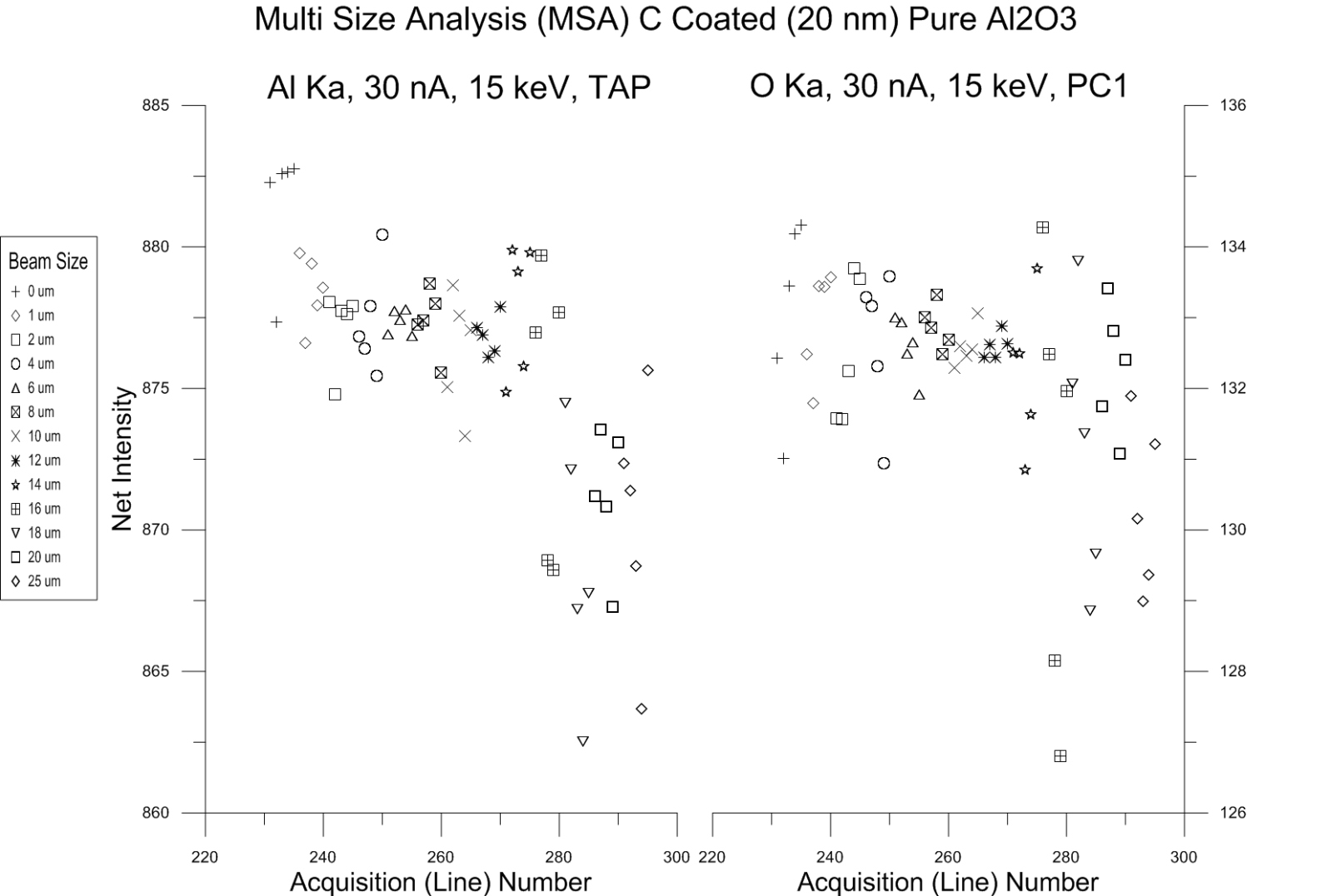

Using a Cameca SX50, the O Ka was measured on a PC1 crystal, the Al Ka and Mg Ka on a TAP crystal and the keV was 15 and beam current 30 nA. All materials were carbon coated with 20 nm of carbon and each measurement was performed on a clean area.

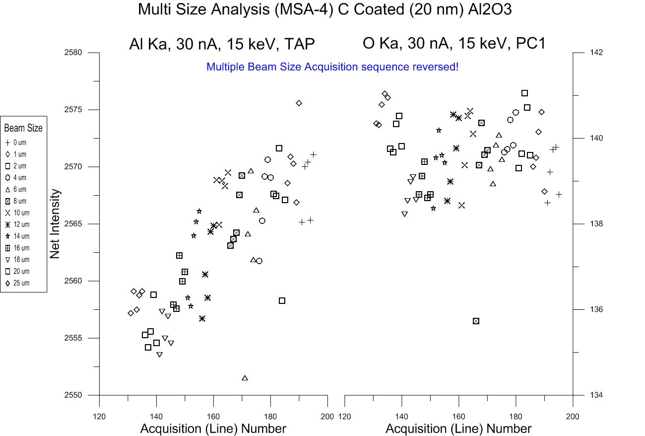

The results for synthetic Al2O3 are here:
As you can see except for a small intensity drop for Al Ka and O ka at the largest beam sizes of 20 and 25 um, the intensities seem stable over the range of beam sizes. This is not unexpected due to Bragg defocusing effects.

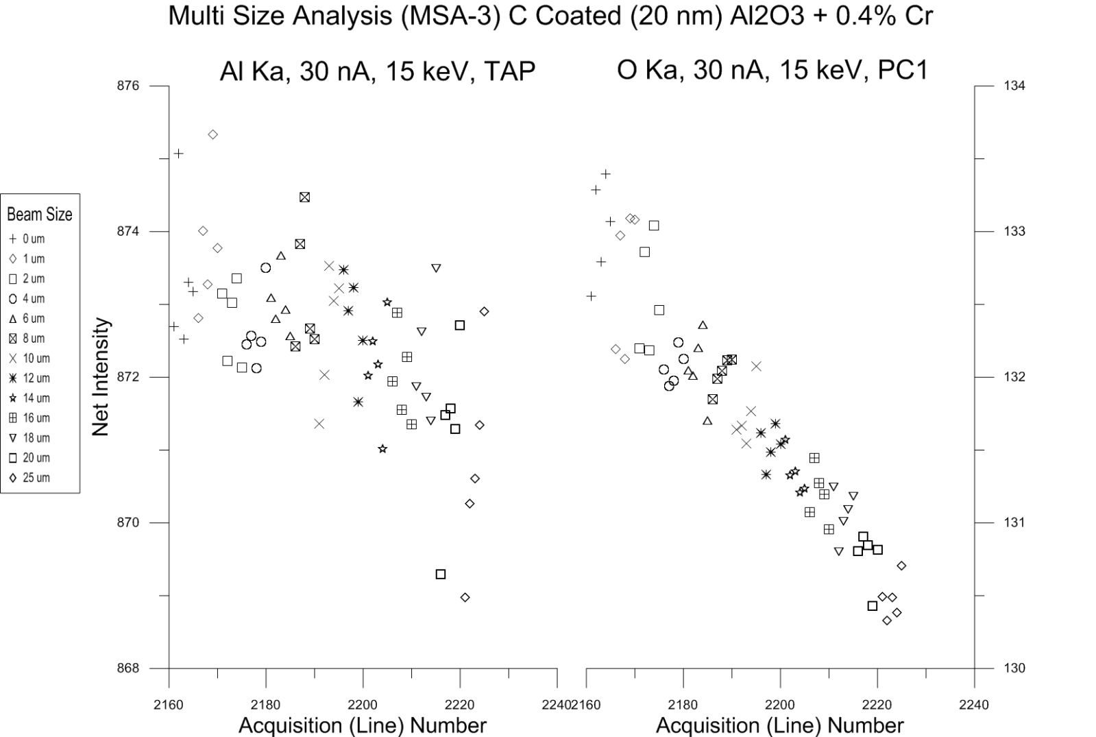

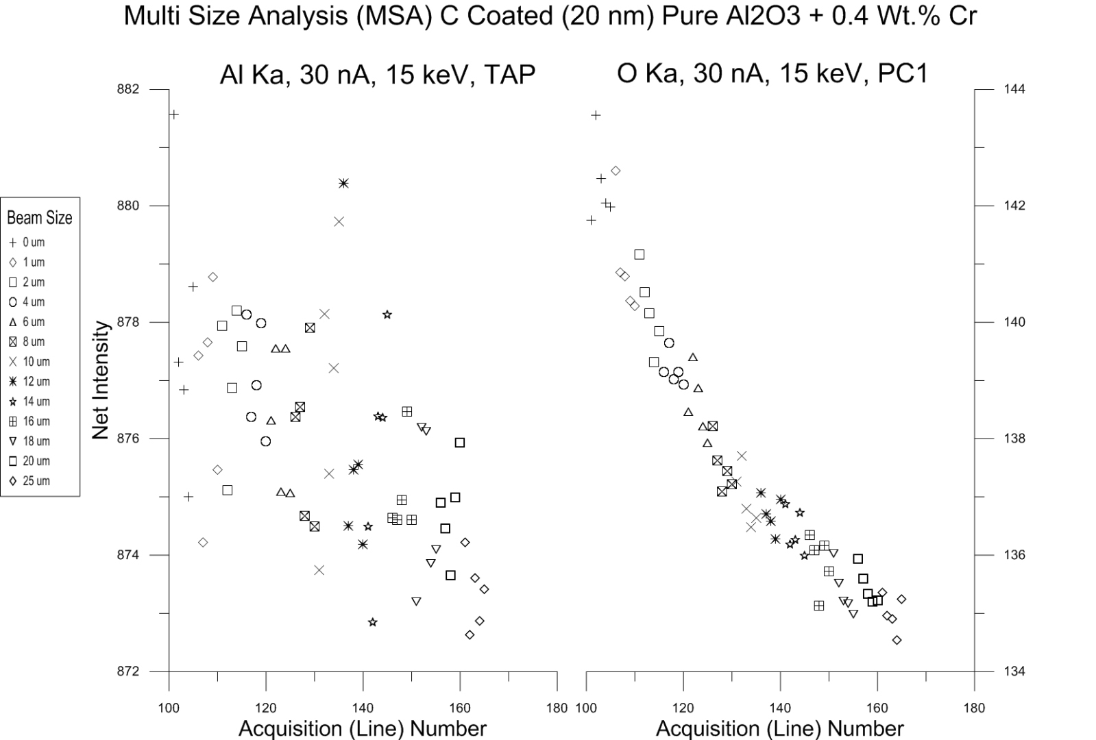

So are we done? Well I thought so until I saw the next plot of synthetic "ruby" (Al2O3 with 0.4% Cr):
What the heck is going on with the O Ka intensities in "ruby"?
A couple of things to note: first the Al Ka intensity in "ruby" seems consistent, but the O Ka intensity starts at the smallest beam sizes with a significantly higher intensity than pure Al2O3, but by the time the beam is defocused to 20 or 25 um, the intensity is back to that we obtained from pure Al2O3.
I also note that the Cr Ln lines is close to the oxygen line, but why would that make the intensity higher at smaller beam sizes? I am running some wavescans at different beam energies now to look at the peak shapes.
Oh, and the MgO plot? That is attached below. It shows a similar effect for oxygen as the Al2O3 with Cr (but not for Mg Ka!), and yes, the Mg Ka II order in close to O Ka but not that close...  so what is going on?
So I ran wavescans at 8, 16 and 22 keV on Al2O3 and Al2O3 + 0.4% Cr, but I'll be darned if I can see any difference that would cause the intensity to change as beam size is increased on Al2O3 + Cr but not on Al2O3!
I also double checked and my beam center was moving only a few microns when changing the beam size from 0 to 25 um.

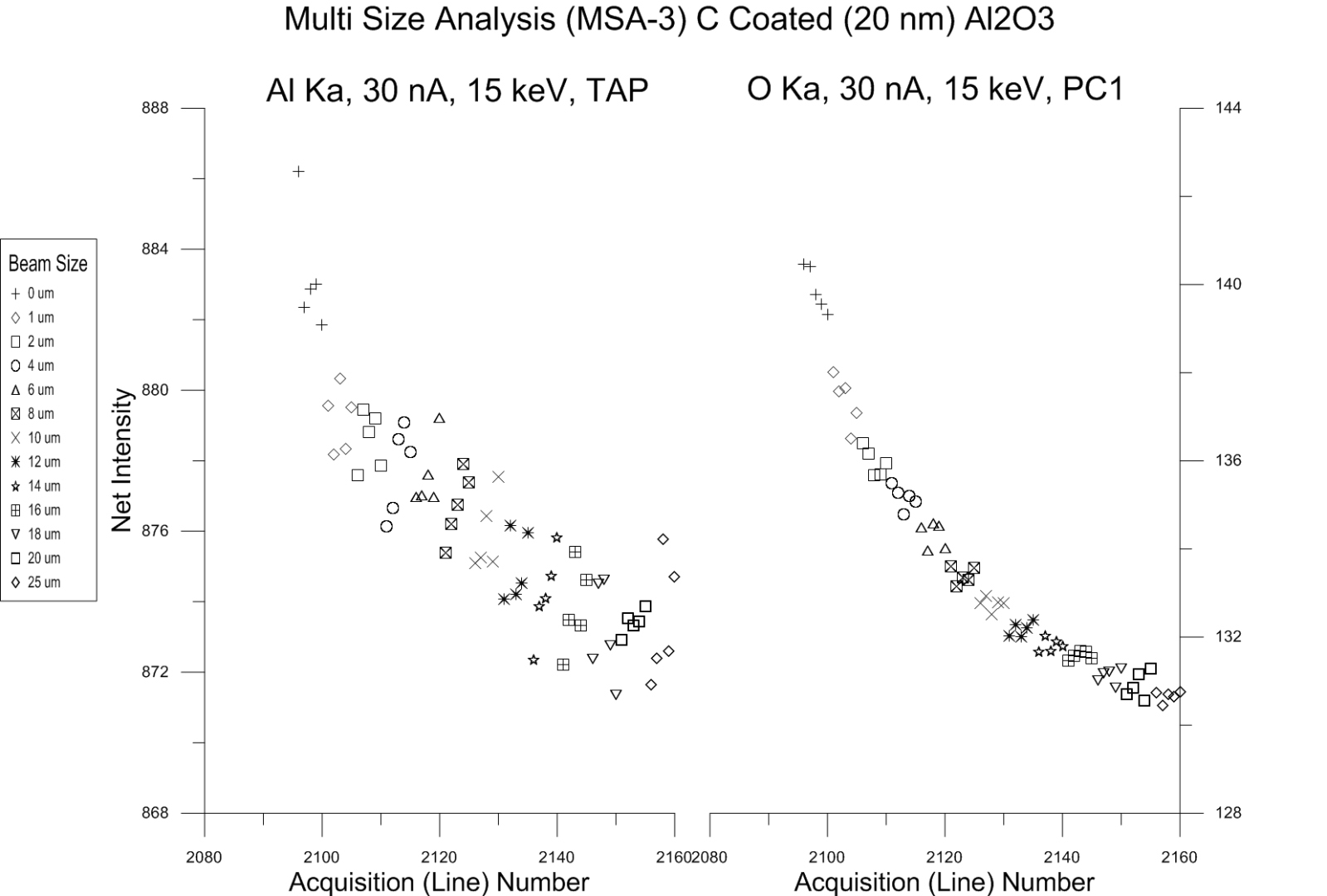

Zack Gainsforth thinks this might be related to channeling effects and I think he may be right. Here is some more data which may indicate that grain orientation, not composition, is a contributing factor. Look at these graphs and then consider that the Al2O3 + 0.4% Cr is a single crystal, but the pure Al2O3 is a polycrystalline material:
Here is pure Al2O3 (on a different grain than above):
Here is Al2O3 plus 0.4% Cr (same single crystal):

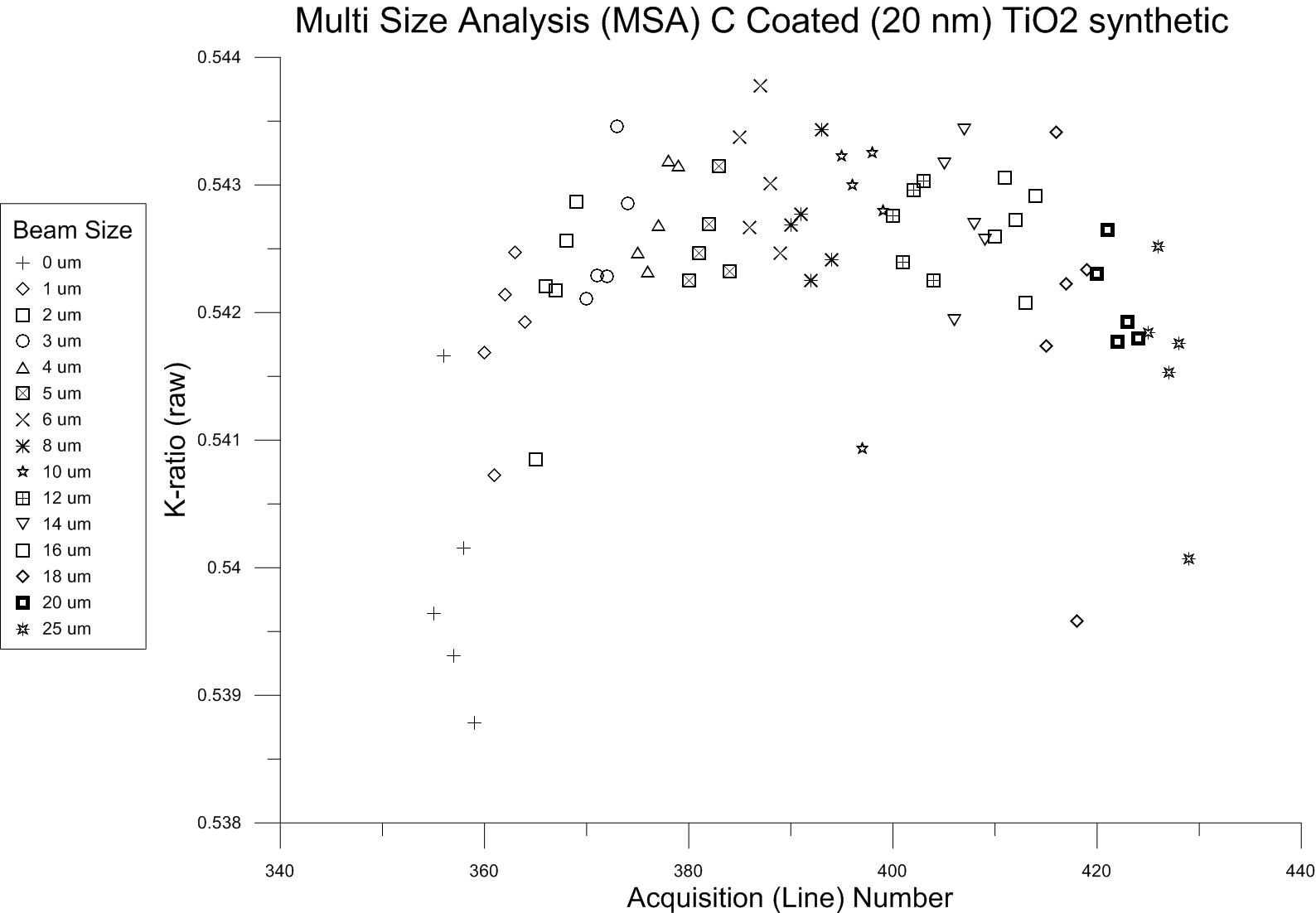

Let's start with the multiple size analysis (MSA) on Al2O3 on the SX50:
and here run on the Sx100, but with the acquisition order reversed so the large beam sizes get run first:

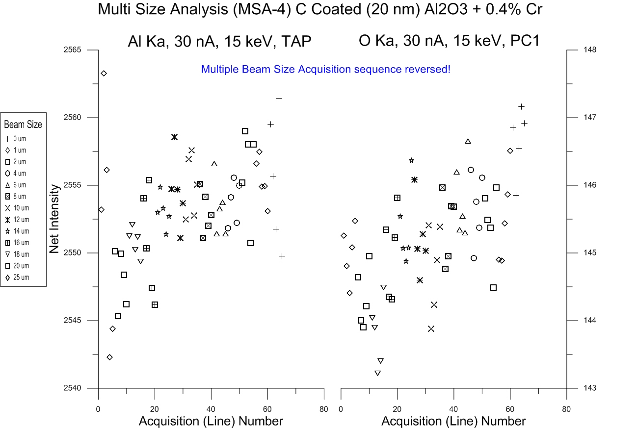

Now the Al2O3 _ 0.4% Cr on the SX50:
and the same on the Sx100 again in reverse acquisition order:

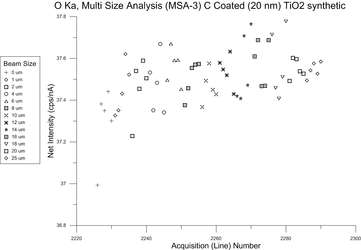

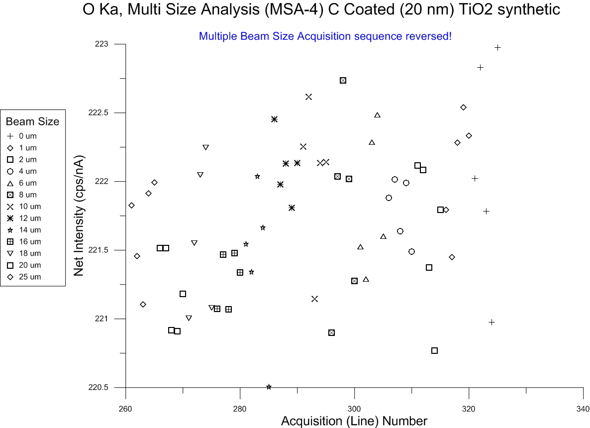

and now TiO2 on the Sx50:
and again, TiO2 on the Sx100, again in reverse acquisition order:
