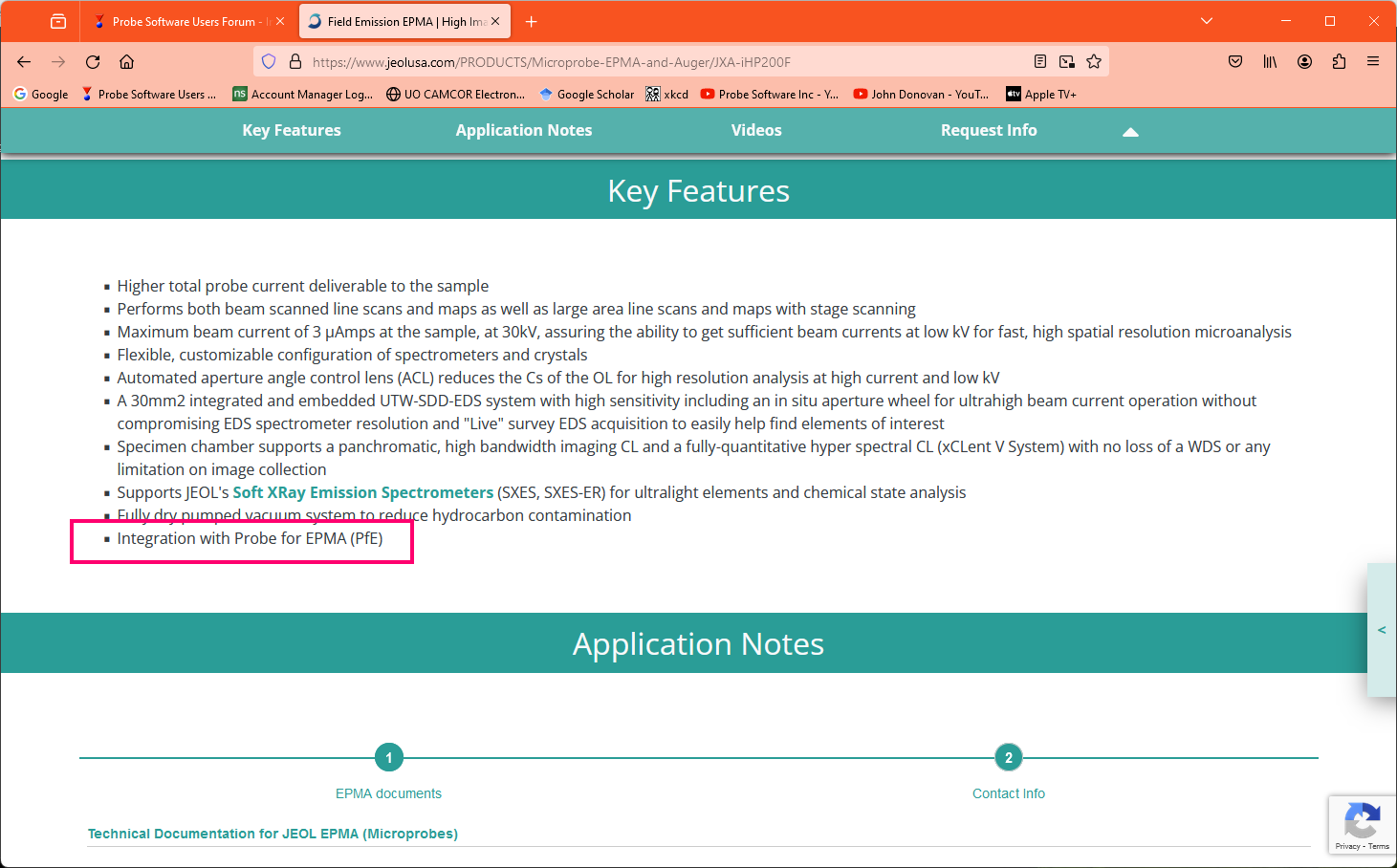

Someone just pointed out to me this item on the JEOL iHP200F web page:
