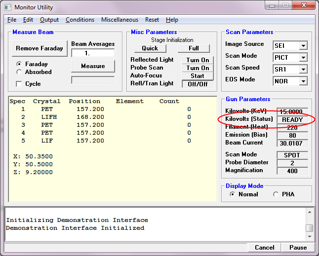

By the way, one can read the gun status using the Monitor.exe utility as seen here:
Try and see see what state the gun is in first.
