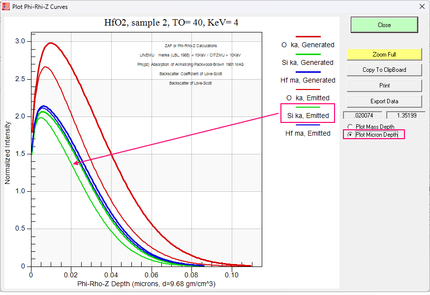

A better effort might be to utilize pr(z) curves such as those calculated using CalcZAF as described here:
https://smf.probesoftware.com/index.php?topic=1070.0
Using this method, at 4 keV we obtain the following curves for HfO2 with a trace of Si:
Note that the curves are all normalized to the surface intensity, but one can see that the emitted Si Ka signal starts to drop around 200 nm.
