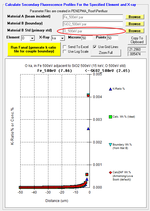

Yes, one can model oxygen emission in the Calculate Penepma 2012 Fluorescence Couple Profiles, but you'll need to lower the Penepma minimum electron energy keyword in the Probewin.ini file as seen here:
In the [software] section change
PenepmaMinimumElectronEnergy="1.0"
to
PenepmaMinimumElectronEnergy="0.5"
This will change the minimum electron energy from 1 keV to 0.5 keV allowing oxygen x-rays to be modeled. For example, this is Fe metal adjacent to SiO2:

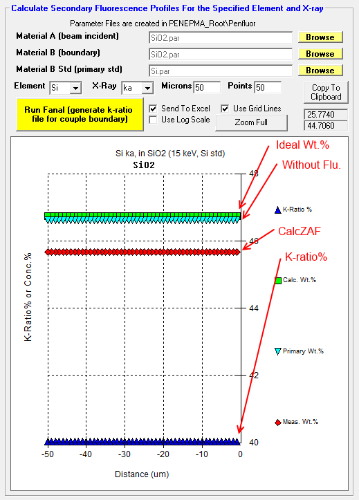

Just for fun though, let's see what happens when we try a matrix model at these low energies. Let's model SiO2 for Si Ka and O Ka and compare them to a CalcZAF analytical model.
Using SiO2 for both our beam incident and boundary material (and Si as our primary standard to back out the matrix correction), we obtain this for Si Ka:

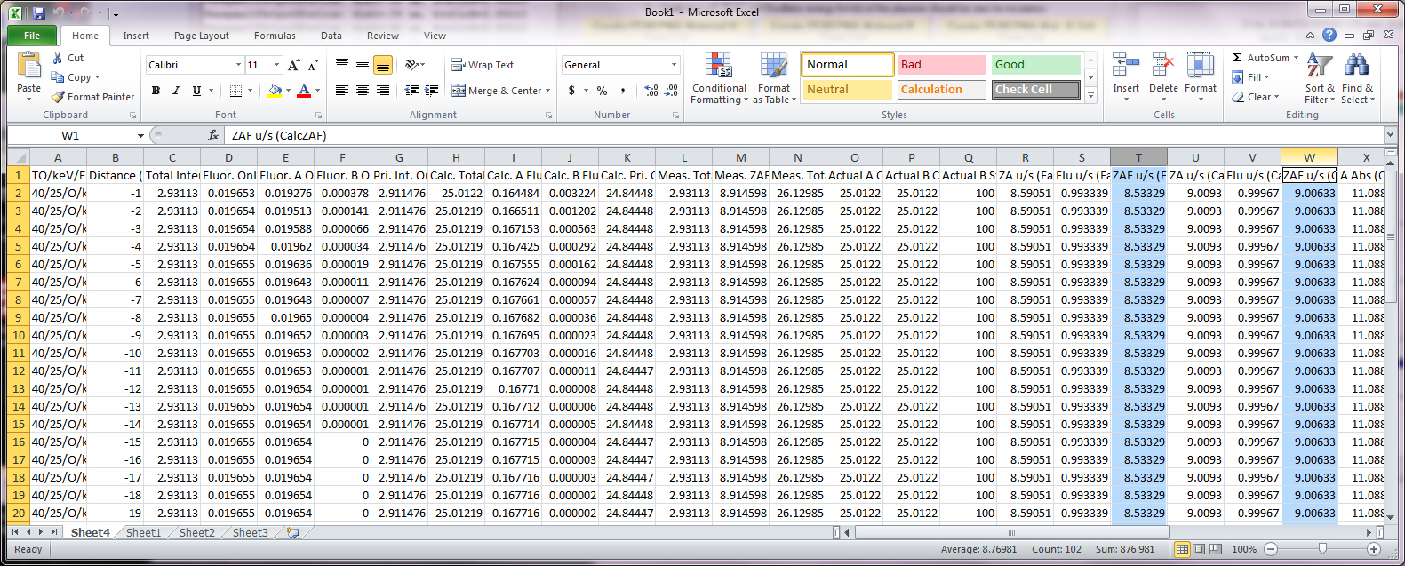

If we turn on the Send to Excel option we get this (among a whole lot of other numbers!):
So the two calculations are pretty close. What happens if we run the calculation with oxygen Ka? Basically the "wheels come off" at that point for the matrix correction.  Why?

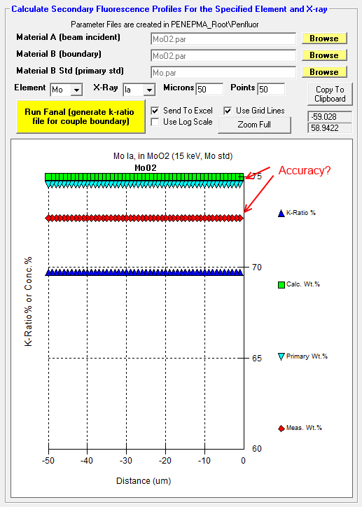

We'll start with Mo La since that should be no problem, and again...
We see another small discrepancy between the MC model (Calc. Wt%) and one of the CalcZAF (JTA-Reed) analytical expressions (Meas. Wt%) for Mo La in MoO2.

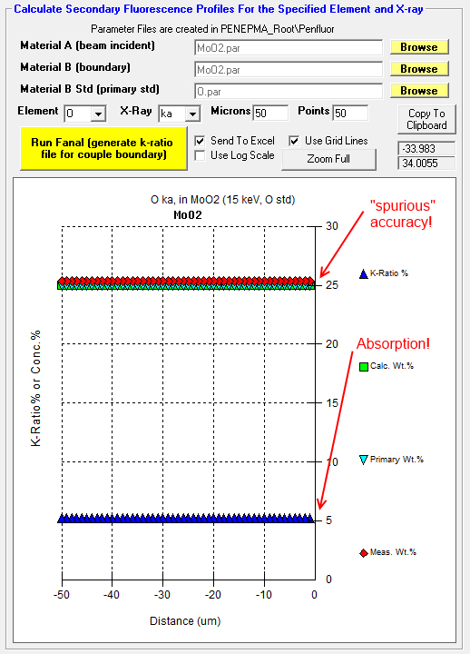

Let's try oxygen Ka in MoO2:
Whoa, that is pretty good. In fact I'd say it's "spurious accuracy" meaning too good to be true considering that it's over 400% matrix correction!

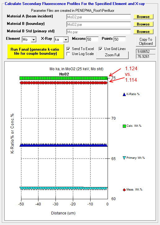

Just for fun, here's Mo Ka at 25 keV:

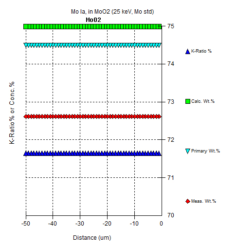

and Mo La at 25 keV:
Roughly the same difference as at 15 keV- it could be either that the Reed fluorescence correction in CalcZAF isn't quite good enough or that the fluorescence correction in Fanal is an analytical expression rather than Monte-Carlo and also not as accurate as in the full blown Penepma.

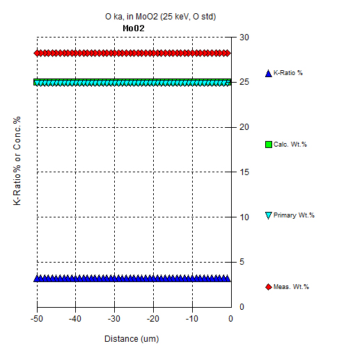

What about oxygen at 25 keV?
Ok, so now we see that nasty absorption correction starting to kick in. Matrix correction here was 7.75 for Fanal and 9.0 for CalcZAF, but who is to say who is right?
For comparison I calculated O Ka in MoO2 using CalcZAF PAP and get 7.48 for the oxygen matrix correction at 25 keV, so maybe Penepma is doing great for absorption!
Edit by John: see below for an improved calculation of oxygen in MoO2 at 25 keV.

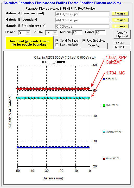

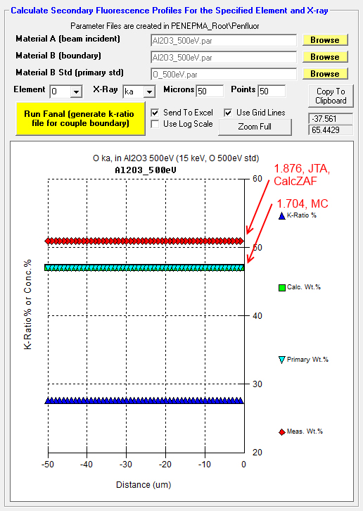

As promised I ran some Penepma/Penfluor Monte-Carlo simulations overnight, using the PenepmaMinimumElectronEnergy keyword in the probewin.ini file set to 0.5 keV as described above in order to model oxygen emissions, and here are the results for Al2O3 matrix corrections for Al Ka and O Ka:

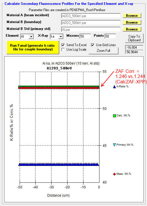

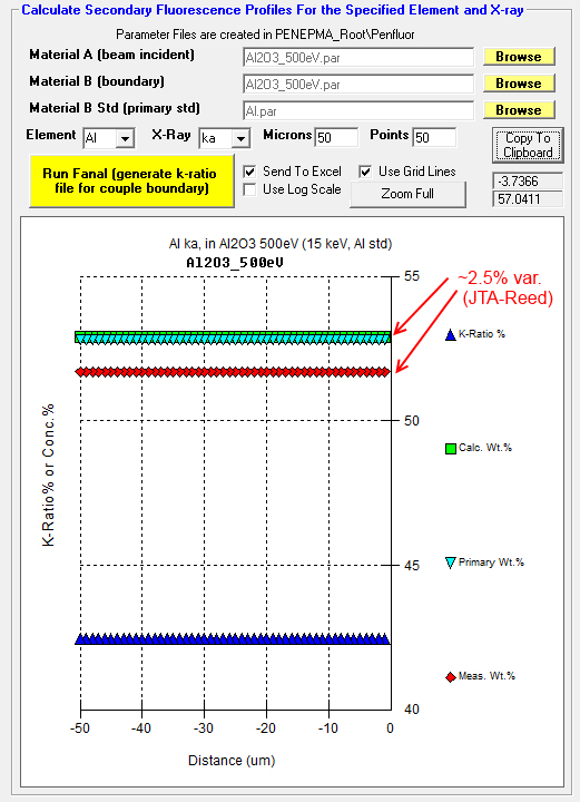

First Al Ka at 15 keV using the CalcZAF JTA-Reed analytical matrix correction (Meas. Wt%):
Now the same but using the CalcZAF XPP-Reed analytical matrix correction:
XPP definitely agrees better with the Penepma MC!
Now for O Ka, again first with JTA-Reed CalcZAF for the "Meas. Wt%":
Reasonable agreement for a 500 eV emission line (though remember we are *not* considering any chemical bonding effects with either model) and you will have difficulty seeing the difference for CalcZAF XPP seen here:
What we are probably seeing here are the limits to our knowledge of the photo-elastic absorption physics (scattering factors for Penepma and MACs for CalcZAF).
However, just for fun I loaded in an empirical Mass Absorption Coefficient (MAC) value from Bastin (1992) for O Ka in Al (6720) into CalcZAF (see Analytical | Empirical MACs menu) and the ZAF correction factor changed from 1.876 to 1.875, so maybe not!

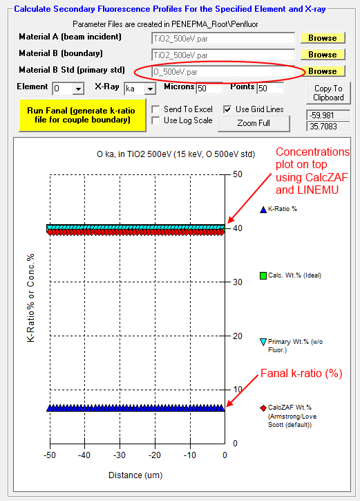

Should we try O Ka in TiO2?   :o
Let's do this!

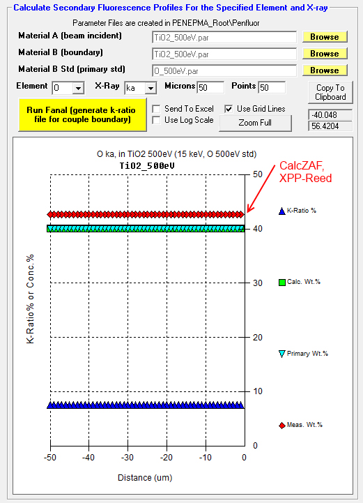

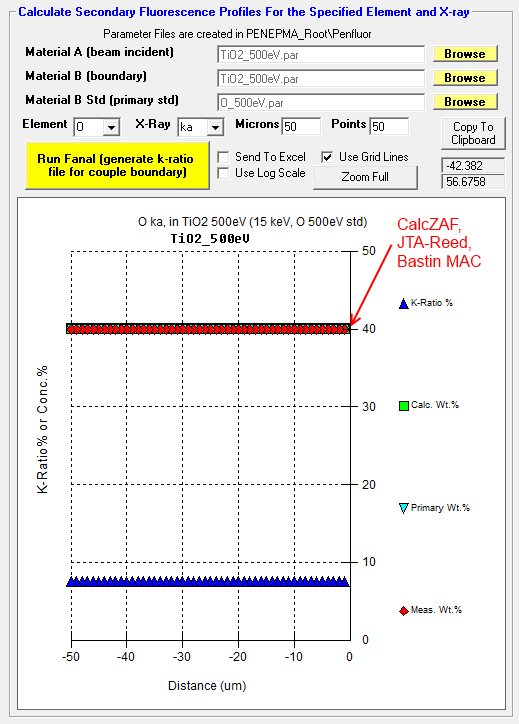

I'm going to try both the JTA and XPP analytical models in CalcZAF for O Ka in TiO2 and also apply Bastin's empirical MAC for O Ka in Ti which is 19900. Let's see how these compare to Penepma/Penfluor Monte-Carlo models.
Here is O Ka in TiO2 using CalcZAF's JTA analytical model (and Reed fluorescence):
Here is the same but using CalcZAF's XPP analytical model (and Reed fluorescence):
Now let's apply an empirically determined MAC from Bastin (1992):
Looks pretty good. Now let's try the same empirical MAC but with CalcZAF's JTA-Reed analytical model:
Not bad for an over 500% correction...    8)

So, here is the oxygen in TiO2 fanal extraction re-calculated down to 500 eV:

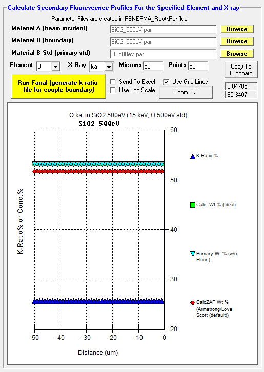

And here is oxygen Ka in SiO2 with the new Fanal extraction code:

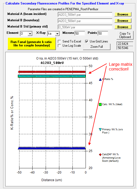

And here is oxygen in Al2O3:

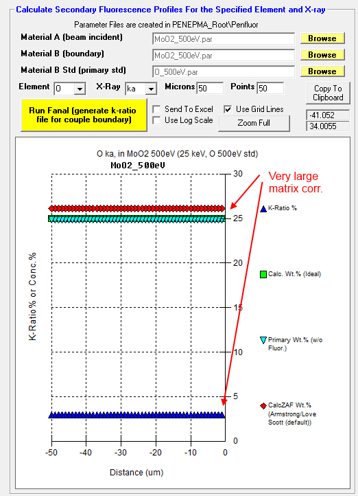

And here are the oxygen k-ratios in MoO2 at 25 keV, a rather large matrix correction around 800-900%!
and the Excel spreadsheet generated (note that the new Fanal couple extractions now incloude the takeoff angle in the folder name:
File attached below.
