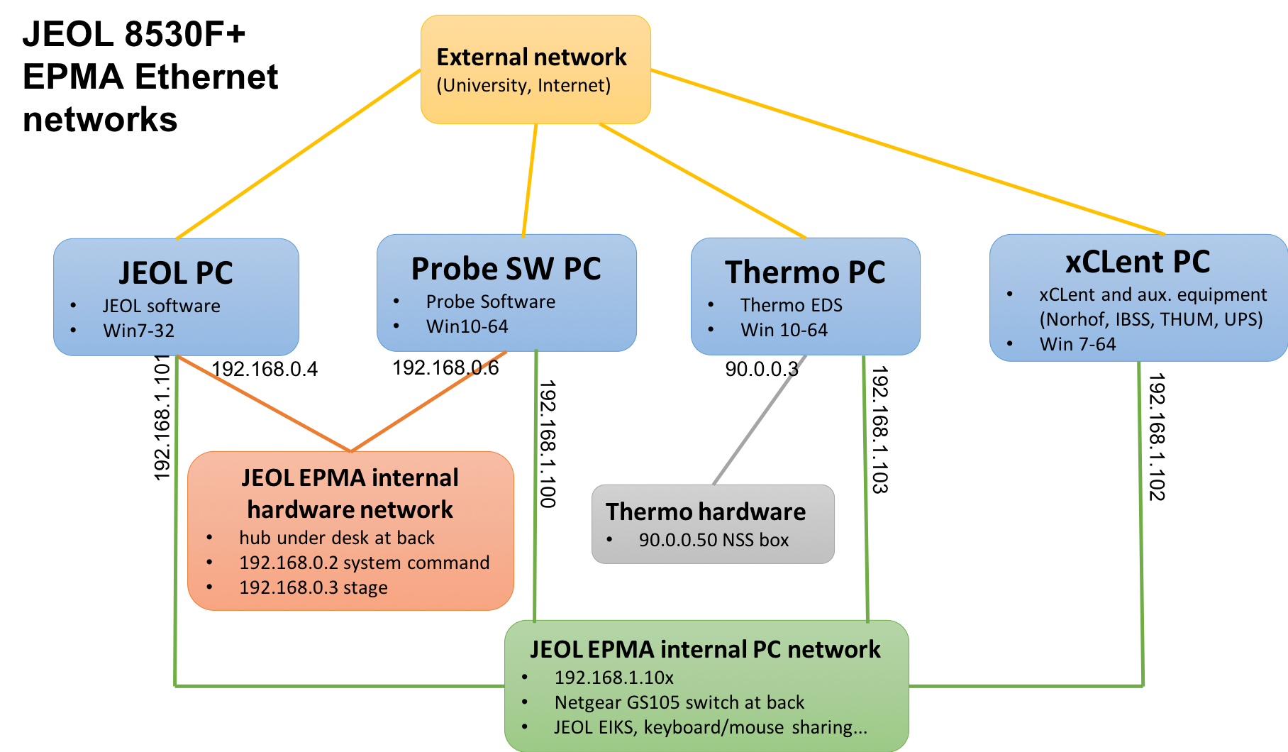

I've attached an image with the network setup of our 8530F Plus system. We have 4 PCs: 1 for JEOL software, 1 for Thermo Pathfinder EDS, 1 for JEOL xCLent CL, and 1 for Probe Software.
We used to only have 3 PCs, with Thermo and Probe Software sharing a PC, but we had some issues with Thermo on that PC (unrelated to the two sharing the PC) that were probably hardware related. The easiest was to build a new PC for Thermo from scratch and we just kept the existing PC as it was for Probe Software.
All PCs have at least 2 network ports, 1 for external communication (within the university and internet) and one for a dedicated internal network through a Netgear gigabit switch for file sharing, keyboard/mouse sharing, and JEOL EIKS "SEM" communication. The JEOL PC and Probe Software PC each have a third network port connected to the JEOL hub in the console under the desk for microprobe hardware communication. The Thermo PC has a third network port to communicate with the Thermo hardware.
The screen layout, KM sharing etc with photos are shown in this post here:
http://smf.probesoftware.com/index.php?topic=1057.msg6968#msg6968
