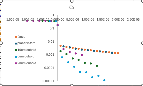

The other issue is where the interface is small - inclusions. Below is simulations for cuboids of varying sizes, together with planar interface from DTSA-II, and comparison to FANAL
Quote from: Ben Buse on April 29, 2025, 02:05:19 AMIs it now possible to model sloped planar interfaces in FANAL?
Unfortunately, not that I know of.  The sloped interfaces were all generated in PENEPMA, which of course is very time consuming.  I really do not not how to proceed from here as characterizing the actual angle of slope is not possible in an EPMA I suspect.
I should do another system with say a less energetic x-ray and see if the geometry alone dominates or also the x-ray physics.
Quote from: Ben Buse on April 29, 2025, 02:05:19 AMThe other issue is where the interface is small - inclusions. Below is simulations for cuboids of varying sizes, together with planar interface from DTSA-II, and comparison to FANAL
It's nice to see that DTSA2 and PENFLUOR/FANAL agree on a vertical plane geometry.
