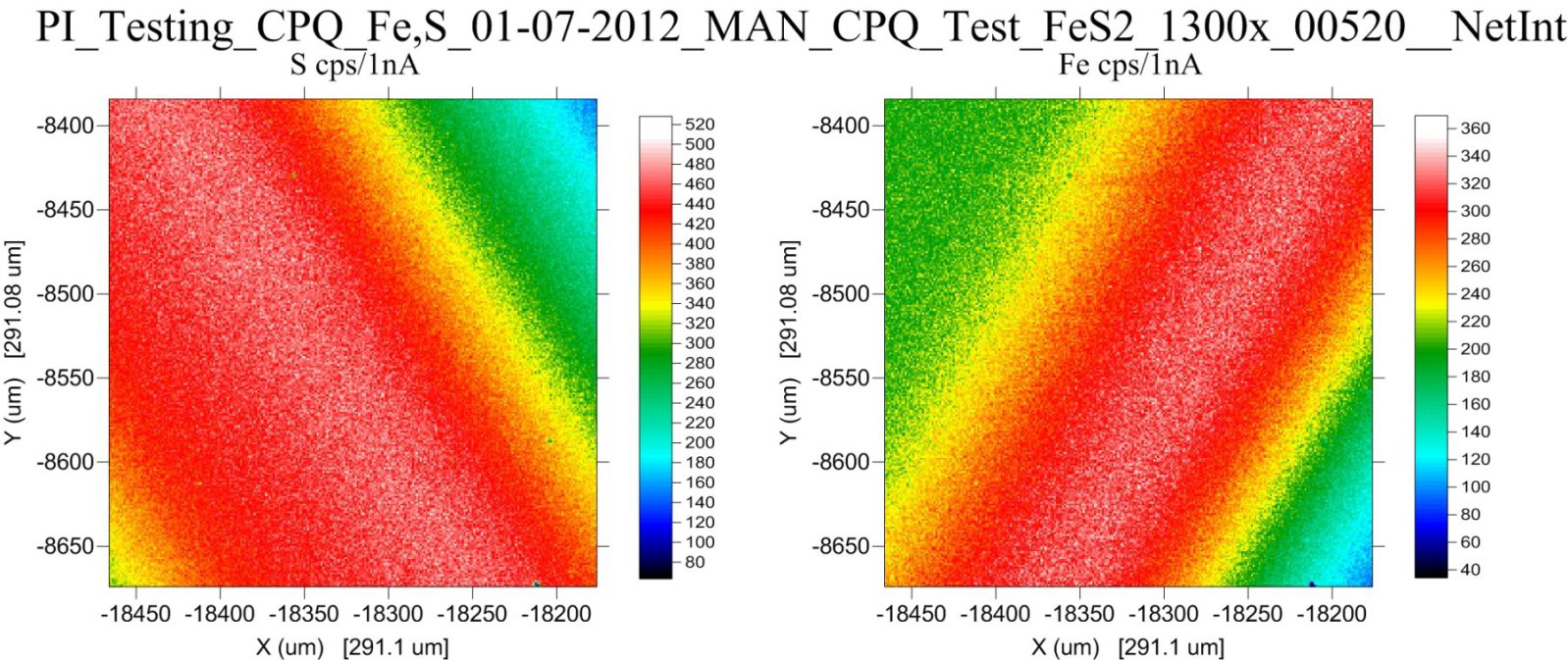

First we acquire a set of low mag beam scans on pyrite (FeS2) for Fe Ka and S Ka, as seen here in these plots of the net intensities (remember the continuum is generally fairly flat and so does not experience Bragg defocusing to the same degree as the characteristic peak).

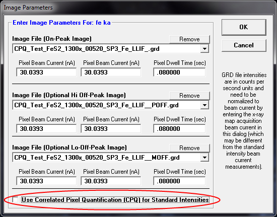

Clearly we have a severe Bragg defocusing problem. However, let's also acquire the same set of maps on our Fe standard (pure Fe) and S standard (also FeS2) and apply them as seen here in CalcImage by clicking on each element and checking the Use Correlated Pixel Quantification check box seen here:

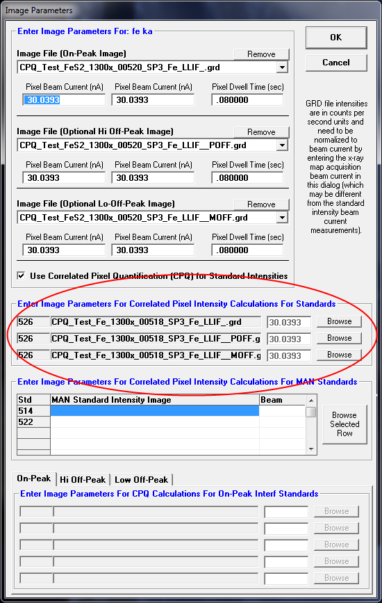

Then we simply load in our standard intensity maps (note that the off-peak intensity maps shown here aren't really necessary in practice as pointed out earlier) into the primary standard locations using the Browse buttons:
Note that one can also specify MAN standard maps and also interference standard intensity x-ray maps for the primary intensities if the analytical situation requires them.

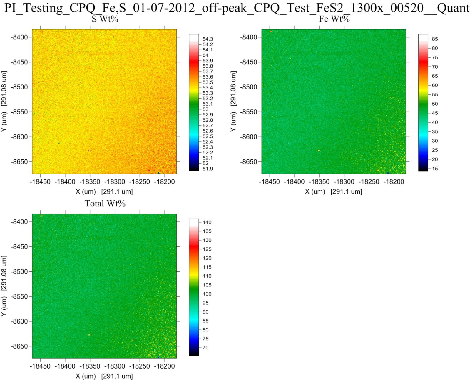

We then perform the same assignments for the S Ka standard x-ray maps and because we have captured the WDS Bragg defocusing effect on both our standard and unknown in the same manner, the k-ratio calculated from the correlated pixels from the unknown and standard x-ray maps nicely corrects for the Bragg defocusing to the level of precision with which the maps were acquired.
Note that at the most extreme Bragg defocusing in some "corners" of the maps, the precision is clearly reduced.

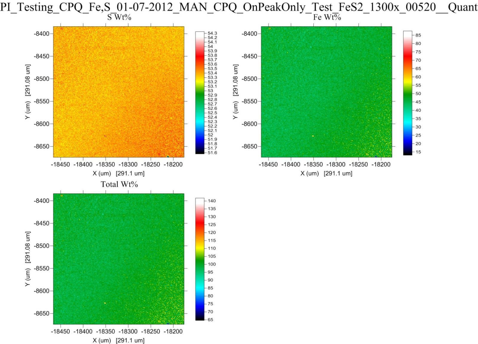

By the way, the same calculation can be performed using MAN backgrounds so that no off-peak maps need be acquired at all as seen here:
Can you tell them apart? It's not easy! Remember, Bragg defocusing mainly affects the characteristic peaks!

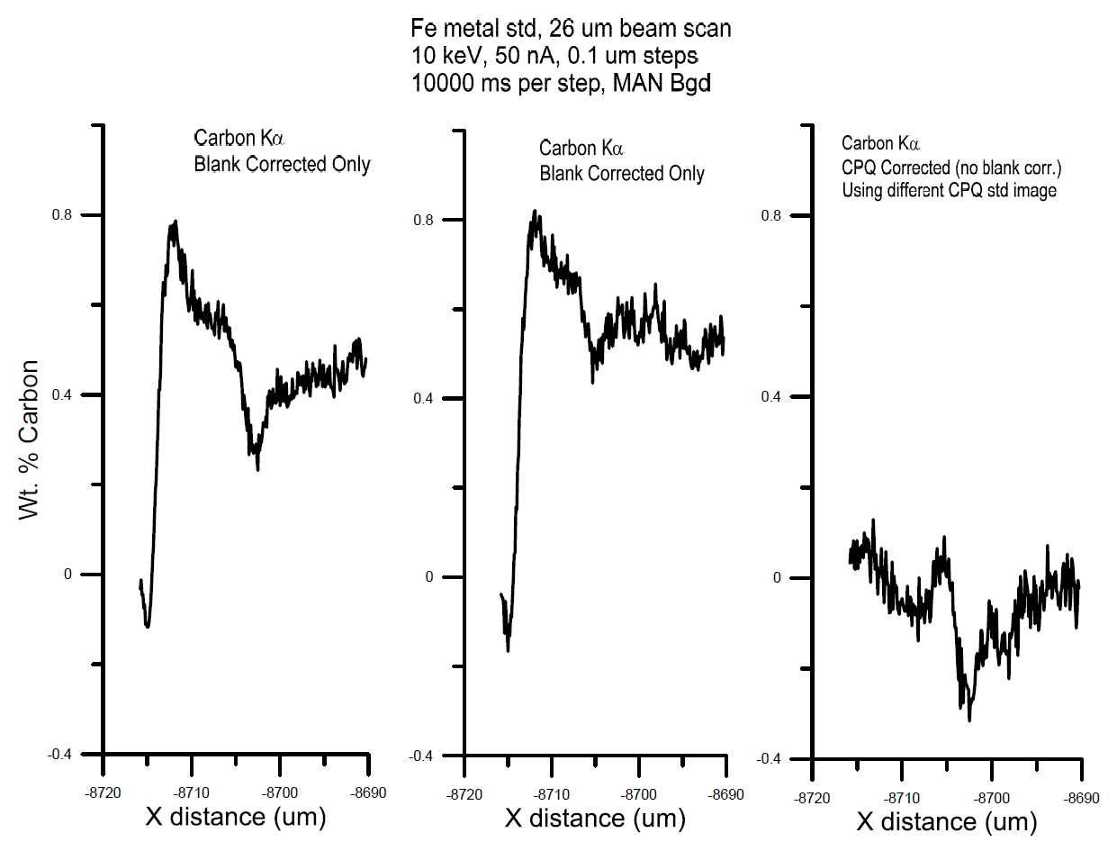

I'm adding a graph showing why the correlated pixel quantification method (CPQ) in CalcImage did not work as well as Philippe Pinard and I had hoped for, in dealing with carbon contamination effects.  Basically the carbon contamination rate is not reproducible enough in the instrument for high precision carbon analysis.
