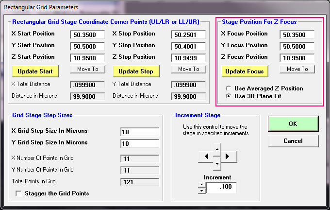

Hi Rick,
I think I implemented a Z focus in the digitize rectangular grid dialog along the lines you suggested.
With this new Z focus position one can select average Z or a 3D plane fit for the interpolated Z positions.
Please let me know if this works for you.
PS This method allows the user to perform a z focus at any stage position (other than the two corners), but I just realized that I should add code to update the x/y focus position, whenever the user updates one of the other corners.  Then one can simply use the Move To button to move to it and focus the stage.
Edit by John: OK, I added an automatic update of the 3rd corner position when either of the two diagonal corners are updated.  Download is available now.
