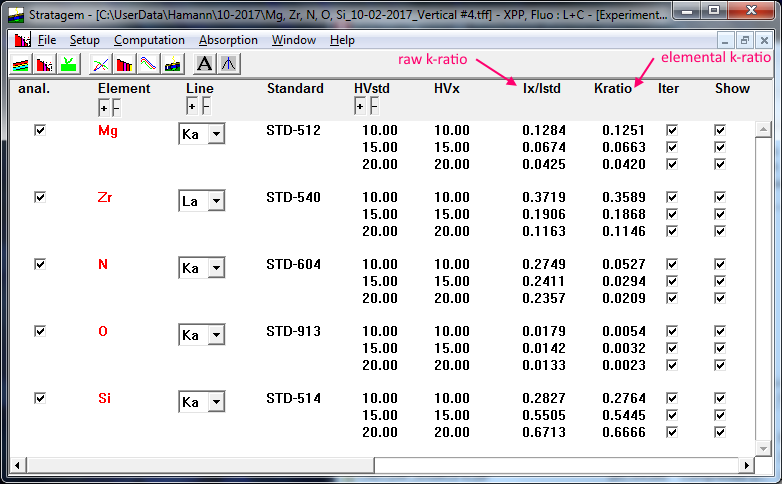

But first let's review a thin film sample using STRATAGem to see how good we should be able to do, and then we'll see how close CalcZAF gets without including substrate effects. First we load the raw k-ratios into STRATAGem (using a file exported from Probe for EPMA which includes the raw k-ratios, standard compositions and sample geometry) as seen here:
When we click the Iterate menu in STRATAGem the program calculates a model based on all the raw k-ratios at all the beam energies utilized as seen here:
The results are output here (the iteration windows shows a 99.8% un-normalized sum) for normalized concentrations and atom fractions:

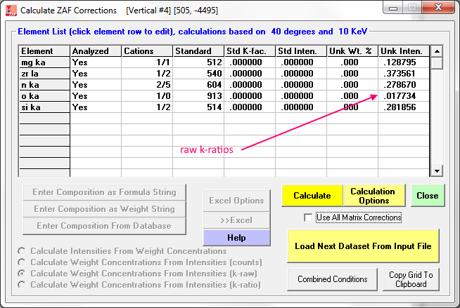

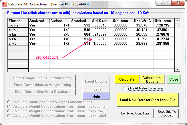

Now let's run CalcZAF and enter our raw k-ratios as seen here, starting with the 10 keV measurements (one could alternatively enter intensities for both the unknowns and standards):
First note that the Calculate Weight Concentrations From Intensities option is selected (though grayed out since an import file was utilized). If you enter raw k-ratios by hand you will want to be sure to select this option before clicking the Calculate button.
By the way, these raw k-ratios are also already corrected for spectral interferences when output by PFE (and of course corrected for background, deadtime, and standard intensity drift), and can be imported into CalcZAF using the CalcZAF input file format or by simply clicking an empty element row and typing the values in. If we now click the Calculate button in CalcZAF we get this result:

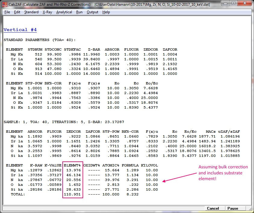

and in the log window this result:

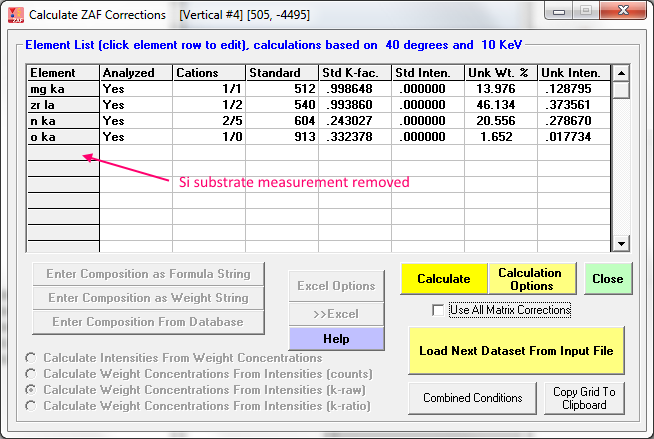

which is obviously incorrect since we've included the Si intensities from the substrate and also we're assuming a bulk geometry still. So first we delete the Si intensity as seen here:

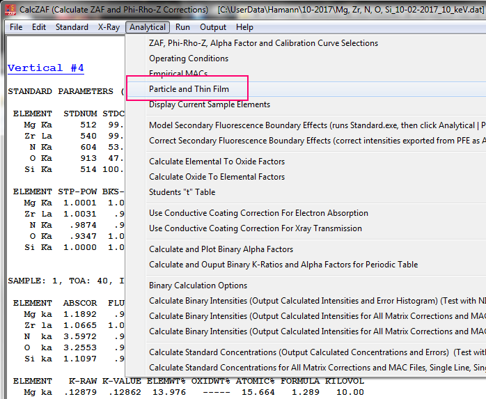

and then we specify our thin film geometry from this menu here in CalcZAF:
Once in the particle and thin film dialog we specify the following (we entered 5 for the density just to be consistent with STRATAGem):

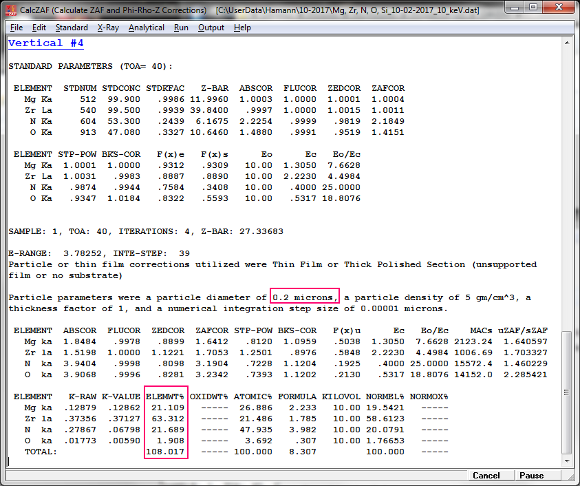

We entered .2 um (200 nm) just as a guess at the thin film thickness and this is what we get for the calculation now:
The total is a little high which means we are under estimating the thickness, but the composition is not looking too awful.  Changing the thickness to 0.23 um (230 nm), we obtain this calculation result:
Which looks pretty good, though it could be improved by increasing the thickness slightly, though we may also want to decrease the Numerical Integration Step by a factor of 10 or so for best accuracy.
