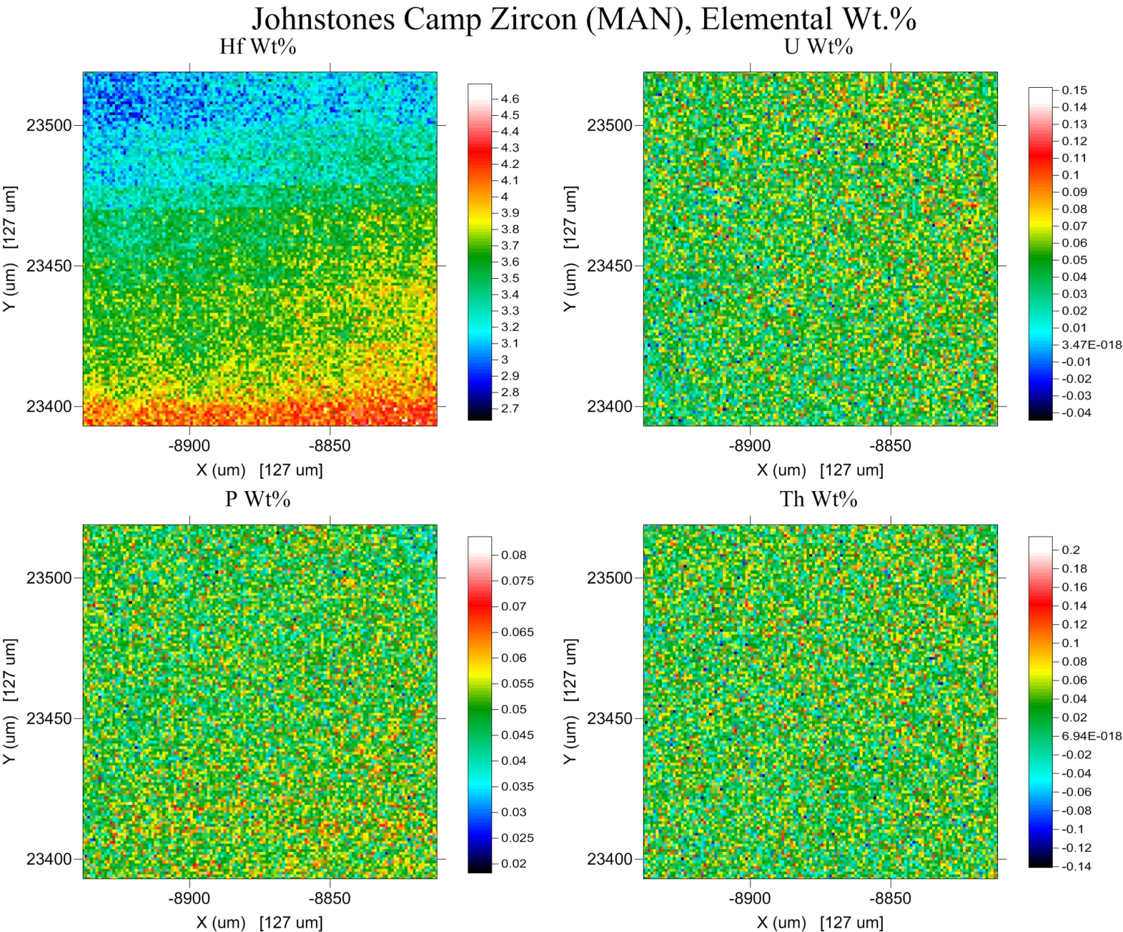

A nice example of how sensitive the MAN background correction is for quant mapping is seen here:

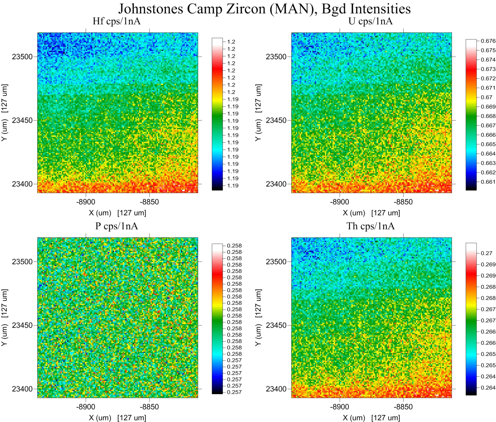

Note that because the Hf concentration in this zircon is changing slightly, the MAN calculated bgd intensities also vary (as they should), since the average Z is also changing.

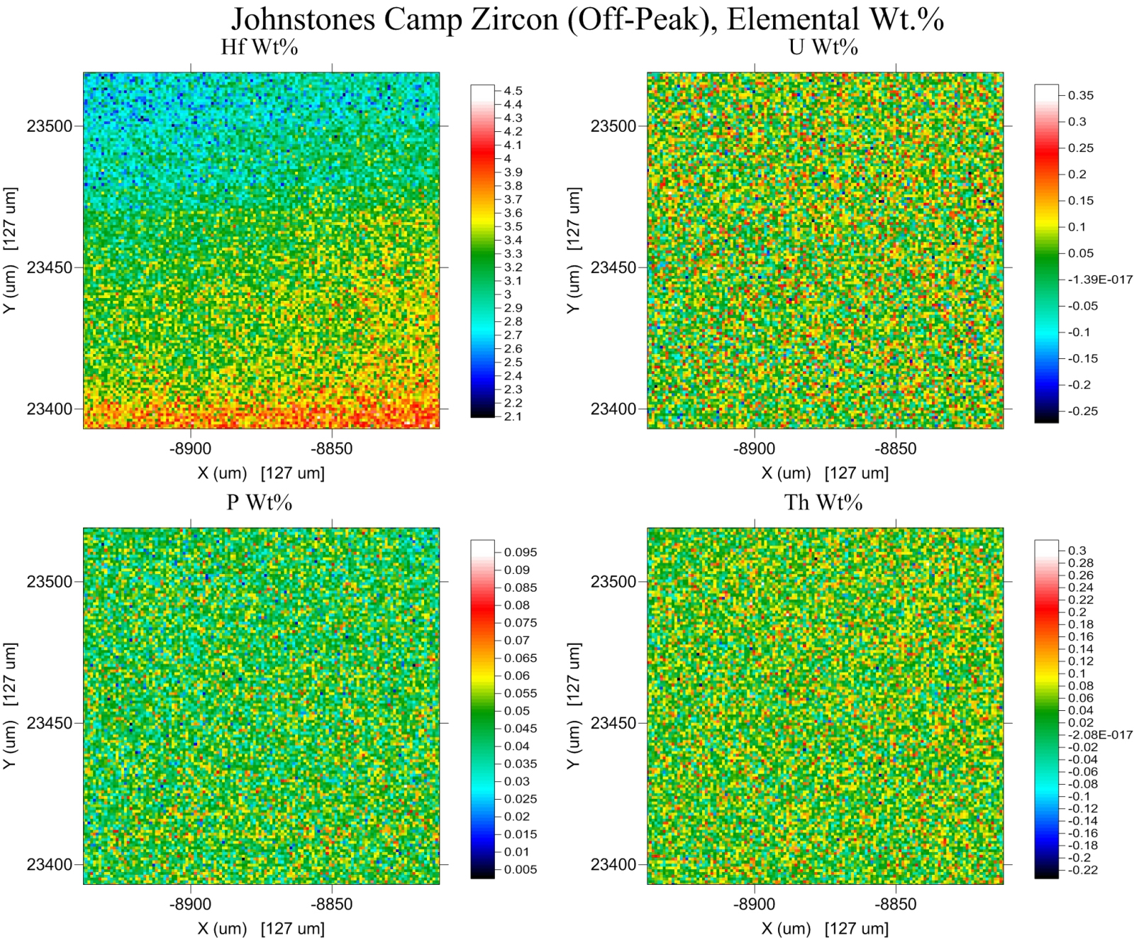

Unlike what one sees in the off-peak measured data where the precision in the off-peak intensities is not sufficient to detect the variation in the continuum:
In the above example, we can also compare the quant elemental concentrations and see that the off-peak data is significantly less sensitive which is visibly affecting accuracy:
Off-peak quant:

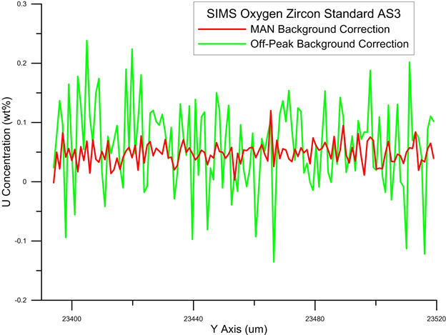

Here is a nice comparison between off-peak and MAN methods.
The two line profiles above were calculated using the *same* data set for both off-peak and MAN background methods for the U concentration maps shown in the above posts (note the maps are labeled Johnstones Camp zircon, but actually they are SIMS zircon oxygen standard AS3). Here we can easily see that accuracy is maintained and precision is significantly improved, while in practice, the MAN method acquisition would take ½ the acquisition time of the off-peak trace element maps.
