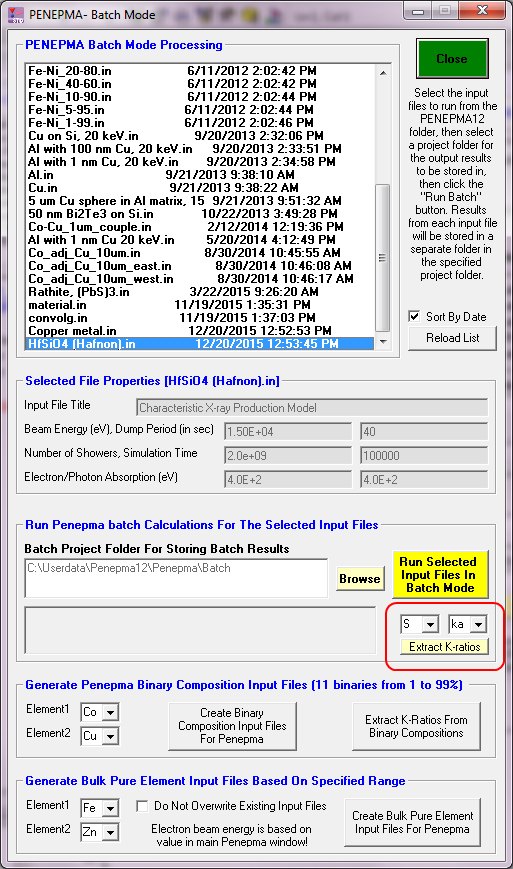

But too bad you didn't ask me about this because I could have told you that there is a button in Standard that does this already!
This dialog is accessed from the Penepma Batch Mode button in the Penepma modeling window. Though I'm sure your dedicated method is better than my simple button!
That's great you can do it from within PENEPMA batch mode - for its a really useful thing to be able to do. - I'll ask you next time!

Please feel free to try the button out.  I mostly wrote it for myself, but I'd be interested if it works intuitively for you.
The code I'm using for k-ratio extractions is on Github in the module Penepma08.bas (it works with Penepma 2008 or Penepma 2012 and maybe Penepma 2014 too- if they didn't change the file format!):
