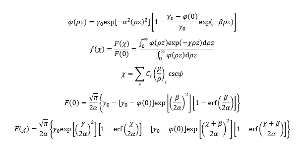

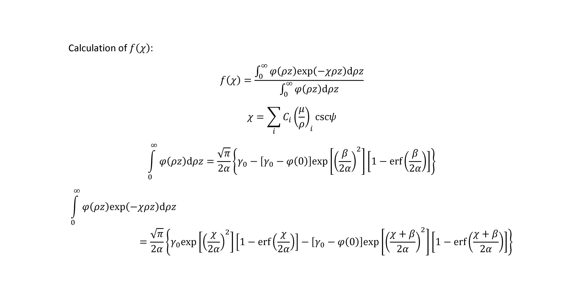

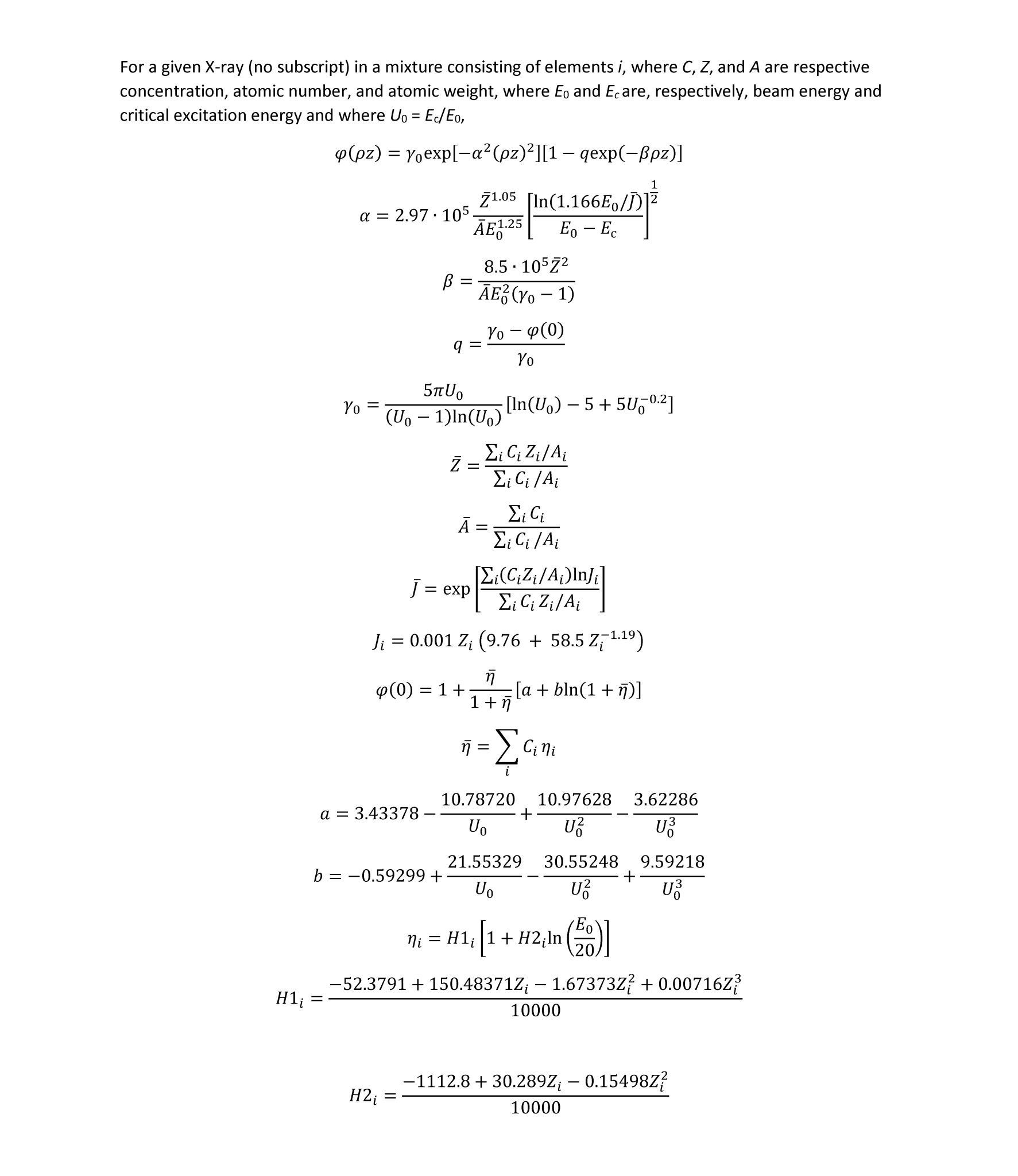

The expressions below (which I've proofread many times) are consistent with those presented in Armstrong's paper in Electron Probe Quantitation, though his presentation isn't really complete (for instance, he doesn't specify the Berger-Seltzer expression for mean ionization energy).  I've replaced the ambiguous E in the expression for alpha with E0, and this appears to be consistent with the equation given in line 1130 in ZAF.bas.
Regarding my calculation of f(chi), I've checked results from the analytical expressions that I give below against results obtained using Simpson's rule (via subroutine qsimp from Numerical Recipes).

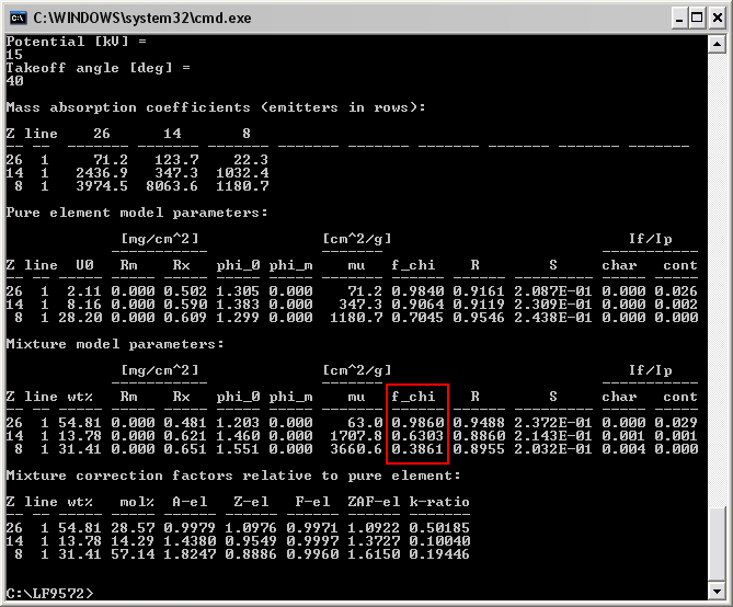

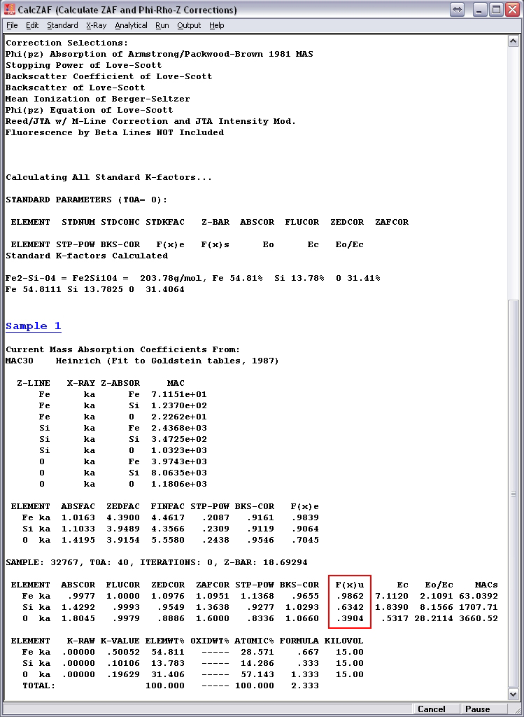

Here I give an example of the differences in my calculated f(chi) versus those from CalcZAF for the case of Fe2SiO4 analyzed at 15 kV potential and 40-degree takeoff angle.  Some very minor discrepancies are present in the MACs (which I've calculated using Heinrich's MAC30 equations), but these differences are too small to have any impact on calculated f(chi) at the illustrated four digits of precision.  For Si Ka in the mixture, I calculate f(chi) = 0.6303, while CalcZAF gives 0.6342.  For O Ka in the mixture, I calculate f(chi) = 0.3861, while CalcZAF gives 0.3904.
CalcZAF output:
My output:

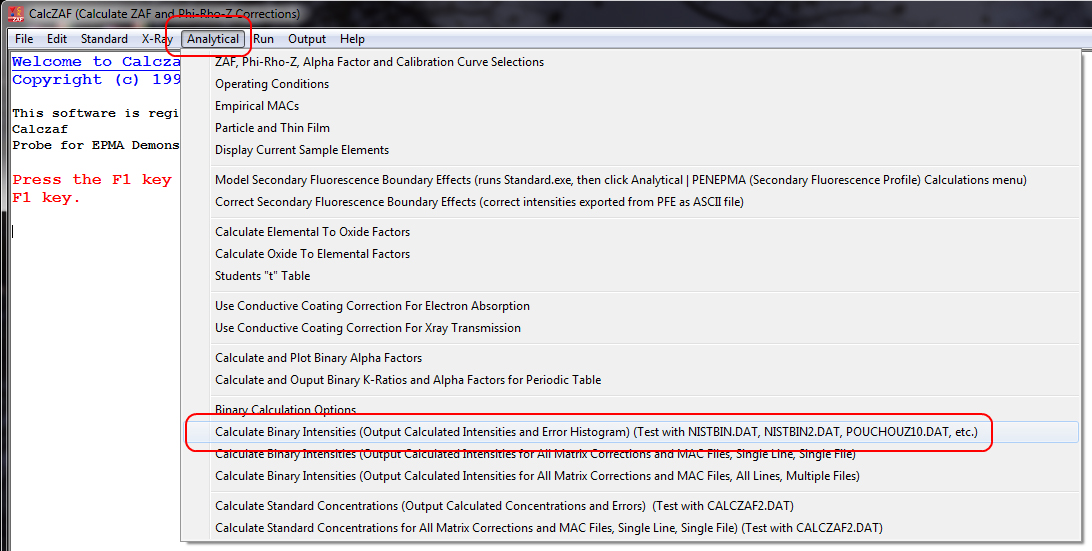

Here are some suggestions:  First of all, you do know that you can run CalcZAF to reprocess bulk intensity data from a text file into an output file?  See the File | Open CalcZAF Input Data File menu...  The input file format is nicely documented in the Help file.

Two more thoughts:  if I were you I'd run a simple composition in CalcZAF in VerboseMode (it's already in DebugMode by default) and compare the intermediate calculations with your FORTRAN.  See the Output menu.

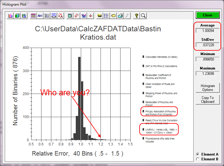

That said, I thought I would start by posting some "baseline" error distributions, so if we do end up making some changes to the code, we can document any degradation/improvement in these calculations.

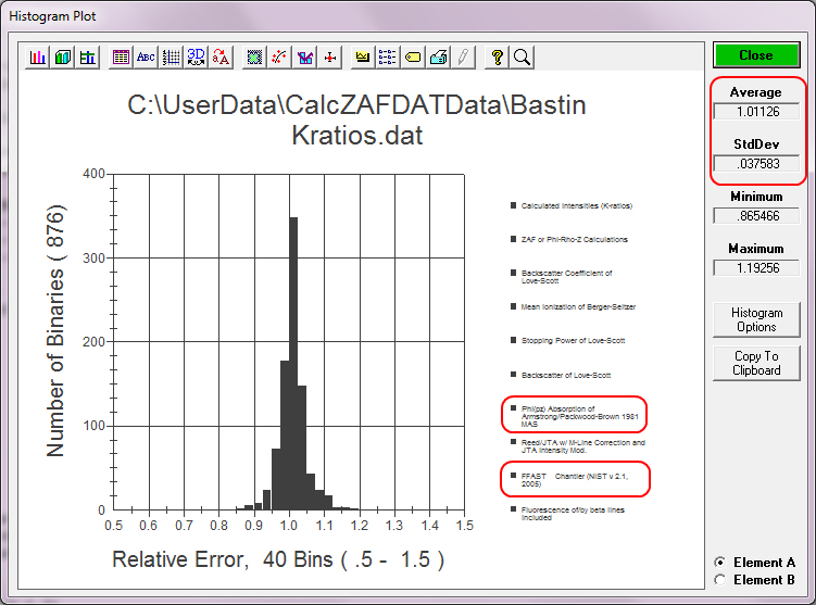

So here are some calculations on the Bastin binary k-ratio database (the full database you sent me with 876 binaries and attached below) using the current release of CalcZAF.  Remember, this operation is easily performed using this menu in CalcZAF:
First the JTA correction using Henke MACs:

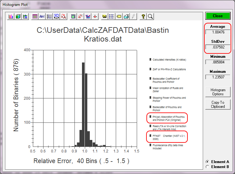

Not too bad, but with a 5.5% variance we can do better.  Let's try with FFAST MACs:

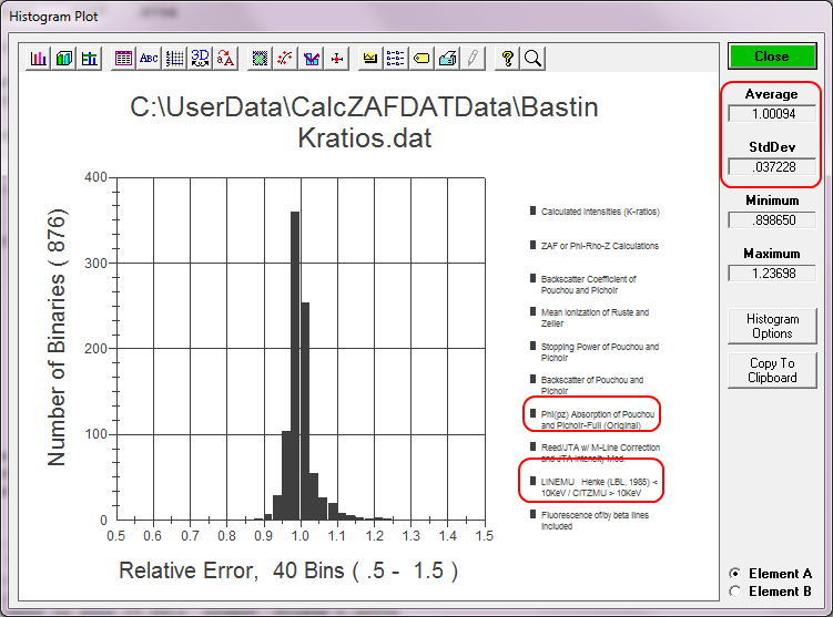

3.75% variance is an improvement.  Now let's try PAP, first with Henke:
Slightly better with a 3.72% variance. Now PAP with FFAST:

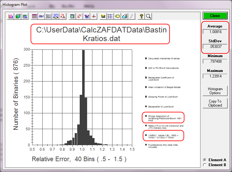

About the same but slightly worse (3.75% variance).  Interesting, but this is mainly to provide a visible "baseline" for any changes we make to the matrix correction codes...
By the way, I find this little bump interesting:
Here are the largest outliers:

I figured out why I was getting different results for f(chi) of M lines using the Armstrong model compared to output from CalcZAF.  It is an issue of numerical precision.
Initially I had been using the following expressions to determine f(chi) for the Armstrong (modified Packwood-Brown) model:
However, for heavy elements, the beta parameter is large because it scales with the square of atomic number.  For instance, in the case of W Ma @ 15 kV, its value (units omitted) according to the Armstrong model is 48982 (and alpha = 2455.0).  Thus beta^2/(4*alpha^2) = 99.520, and exp(99.520) = 1.6634*10^43.  For this case, Fortran returns a value for ERF(beta/(2*alpha)) precisely equal to one, when in truth it should be very, very slightly less than one (beyond the limit of attainable precision).  Thus the expression for F(0) reduces to F(0) = (sqrt(Pi)*gamma0 )/(2*alpha), which is not correct.  Using ERFC instead of ERF produces a better result (since the returned value is not precisely zero), but evaluation of F(0) and F(chi) still requires working with multiplication of extremely large numbers by extremely small numbers.
The solution to the problem is to avoid exponentiation, as is done in CalcZAF.  This is achieved by using the approach of Bastin et al. (1984, X-ray Spectrometry 13:91-97), in which only the polynomial that multiplies the exponential factor in the ERFC approximation is evaluated, noting that the exponential factor in the ERFC approximation is the inverse of the exponential factor that multiplies each respective ERFC factor in the expressions for F(0) and F(chi).  (See the attached document if you want.)
