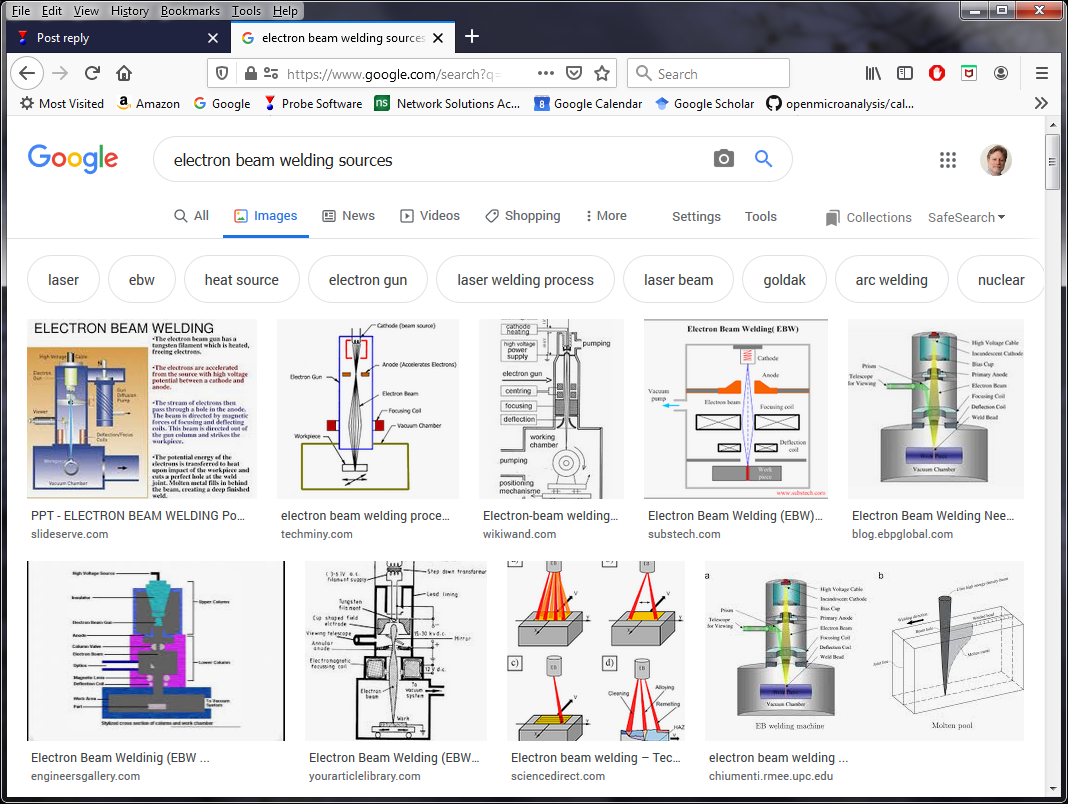

I have no idea if this technology would be appropriate for your needs, but you might try googling "electron beam welding sources" and see if you see anything interesting at all.
These ought to be enough beam current for your purposes!
koeck@kth.se
Quote from: Probeman on February 11, 2020, 09:11:20 AM
Thanks for the idea!
The problem might be the probe diameter that's too big for my purposes, but it certainly shows that very high beam currents can be reached.
