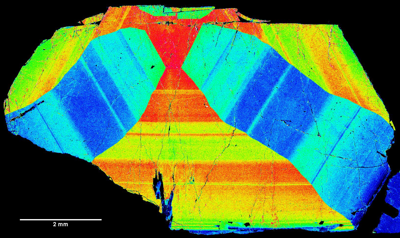

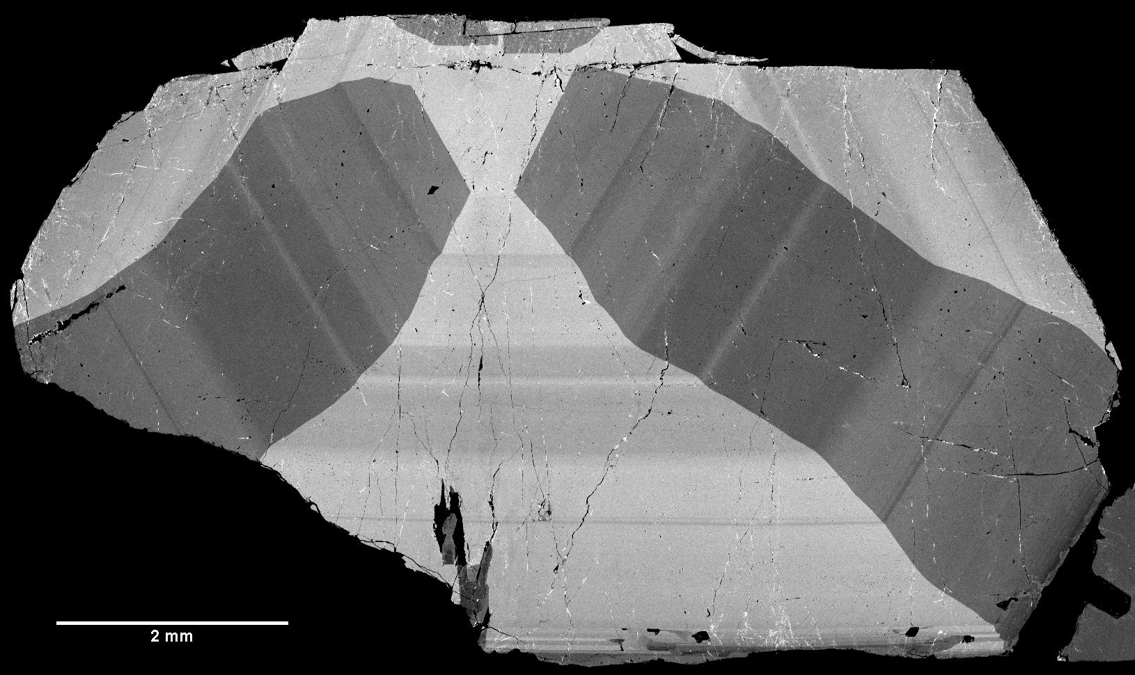

I used to do a lot of work on uraninite, especially during the period 2011-2014.  This work involved point analyses, X-ray maps, and abundant wavelength scans to determine trace element contents and interferences (as you can find virtually anything in uraninite).  I typically ran the wavelength scans at a microamp of current.  The Th Ma map of a sector-zoned uraninite below, collected at 250 nA (in March, 2014), measures 1550 x 900 pixels and required about 32 hours to complete.  In the red/bright areas, ThO2 content ranges up to about 10 wt%, while in the blue/dark areas, it ranges down to about 6 wt%.  I used the PETH crystal for the map; Th Ma X-ray count rates within the mineral grain would have varied between about 10 and 20 kcps.  I covered the epoxy around the grain with copper tape.
By the time I had the LiFL/PETL and LiFH/PETH Xe counters replaced in December, 2015 (a month before the service contract ended), I would have needed to set the anode bias at about 1740 V for Fe Ka on either while using gain = 32 in order to get a pulse amplitude distribution centered at 4 V.  These counters had only been in service since April, 2011.  The "new" ones have been in use for more than six years (and currently require bias = 1670 V at gain = 32 for Fe Ka).
