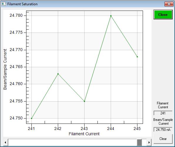

I added a new filament saturation window to the GunAlign app for 8900 and 8200 instruments as seen here:
One simply clicks the horizontal scroll bar to change the filament current and it automatically plots the beam current for that filament current.
It's pretty basic at this point, so please let me know what you think or have any suggestions.
Awesome. Now it needs export functions for the graph as well as the data. Super useful for easy record keeping. Thanks!
Quote from: Anette von der Handt on June 21, 2016, 08:41:03 AM
So are you wanting just a Clipboard button or do you also want a data export to Excel button?
Gimme all ;). No seriously, I see that both would be valuable depending how people want to keep records for their lab (some like numbers, some like graphs)
Quote from: Anette von der Handt on June 21, 2016, 10:50:01 AM
John added Clipboard and Export buttons to the filament saturation window. Download the update any time (same version number) from the Help menu.
