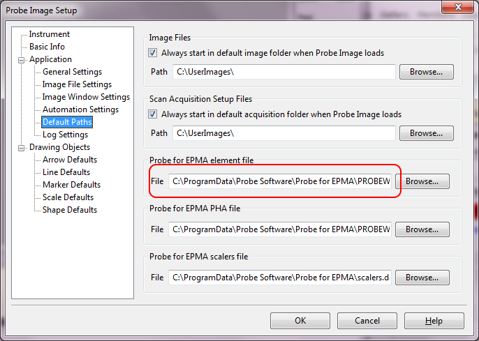

This button definitely works as I just used it last week.  Try checking the Default Paths in the Setup | Probe Setup menu and make sure it points to the correct folder where the Probewin.elm file is.  What is your OS?

The Element button definitely does not work on our instrument as I just tried it yesterday. We are running Windows 7 Professional (64-bit). It stopped working on the previous version update. I will check the path again once the maps are done on Monday but we didn't change any of the settings when updating.

Hi Heather,
You are speaking of the Read ELM and ELM All buttons in the PI setup acquisition dialog?
I just tried both buttons and both work fine for me. Your file path must not be correct.  Under Win7 (64), they should look like this:
