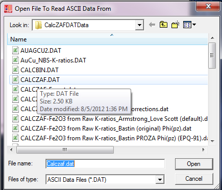

See the example CalcZAF.dat file for examples by clicking the File | Open CalcZAF Input data File menu:

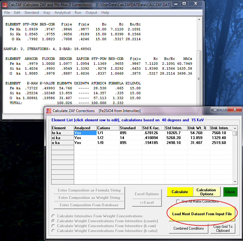

Simply click the Load Next Dataset From Input File button to see each data set one at a time and click the Calculate button to see the calculation results:
