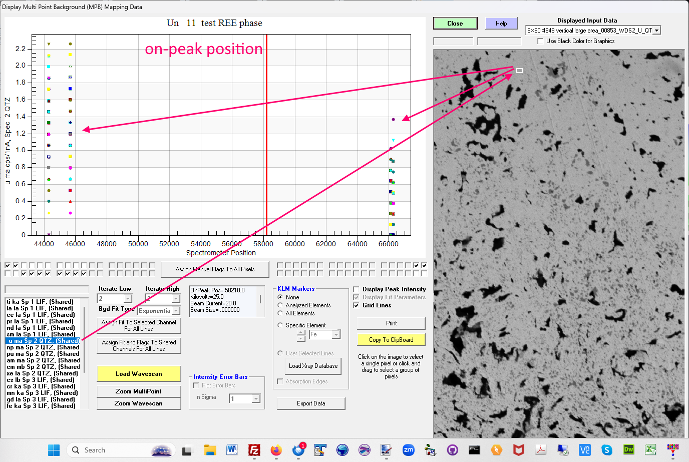

we have implemented a method to utilize Multi-Point Background (MPB) x-ray maps as "shared" off-peak maps in CalcImage.   That is one can acquire 2, 1 or no off-peak images per on-peak element map in Probe Image, and then utilize the off-peak maps from other elements to perform the off-peak background fit for an on-peak element.  Assuming of course that one has more than a single element (and off-peak maps) per spectrometer/crystal combination.

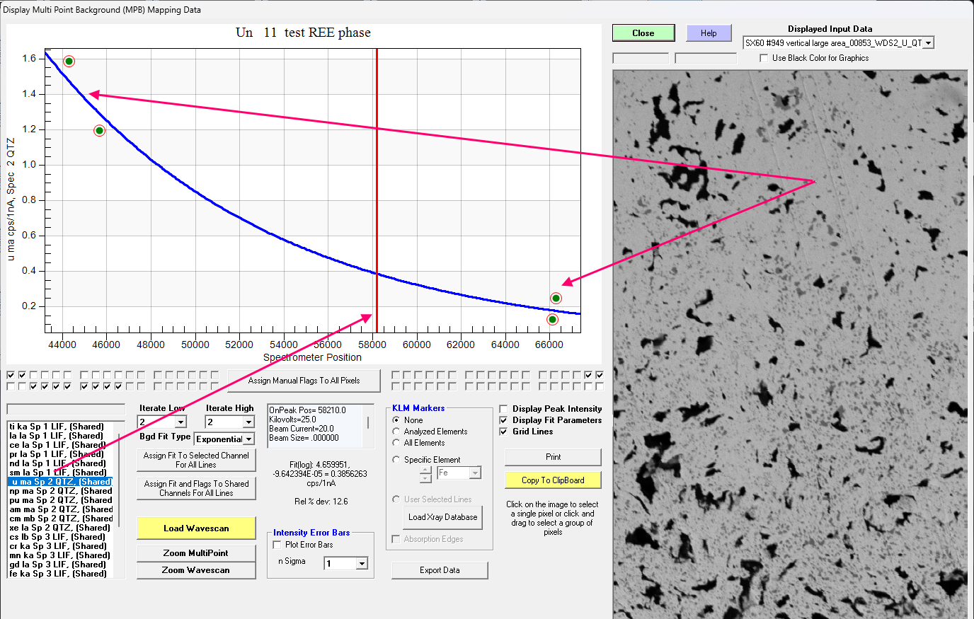

Now we have also implemented a method to display these MPB background intensities for selected pixels in your x-ray maps from the Run menu in CalcImage as shown here:
In addition one can display only a single pixel and see the fit:
