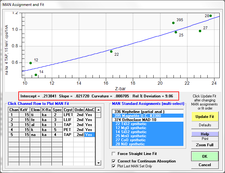

For example , Using MgO, Al2O3 and SiO2 to determine MAN bkg of Na Ka, running the MAN acquisition gave the following values
MgO 24, Al2O3 18 and SiO2 17, and when I ran wavescans I verified those were correct. But I was initially confused when I saw that the values on the MAN graphic plot were different: MgO 37, Al2O3 31 and SiO2 9.5...until I guessed that these were continuum corrected, so I turned off that box and bang...there was 24, 18, and 17. Cool.
But now I am scratching my head...what number then does PfE use for the background? So is the continuum-modified value on the curve used directly as the background? Or is it then uncorrected for when it is subtracted from the raw peak counts (which at first instance aren't corrected for anything, one assumes).

Yes, the displayed MAN curve is by default corrected for continuum absorption for each MAN standard.  One can display the raw data in the MAN dialog, but the stored MAN background curve is always corrected for absorption as suggested by John Armstrong.  Essentially this creates a calibration curve of the GENERATED intensities (as opposed to the emitted intensities one measured).   Why do we need this?  Because we want to understand the relationship between continuum intensity and Z, without the complications of the continuum absorption, which will be different for every material (including our unknowns!).

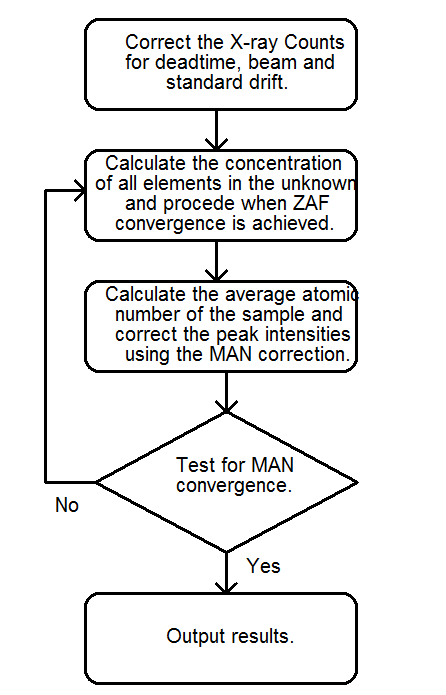

So now that we have a continuum corrected curve we need to apply this to our unknown material, which is of course a measurement of the emitted intensities. So we de-correct the calculated MAN intensity value (based on the sample z-bar) for the actual matrix physics of our unknown and then subtract that from the measured emitted intensity of our sample.
My trace MAN paper is under review currently but here's an excerpt from it regarding this point:
QuoteThis "virtual" intensity MAN calibration curve which has been corrected for continuum absorption, is then stored for subsequent use for MAN background correction of unknown compositions.  During the iterated matrix correction of the unknown intensities, we initially assume an arbitrary Z-bar for the unknown, and then calculate the background intensity from our previously acquired and stored "virtual" MAN intensity regression. This calculated average Z is then improved as the composition converges during the matrix iteration. Finally we de-correct the calculated background intensity for the continuum absorption associated with the actual unknown composition as seen here:
         Iraw = Icor/ZAFu
where ZAFu is the absorption term for the unknown composition undergoing iteration. The IRAW background intensity is then simply subtracted from the measured unknown on-peak intensity to obtain the background corrected intensity for the unknown composition. This calculation proceeds until the composition (and hence average Z) converges, and a proper background correction has been applied.

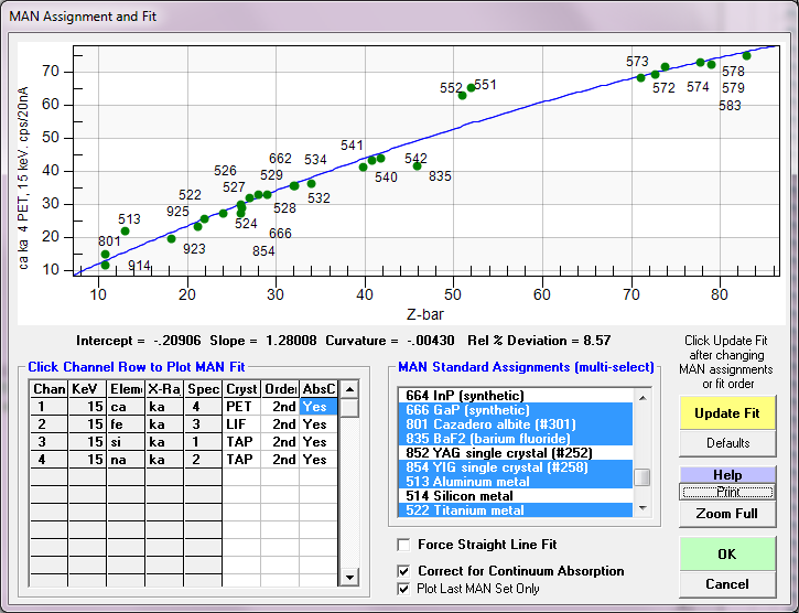

I almost always use pure oxides (MgO, SiO2, TiO2, etc.) for my MAN curves and when one does that, the differences between the absorption correction are quite similar to the f(chi) term. Here I've plotted the MAN curve for Na Ka (a very highly absorbed wavelength) using the absorption correction term:

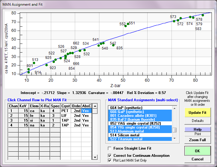

and here is the same but corrected using the f(chi) term:
The absolute values are slightly different (which when de-corrected for the unknown matrix gives the same result because they are multiplied in the standard fit, but divided in the unknown correction), but the error in the regression fits are exactly the same!  These are all compound standards so as I said above this is expected, but I think the curves will look more different when some pure elements are included in the MAN fit as you pointed out. But I can't lay my hands on an MAN curve with pure elements at the moment, but I will look further.
So yes, I agree we should be using the f(chi) values for the MAN continuum absorption correction.  Good catch!

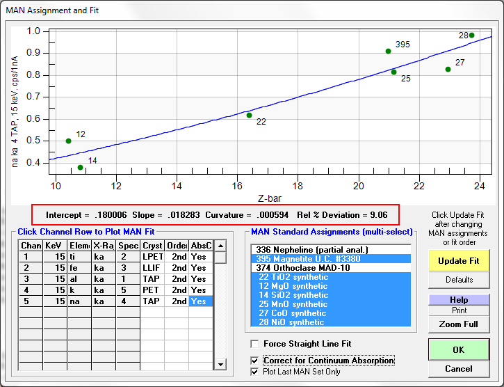

Now here is the same plot but using the f(chi) term:
Yes, the absolute values are slightly different because the absorption correction term is normalized to pure Ca, and the f(chi) is not, but the results are *exactly* the same after both multiplying and dividing the MAN intensities.
Sorry about that- false alarm... we can all "go home now"   ;D

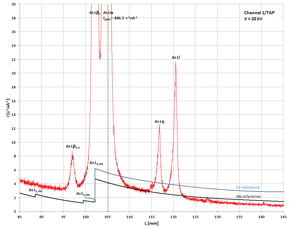

A couple years ago, I tried to model WD background intensity for arsenic at and around the La peak position (comparing to the spectrum measured on high-purity, uncoated As) using the method of Smith and Reed (1981, attached), in which the spectrum of the element or compound of interest is normalized to a spectrum collected on an element or compound that produces no characteristic X-rays within the Bragg-angle region of interest.  I collected reference spectra on high-purity Nb and Fe* and applied the continuum intensity expression of Smith and Reed (modified from Kramers) along with the continuum absorption and backscatter loss corrections of Small et al. (1987, also attached).  I found that the results were not really satisfactory and differed significantly depending on the reference material chosen (see below).  My next project is to try the MAN approach instead.
Note:  The curves labeled "Fe reference" and "Nb reference" represent the calculated As continuum intensities normalized to spectra collected on Fe and Nb, respectively.
* I should note that I substituted polynomials for the actual measured Fe and Nb continuum intensities.  This way I was able to produce smooth curves and ignore minor interferences from high-order reflections of the Fe K lines.
Quote from: Brian Joy on December 01, 2016, 01:49:19 PM
Here's what I would say about the MAN method- it's hard to beat modeling the background intensity *at* the peak position!   :)
With the MAN method not only does one save a lot of time, but there are no absorption edges to deal with, no off-peak interferences to avoid, no curvature of the continuum to fit, etc., etc.
