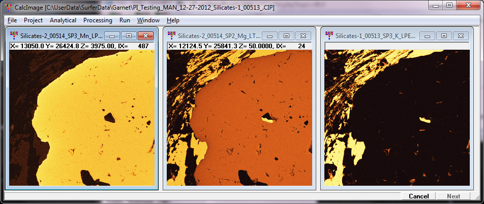

For example, here is a vertical tile on a large number of images:
and here are the same images but horizontally tiled:
So there is a difference but it depends on the number of images and their aspect ratios.

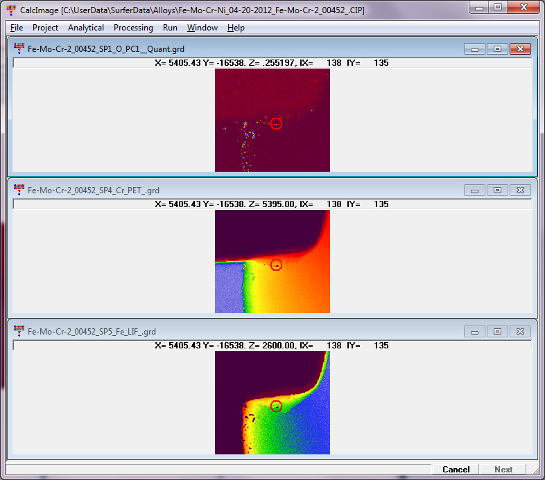

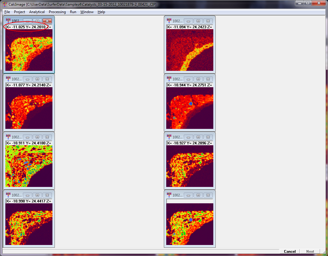

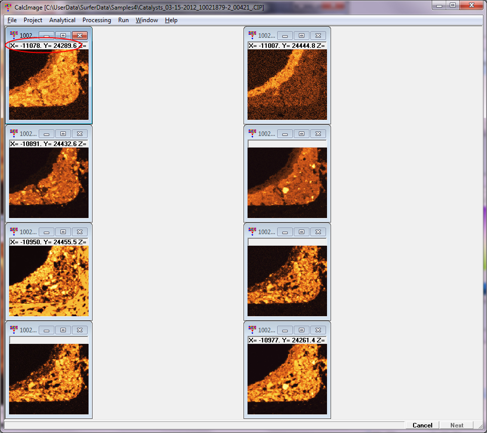

For Cameca users (such as Philipp and I), that means when we install PFE for off-line data and image re-processing we will be loading Cameca oriented images into an "assumed" JEOL stage orientation. What will this look like?  Well, our Cameca micron stage units will be converted to mm   and *also* the images will be flipped into the JEOL "anti-Cartesian" coordinate system for self consistency as seen here:
This after using the File | Close Off-Peak Images menu to close all but the on-peak images. After the Window | Tile Horizontal menu is clicked we see the same JEOL mm stage units:

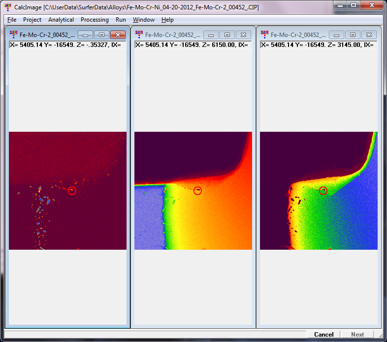

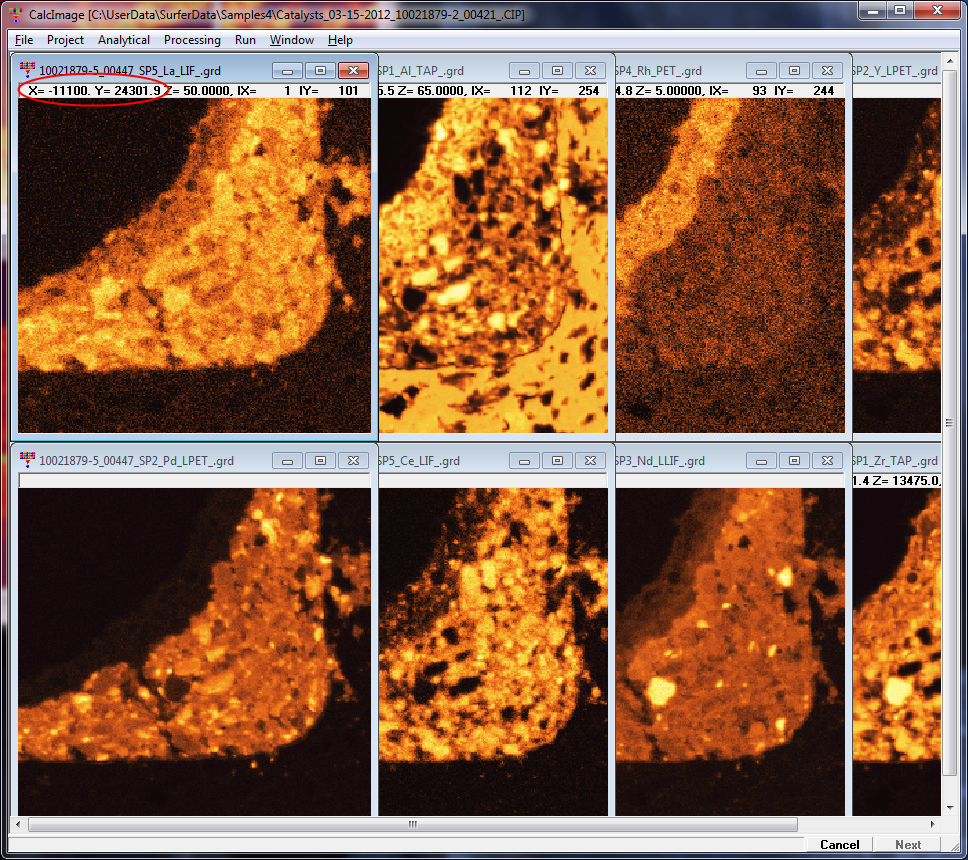

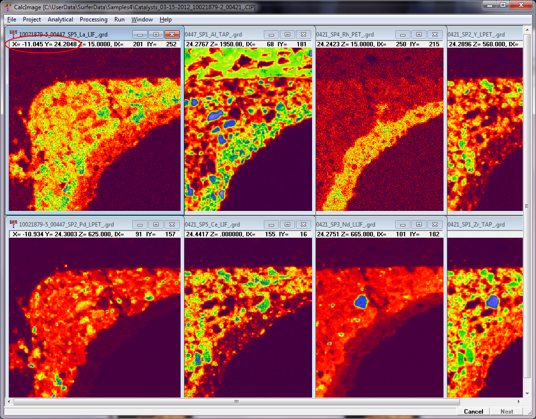

Once your Cameca config files are copied over from your on-line probe computer (connected to the instrument) to your off-line computer (for data re-processing), you now see the same CalcImage files displayed properly in Cameca stage orientation coordinates and orientation, again, after closing the off-peak images using the File | Close Off-Peak Images menu, as seen here:
Tiling horizontally, the same images appear like this:

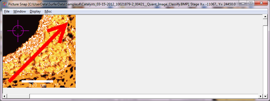

Final note: the same concepts also apply to PictureSnap window which is now accessible in CalcImage from the Run menu. That is, the displayed image orientation and stage coordinate values are converted to reflect the proper Cartesian (Cameca) or "anti-cartesian" (JEOL) systems based on the current configuration of the software.

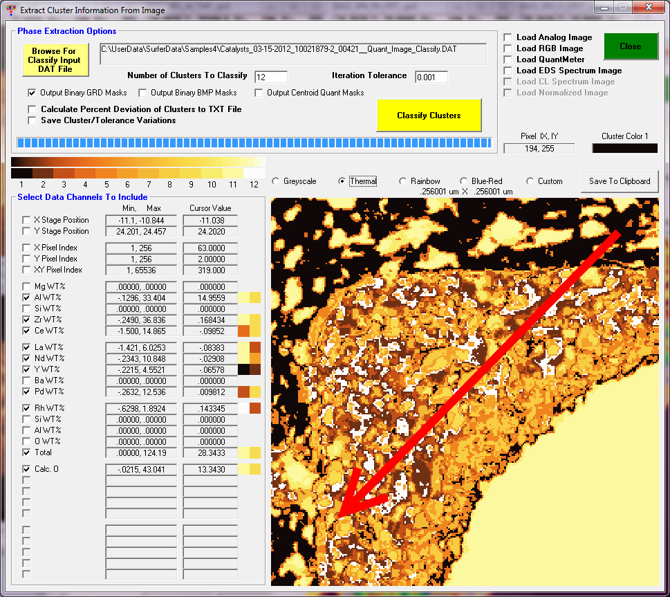

Here is a Cameca acquired classification image displayed in CalcImage with a JEOL (default PFE) configuration:

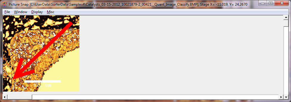

The direction of the arrow shows the increasing X and Y max. Note also the JEOL mm units for the stage coordinates. Now note the same image (exported automatically) and opened in the PictureSnap window with the same JEOL (default PFE)  configuration:
And here is the same image again, but open with a Cameca configuration in the CalcImage PictureSnap window:
Note once again (image colors are slightly different because a different kmeans precision was used to extract the phases), the coordinate orientation is now Cartesian (X and Y max to upper right as shown by the arrow) and the stage units are in um.
The point being that CalcImage automatically handles the image orientation and stage units properly at all times, though Cameca users may want to update their off-line data re-processing computers with their on-line instrument computer configuration files.

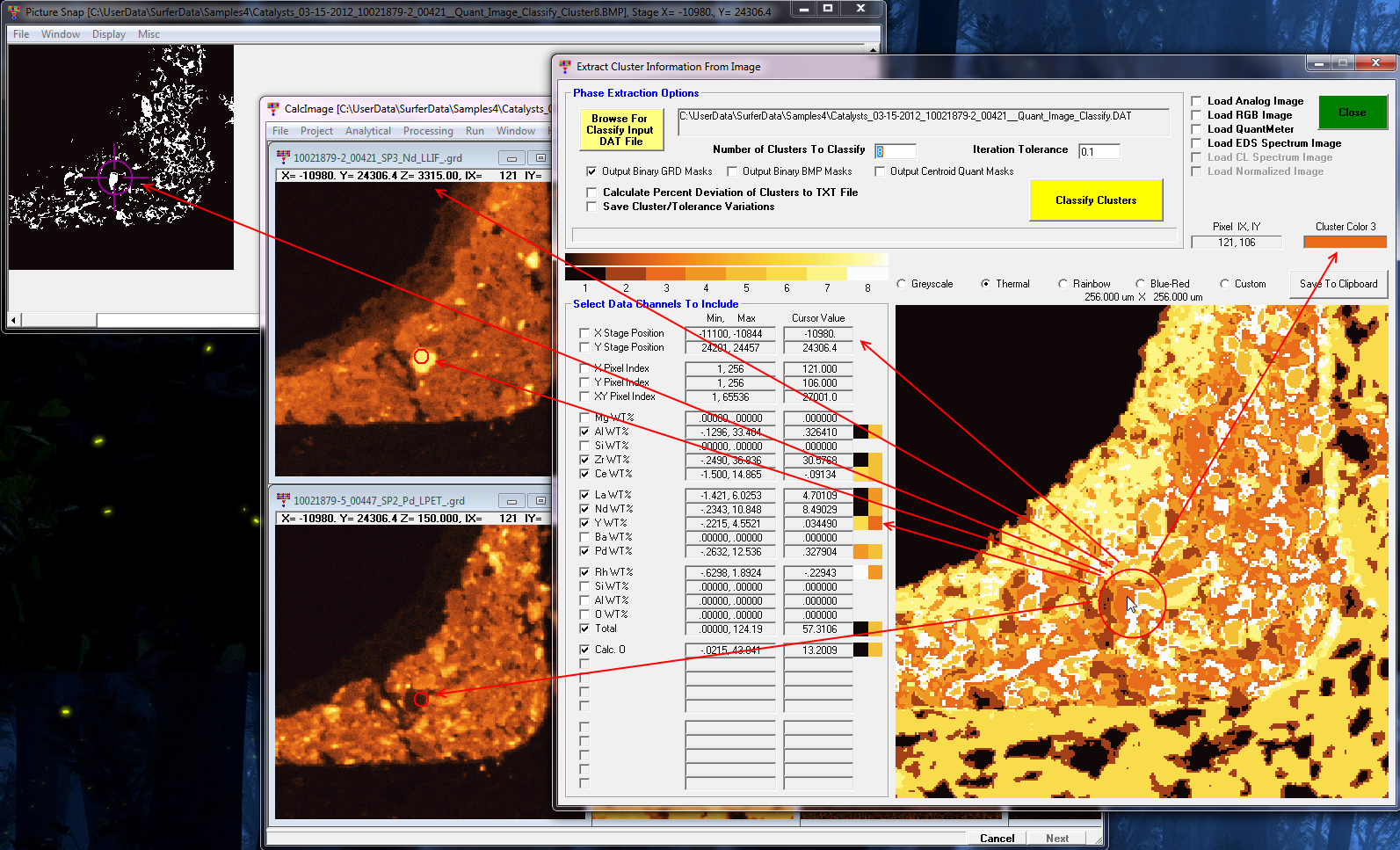

And finally, for your enjoyment, here are some of the same data displayed showing the "hyper-cursor" feature which correlates x-ray intensities, quantitative weight percent, atomic percent, and phase mask extraction for one's phases.

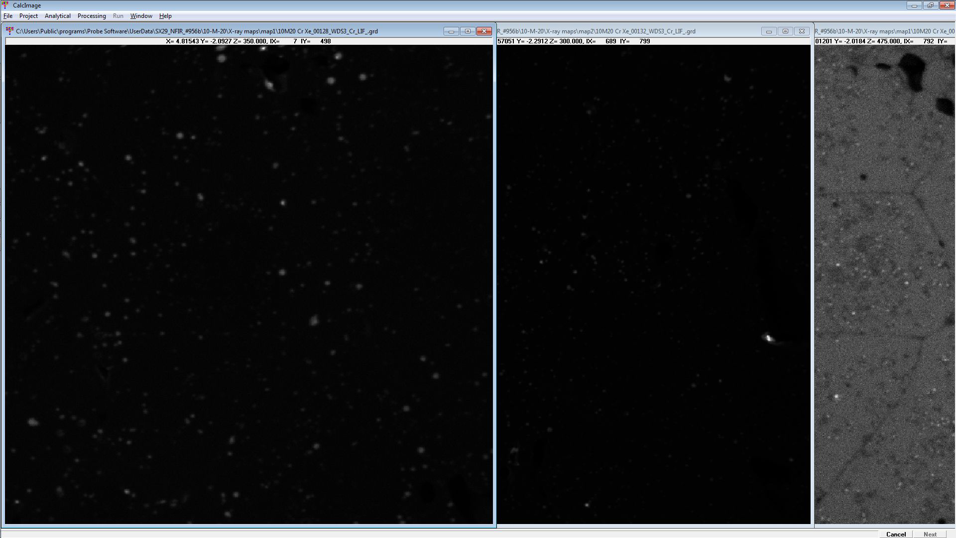

Ok, for me it does not work:
tile horizontally:
tile vertically:
Hi Philipp,
Ok, I see.

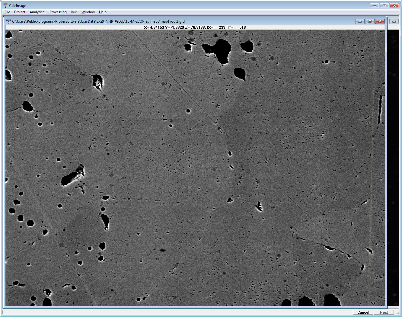

First I would have you check that you have the latest CalcImage, but it looks like the reason you are having a problem is that in addition to the x-ray maps you are also loading a high resolution BSE video image (2048 pixels wide?). Is that correct?
If so, my tiling method might not work correctly unless you have a larger monitor.  Try again but make your CalcImage window maximized and also try without the BSE image.
this is with a maximized window and 3 800x800 pixel x-ray maps...
Ph

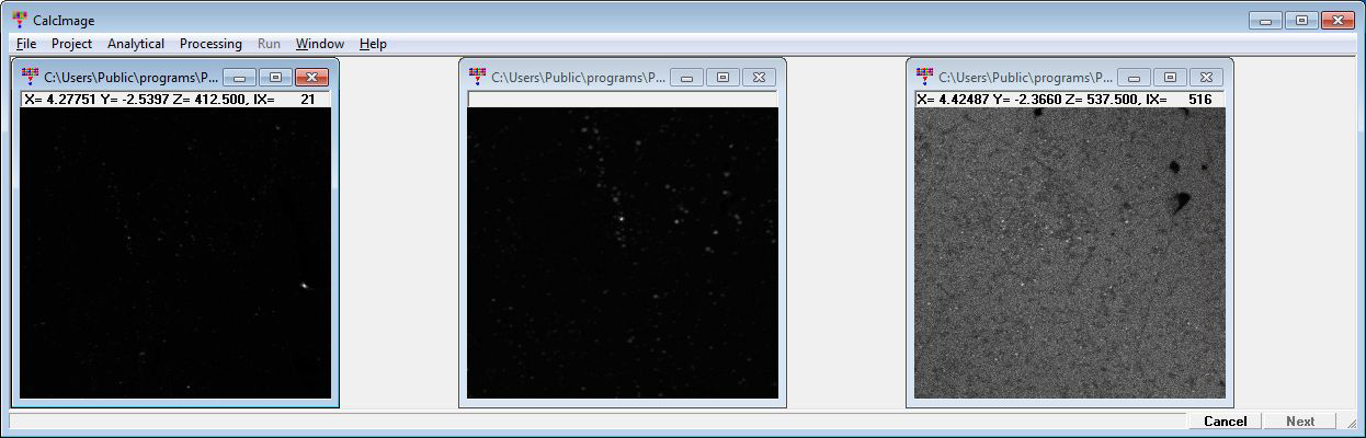

Hi Philipp,
OK. And if you make the window less tall, you'll get this when you tile vertically, right?
I get something like this:
OK, so now make the window just a wee bit taller...
Not if you make them only a "wee bit" taller!   ;D
Hi Philipp,

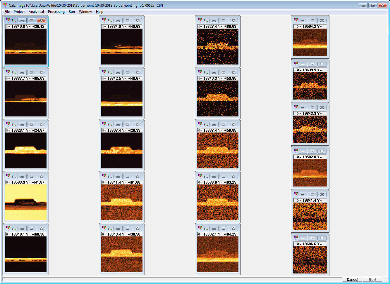

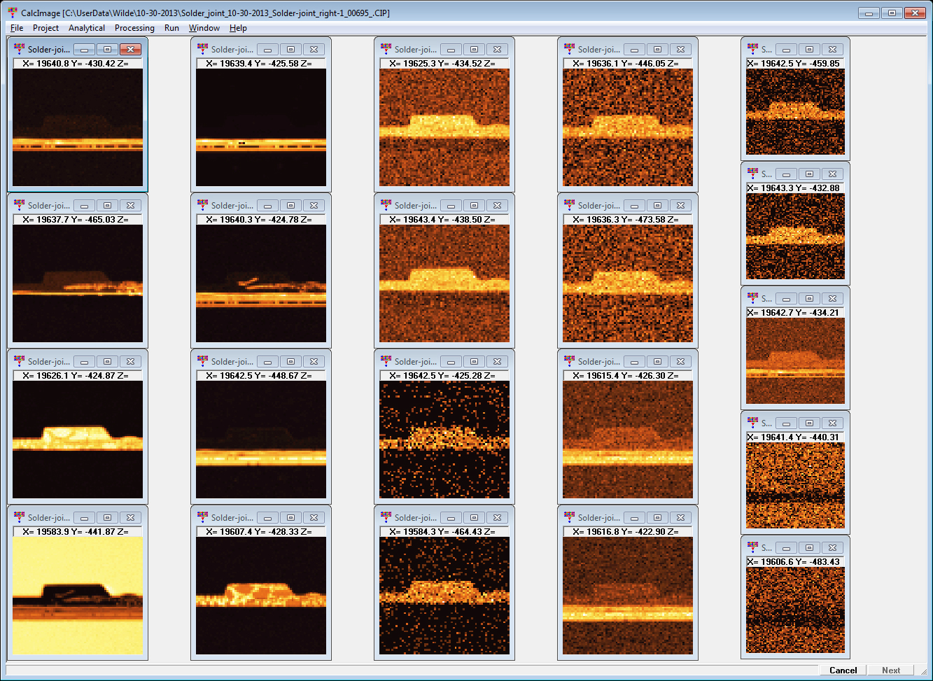

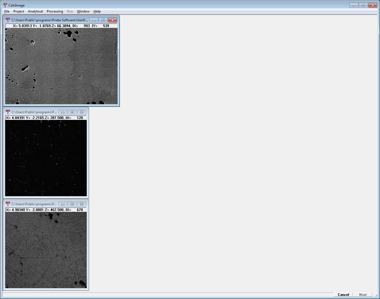

I re-worked the image aspect ratio re-size code and it works much better now. Please try it on your maps.
Here is the horizontal tile with 3 maps:
and here it is vertically tiled:
Note that Microsoft gets to decide whether these get re-tiled or not, so this is somewhat OS dependent.
