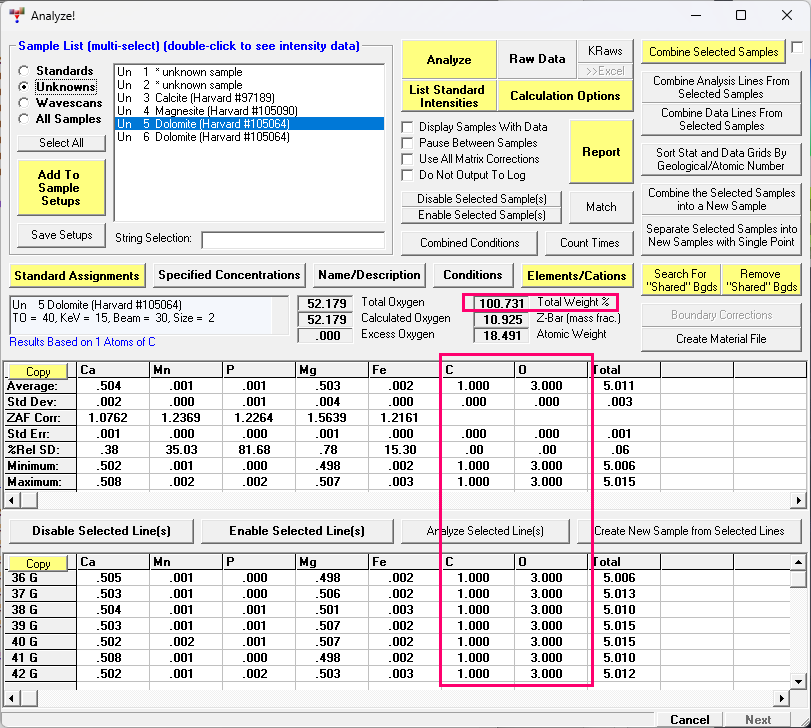

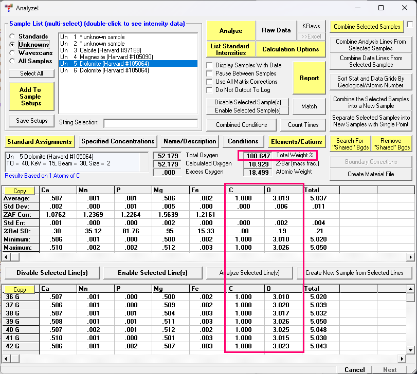

#133
Quote from: John Donovan on July 30, 2019, 11:28:09 AMAndrew, Paul and I are in contact with John Armstrong and he explains the problem as being a well known (at the time!) issue, which occurs whenever an *unanalyzed* element is being calculated relative to calculated (unanalyzed) oxygen. He put it this way to us: oxygen calculated by stoichiometry is no problem when all other elements are measured. But when another unanalyzed element is introduced and this element is also dependent on the (also) unanalyzed oxygen, the solution is not obvious.
The basic issue being, what oxygen concentration should be utilized for the element relative to total oxygen? The oxygen value used in the last iteration for calculating correction factors is one possibility, and there's also the oxygen value adjusted for the other unanalyzed element...
There were several different methods proposed by various researchers at the time, but no one solution gave a perfect result.  In fact all the proposed methods gave good results when the analytical totals were close to 100%, but they also gave increasingly different results as the analytical totals (including the unanalyzed elements) diverged from 100%.
John Armstrong said he would review the code to remember which method he chose at the time, but whatever method was chosen, there may not be a perfect solution to this issue.
Just a followup to the questions raised by Andrew Locock above regarding the calculation of an element by stoichiometry to oxygen calculated by stoichiometry... e.g., carbon calculated by stoiochiometry to oxygen calculated by cation stoichiometry in carbonates.
https://smf.probesoftware.com/index.php?topic=92.msg8550#msg8550

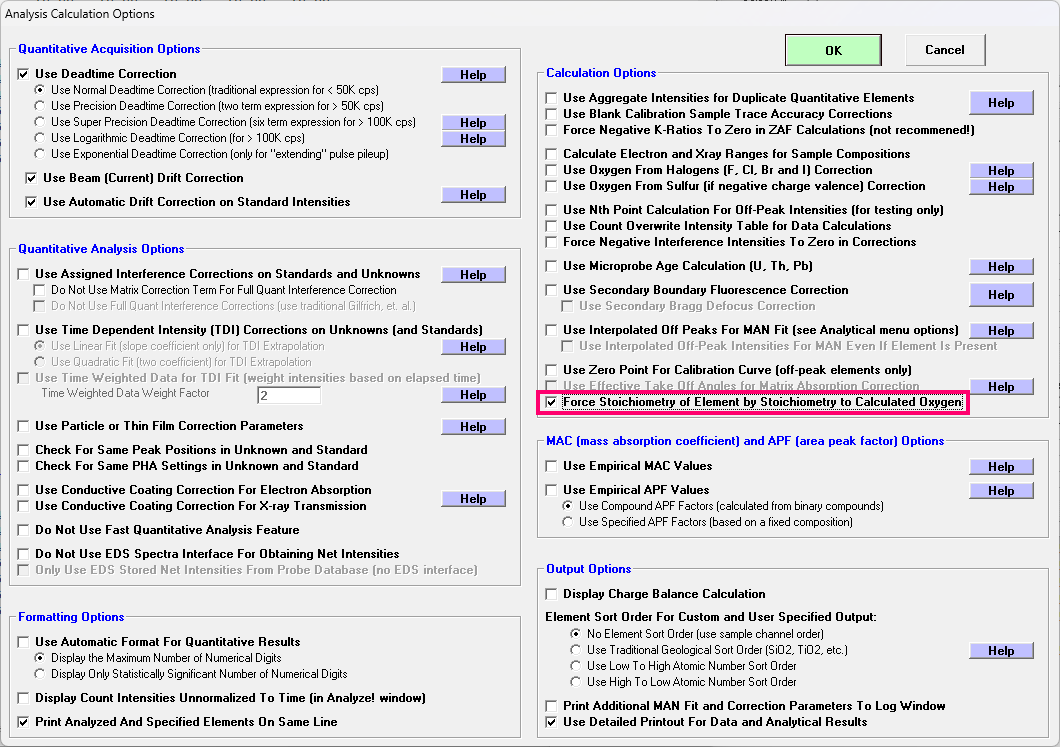

After some recent discussions with Andrew Locock and Julien Allaz on how to deal with small non-stoichiometries in the reported carbon to oxygen ratios when the analytical total diverges from 100%, Aurelien Moy and I decided to implement a user option to force this stoichiometry when specified by the user.
Please note however, that this not only means that the reported matrix correction is no longer perfectly commensurate with the reported composition, but also that if the stoichiometry specified by the user is incorrect, this could lead to unpredictable results.
So the option is now available, but use it at your own risk!
Update to the latest Probe for EPMA using the Help menu or downloading the msi installer from our Resources page:
Continuing from the above post:
https://smf.probesoftware.com/index.php?topic=92.msg14315#msg14315
here is a simulated analysis of a magnesite carbonate (without forced carbon stoichiometry):
and here with forced carbon stoichiometry:
I still don't like it (note that the matrix corrections are exactly the same), but if it makes the mineralogists happy, that's a good thing.
