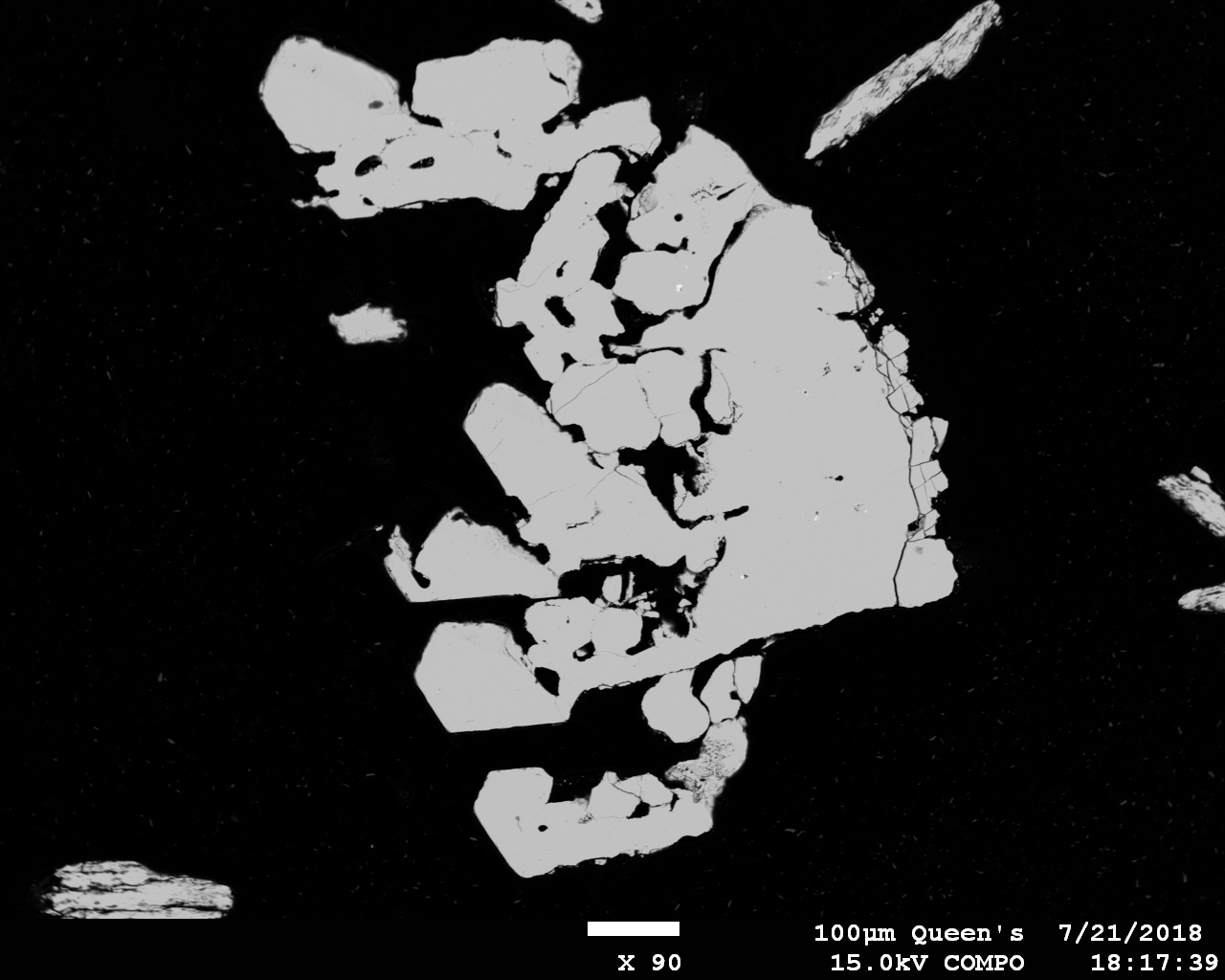

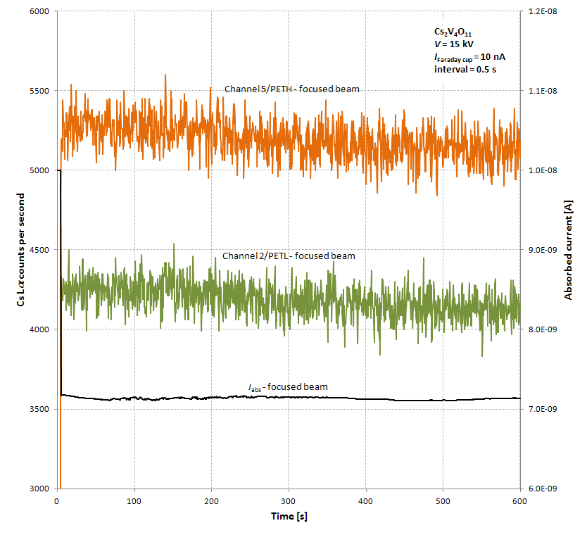

I've come across a compound, Cs2V4O11, that could serve as a useful Cs standard simply because it's incredibly easy to produce, is not water soluble, is not hygroscopic, and is only moderately beam-sensitive.  The attached paper provides some details on the structure of Cs2V4O11.  The compound contains 43.65 wt% Cs2O and 56.35 wt% V2O5.  When using Cs2CO3 and V2O5 as starting materials, 47.25 wt% Cs2CO3 (dried) and 52.75 wt% V2O5 give the proper stoichiometry.  Or one can use 48.07 wt% CsCl (dried) and 51.93 wt% V2O5.  If an excess of Cs2CO3 or CsCl is added, then CsVO3 is produced in addition to the target compound.  CsVO3 is water soluble (though dissolves slowly), and so its presence provides a useful means of loosening the Cs2V4O11 crystals, though some chipping may be necessary.  In my run, I used 1.56 g powdered Cs2CO3 and 1.48 g powdered V2O5, mixed thoroughly with a toothpick.  Although I used an alumina crucible to grow the compound, it would probably be fine to use a porcelain crucible.  The synthesis is outrageously simple:  Just place the mixture in a furnace overnight at ~550°C and then allow it to cool to room temperature within the furnace.  That's it.  (I cooled the furnace at 5°C per hour for 20 hours, but I don't know that this is necessary.)  In this approach, when using Cs2CO3, the volume of the crucible needs to be at least an order of magnitude greater than the volume of the reactants, as the reaction releases CO2.  The resulting intergrown reaction products are 100% crystalline, and so the yield is high.  The Cs2V4O11 is orange-brown, while the CsVO3 is colorless.  The crystals range up to several mm in length and possess voids previously occupied by CsVO3 (with very minor remaining CsVO3 producing bright spots in BSE):
I've subjected the material to my usual test of exposure to a focused 15 keV/10 nA beam for ten minutes.  The results, shown below, show that the Cs Lα count rate remains essentially constant for perhaps 150 seconds before starting to drop off.

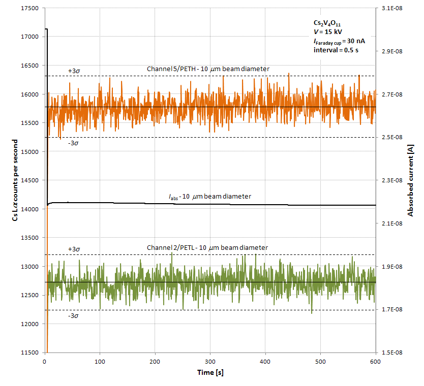

With a 30 nA beam current and the beam defocused to 10 microns, the Cs Lα count rate remains steady within counting error.  Note that the apparent slight upward drift in count rate on channel 5 is not present on channel 2.  Regardless, just slight defocusing of the beam (to perhaps 5 microns) at 10 nA should prevent beam damage and yield count rates in the few thousands per second on PET.

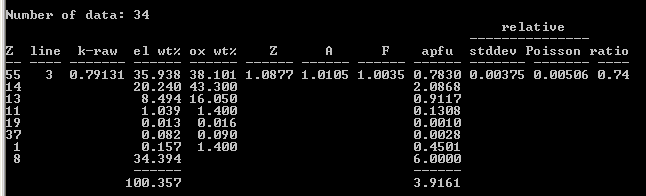

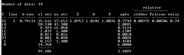

Analyzing my pollucite for Cs while assuming a fixed matrix composition produces the results shown below.  Note that Cs L3,abs is located at ~79.16 mm on PET and at ~172.00 on LiF, so V Kα cannot ionize Cs L3, but V Kβ can; therefore a small but non-negligible fluorescence correction to Cs Lα must be considered.  This is not the ideal situation, but, then, the correction is less than 0.5%.  Once again, the atomic number correction dominates the matrix corrections.

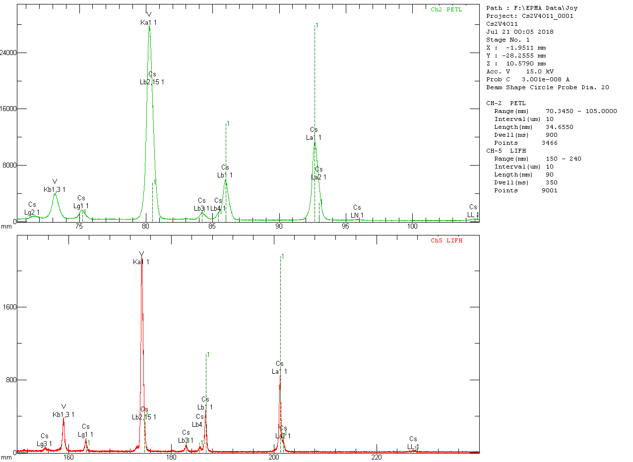

WD spectra are shown here:
Note that Cs Lβ2 interferes at the V Kα peak position using either PET or LiF.
Hi Brian,
I don't think that much change in intensity is a problem at all. Even with higher beam currents this can be easily handled, e.g., in Probe for EPMA. Since PFE includes a TDI correction not only for unknowns but also for standards!

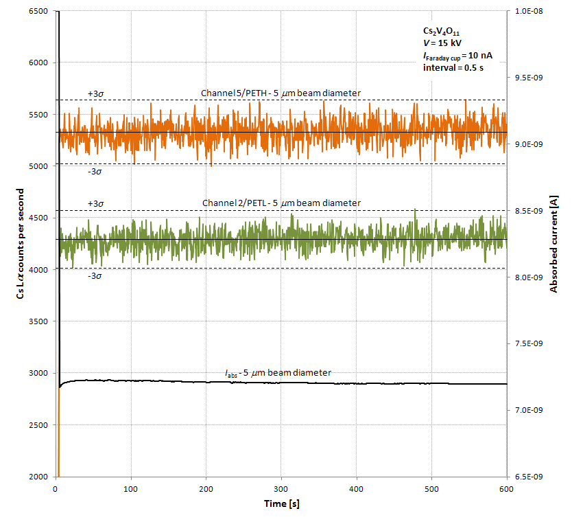

Here is a plot of Cs Lα count rates in Cs2V4O11 using 15 keV/10 nA and with the beam defocused to 5 microns.
