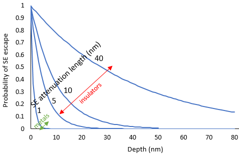

Also the SE behaviour varies between insulators and metals - they have different escape depths
SE attenuation length from Cazaux 2006
