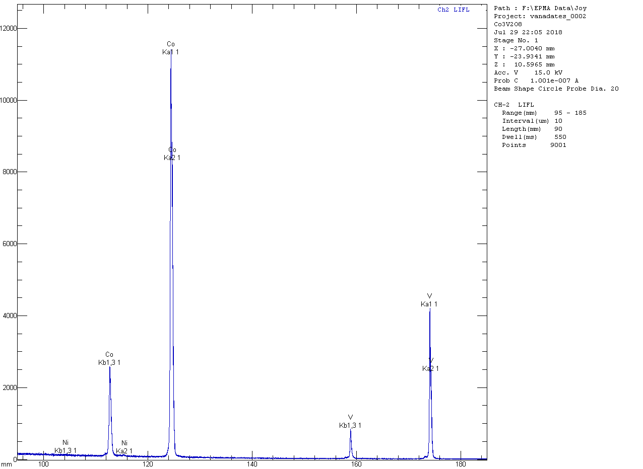

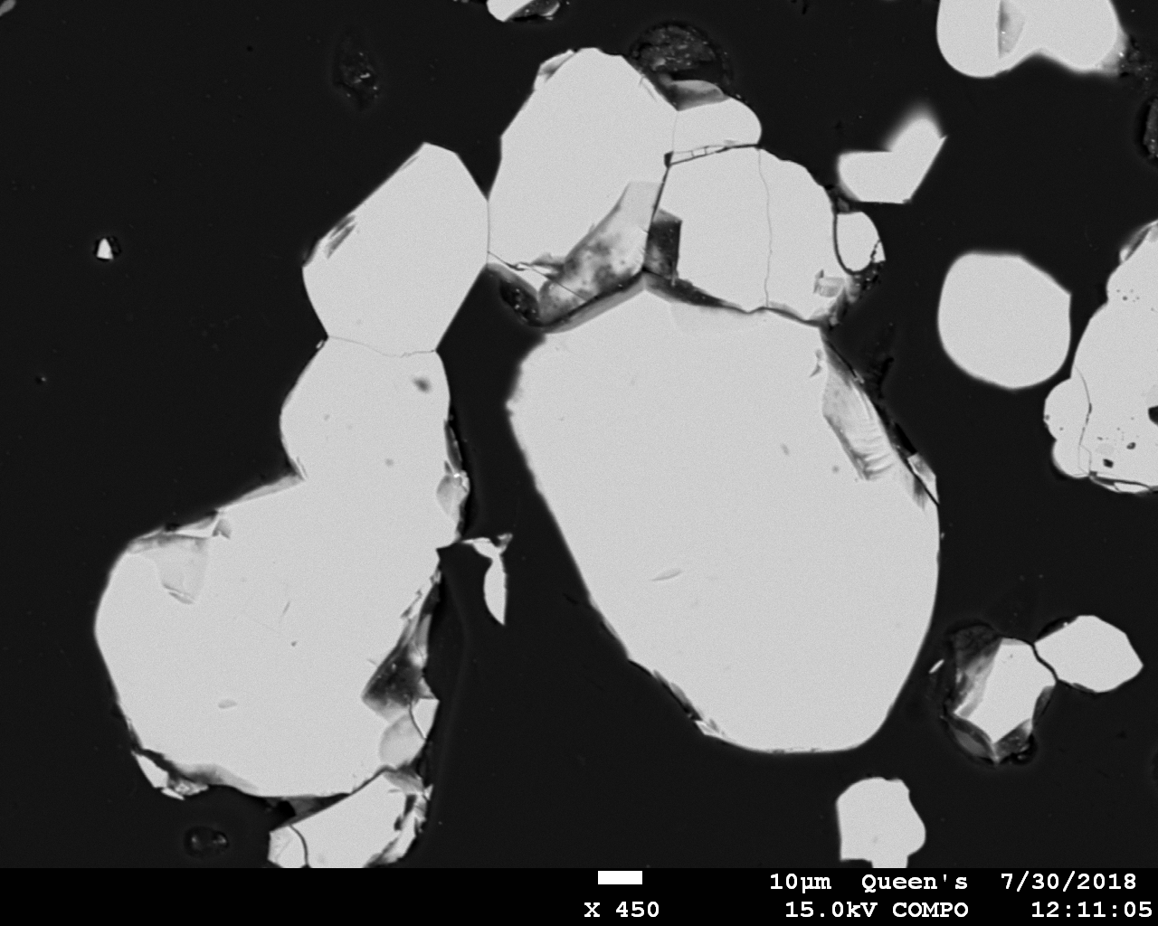

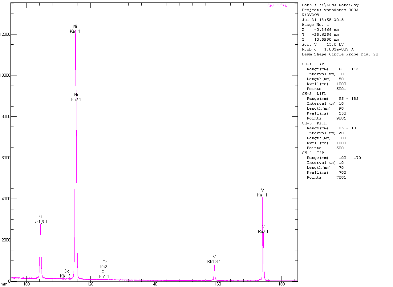

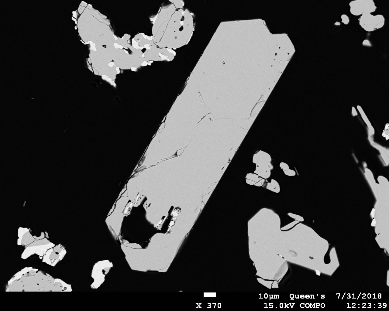

Although each reaction proceeded pretty ferociously, I was pleasantly surprised by what I found in the crucible after each run.  In each case, the run produced an easily crumbled agglomeration of fine crystals.  Although the crystal dimensions are relatively small (up to about 200 microns), the grains are generally still of adequate size for microprobe work.  The hardness is moderate, and polishing is easy.  In the Co vanadate run, I obtained mostly dark gray, irregular to equant crystals of Co3V2O8 with small amounts of Co3O4 and Co2V2O7; inclusions of CoO are present in the Co3O4.  In the Ni vanadate run, I obtained mostly golden brown, euhedral, prismatic crystals of Ni3V2O8.  Some grains have coatings of NiO.
Co3V2O8:
Ni3V2O8:

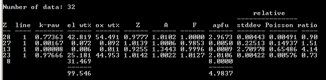

In wavelength scans, the only impurity I can find in the Co3V2O8 is a small amount of NiO, which averages 0.16 wt% in 30 quantitative analyses and is a bit disappointingly variable, with values ranging from 0.00 to 0.35 wt%.  Conversely, I was able to find a small and more uniform amount of CoO in the Ni3V2O8.  In analyzing the Ni3V2O8 (32 analyses), I used the Co3V2O8 as a V standard (and synthetic liebenbergite as Ni standard) and obtained the following results, which I find pretty acceptable at least for V2O5.  The NiO is low perhaps due to inaccuracy in the atomic number correction; I'll post analytical results again once I've grown some NiO to use as a standard:
PAP/MAC30:
Armstrong/FFAST:
