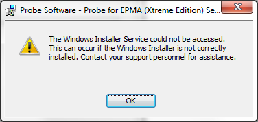

Microsoft is always breaking this...  recently I've been getting this error message on some computers but not all (again) when trying to update PFE (or CalcZAF) from the Help | Update dialog.
However, the installers (ProbeForEPMA.msi and CalcZAF.msi) both run fine when run again by double clicking them in the ProgramData folder. Usually

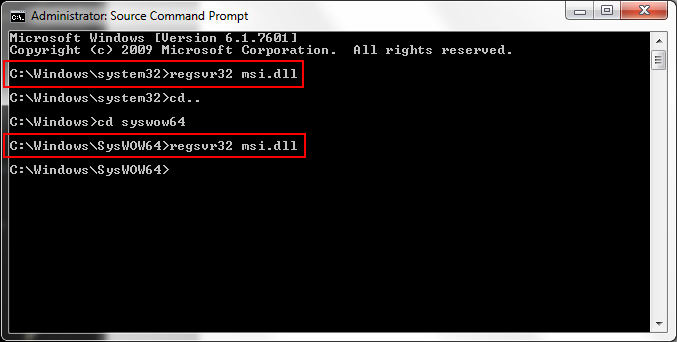

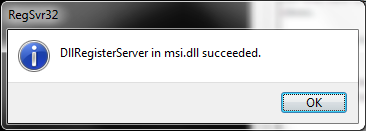

The last time this happened I was able to fix this issue by typing:
regsvr32 msi.dll
from the system prompt in admin mode. And interestingly enough, typing the same thing fixes this new issue. It appears that one or more Microsoft updates somehow de-registers the msi.dll Windows installer file. Why?  I have no idea.
So, if you get the error message shown above and re-running the installer irritates you (it sure irritates me!), then try running the above command from a system prompt.
For Win 7, Win 8 and Win 10, type "cmd" from the Start button "Search programs and files" field and when the cmd.exe app shows up in the found list, right click it, then select Run As Administrator, then type "cd \Windows\SysWOW64" then type the "regsvr32 msi.dll" command and you should get the message seen here:
For Win XP, run the command prompt from the \Windows\System32 folder.
glennpoirier
Thanks for that John, nice to know it wasn't just me breaking things
Quote from: glennpoirier on June 20, 2016, 12:49:02 PM
Hi Glenn,
Microsoft breaks more things than anyone!  Seems like I'm always playing "catch up" with them.
I expect that they will eventually fix this with another update, but who knows when...
indeed, this is a problem that occurs out of the blue after a windows update and is common enough that there are myriads of how-to's and apps on the web (and no sign of Microsoft fixing it). When the de-/re-registering of the installer does not "take" or there are more problems with the registry, there is a nice free Windows repair app at Tweaking.com
#24
It must be Monday.  :(
Because when I went to update Probe for EPMA, after the new version was downloaded and the installer tried to start, I got this error on my office computer (though the updates/installs were all perfectly fine on the lab computers!):
So I remembered from a while ago that this could be fixed by re-registering the Microsoft msi.dll file using an "admin" command prompt as seen here:
I gave this "regsvr32 msi.dll" command from both the System32 folder and the SysWOW64 folder, but I suspect that the command only needs to be executed from the SysWOW64 folder.
And after this the PFE installer ran fine.  It's always something with Microsoft Windows...
