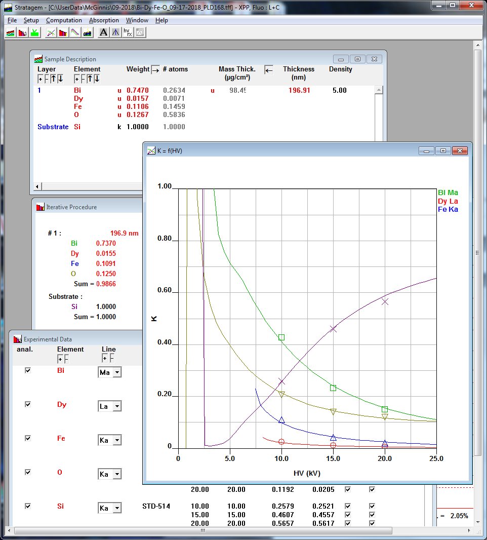

Currently the "gold standard" for thin film calculations is STRATAGem, though it will be interesting to see how the new BadgerFilm software from Moy compares. STRATAGem is based on the method of Pouchou and Pichoir and performs a full fluorescence correction for each layer including the substrate. It can also handle multiple layers of films and also correct for coating effects. For example, Si substrates can significantly fluoresce thin films containing P or S, and with very thin films (<50 nm), coating effects can become significant.
In this comparison I will compare the results from STRATAGem to the extremely simple thin film/particle correction method from Armstrong that is implemented in PFE.  First it should be noted that the Armstrong correction is not really a thin film correction, it is really a particle correction with an option for films without a substrate, or at least a substrate that does *not* fluoresce any elements in the film. So it should be used with care and all results should be taken with a very large "grain of salt". Still it is interesting to compare.
Let's start by looking at results from STRATAGem for a Bi, Dy, Fe oxide thin film that has intensities measured at 10, 15 and 20 keV:
As you can see the iterated totals on this film (integrating intensities from 10, 15 and 20 keV measurements) came to almost 99% (I usually accept thin film totals between 95 and 105%) and the K vs. HV model fit the measured intensities nicely. And assuming a density of 5, the linear thickness is around 200 nm or 0.2 um.
This gives us a normalized values of Bi = 75 wt%, Dy = 1.6 wt%, Fe = 11 wt% and O = 12 wt% in round numbers.

Alright, let's recall the results from STRATAGem for comparison (we're assuming the STRATAGem results are correct of course!):

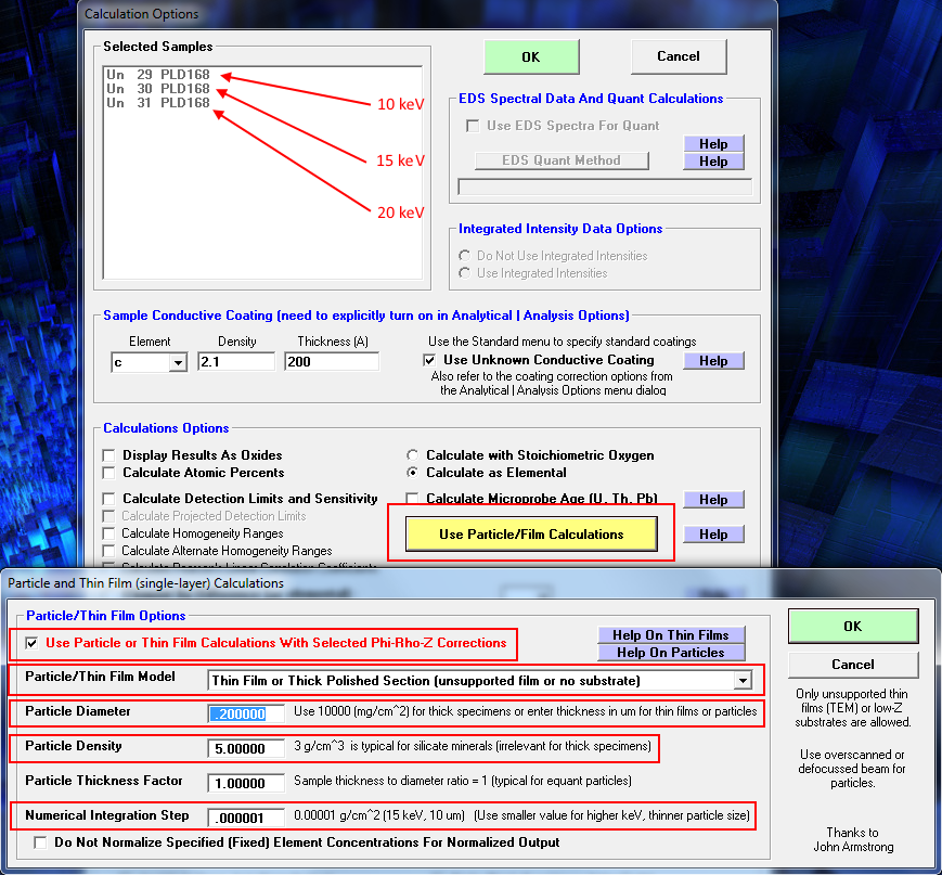

So now we go to the Analyze! window in Probe for EPMA, select our samples (remember we already disabled quant for Si since it's in the substrate and the Armstrong particle/thin film cannot handle substrate physics), and click the Calculation Options button, then we click the Use Particle/Film Calculations button as seen here:
What we do is first check the Use Particle or Thin Film calculations checkbox, then enter the thin film thickness in microns in the Particle Diameter field (0.2 um for our ~200 nm film), then 5 for our assumed density, and optionally we can decrease the Numerical Integration Step (size) by 10 for very thin films, though at 200 nm this is a fairly normal thickness film. Then OK, and OK.
Now let's see our results for 10 keV:

Well that's actually not too bad, the oxygen is a little high, but the other elements are pretty darn good for a simple numerical integration!
