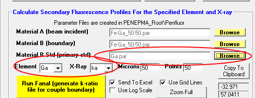

Next we can try the FeGa binary in the Penfluor/Fanal calculations as described here by specifying the same material for both the beam incident and the boundary material as described here:
http://smf.probesoftware.com/index.php?topic=151.0

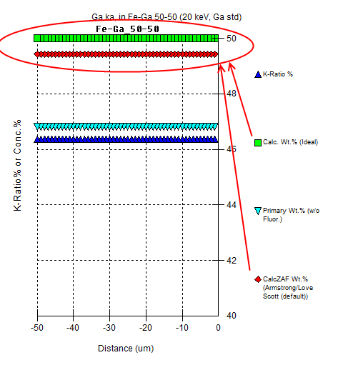

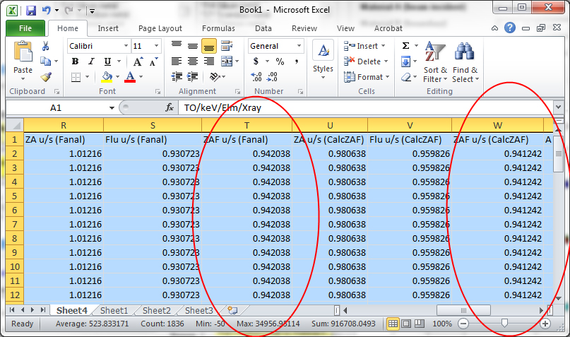

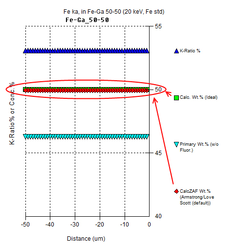

Now if we look at the Penfluor/Fanal k-ratios calculated for say a 50:50 weight fraction composition we get this table for Fe Ka:
and the display shows that both CalcZAF (Armstrong/Reed) give very similar results:
and this table for Ga Ka also at 20 keV but note we changed the line to Ga Ka and standard to Ga:
and this for the display:
We can see there is a small but significant difference between the analytical and Monte-carlo models for Ga Ka.

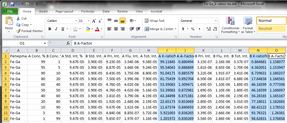

The results from the full Penepma Monte-Carlo are shown here  by simply opening any of the k-ratio files in Excel. Here is the Ka lines file for Fe and Ga:
The k-ratio (%) and alpha factors are shown. Again we can see that Fe is significantly fluoresced and Ga Ka significantly absorbed.  We can compare these to the Penfluor/Fanal results for Ga Ka at 20 keV from above as seen here:
Note that the alpha factors are "only" the effect for the element by another element. To convert the alpha factors to a matrix correction, or "beta" factors as they are usually referred to, one must compound them using the method described in the attached poster below.
Why, because we need to include the effect of the element by itself as an absorber, which is 1.0 by definition of course. So we need to take the fraction of the Fe-Ga binary but also the fraction of the Fe-Fe and Ga-Ga binaries which again by definition are 1.0.

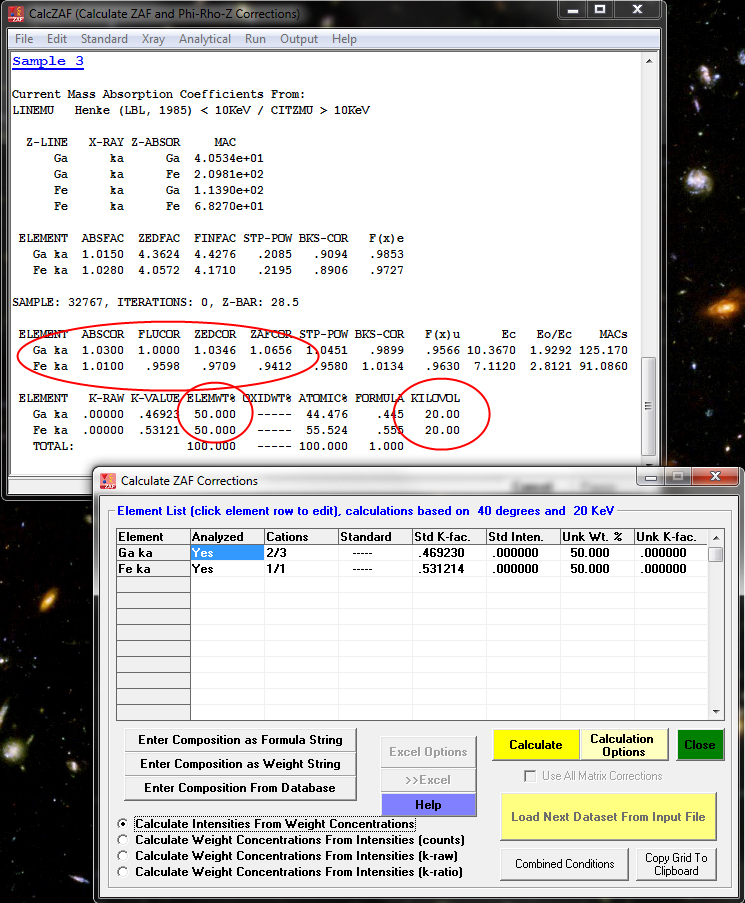

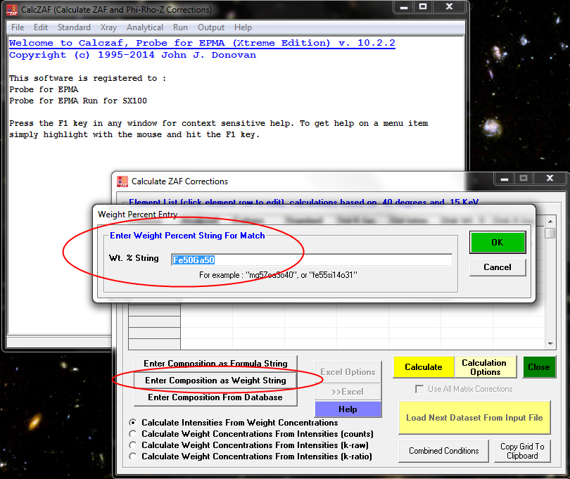

But to take an example using CalcZAF we can enter a nominal FeGa 50:50 wt% compound as seen here:
We also need to enter 20 keV in the Analytical |Operating Conditions menu. Then we click the Calculate button:
Again we see a significant fluorescence for Fe Ka and significant absorption for Ga Ka.  Let's change things up by switching to alpha-factor calculations from the Analytical | ZAF, Phi-Rho-Z, Alpha factor and Calibration Curve Selections menu.

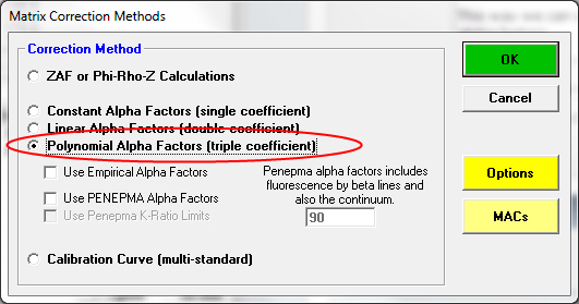

This way we can see the same k-ratios from our Armstrong/Reed analytical model expressed as polynomial fit alpha factors. First we select alpha-factors:
Then we click the Calculate button again and get much more output, finally this summary:

So these "beta" factors are essentially the matrix correction factors for this composition at 20 keV and as one can see they are very close to the pure Phi-rho-z calculations above.
Ga Ka 1.0656 compared to 1.0656
Fe Ka 0.9414 compared to 0.9412

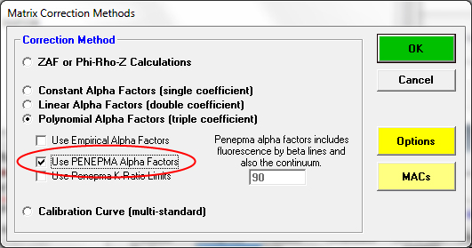

Now it gets interesting.  Let's now utilize the Penepma Penfluor/Fanal Fe-Ga binary k-ratios as alpha factors by checking this box here:
Now we click calculate again and here is our output, notice the k-ratios loaded from the matrix.mdb database:

Close to the Armstrong/Reed analytical calculations but but little different.  Which is is more correct?  For these high energy lines I would say the Penfluor/Fanal calculations, but one would want to compare these calculations with measurements on standards.

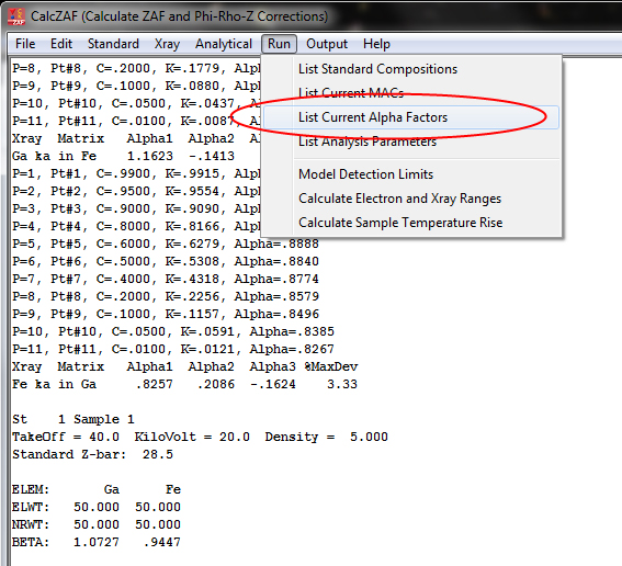

By the way, any time one wants to know if the alpha factors are from the Penepma calculations or not, simply click the Run | List Current Alpha Factors menu here:
and then you will get output for all currently utilized binaries as seen here:
Penepma K-Ratio Alpha Factors:
Xray  Matrix   Alpha1  Alpha2  Alpha3
Fe ka in Ga     .8257   .2086  -.1624    *From Penepma 2012 Calculations
Ga ka in Fe    1.1623  -.1413   .2145    *From Penepma 2012 Calculations
