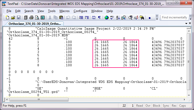

You can see these start/end beam currents for each spectrometer pass in the CalcImage /CIP project file:

Here is the beam current measurement section from an x-ray map I acquired in January this year on our SX100:
[Measured/BeamCurrent]
Start=2.61665e-08
End=2.61864e-08
Not sure why you are seeing the same exact beam current for both.  What version of Probe Image are you on?  The current version is 1.3.6.

The currents in the CIP project file match what I was manually measuring (as opposed to ProbeImage). If the current is beam drift corrected and I've standardize pre and post map, I guess I'll have to think about another reason why I might be losing weight percent as the map progresses (beam damage, etc.?). The only other weird thing from the maps is that while it collects from top left to bottom right, my weight percent maximum is in the top right corner and my minimum is in the bottom left. Thanks for the reply.
I don't quite see how it could be possible that the beam current values in the .CIP file don't match the beam current values in the PrbImg files. Since that is where CalcImage gets them from when you create a new CalcImage project!

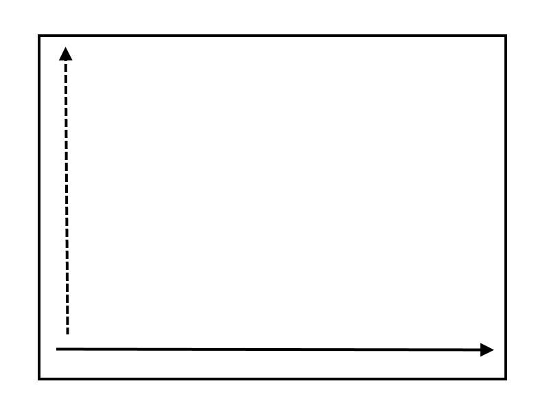

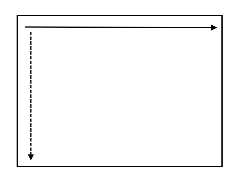

In Cameca instruments (and also JEOL instruments performing a beam scan acquisition), the pixel acquisition order is what one would expect.  The acquisition starts in the upper left, and proceeds to the lower right, with the X dimension being the direction of fast scanning. As depicted here:
The solid line being the fast scan direction, and the dashed line being the slow scan direction.

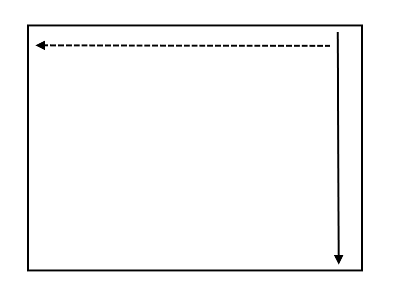

However, for JEOL instruments, while the beam scan pixel acquisition order is the same as the Cameca instruments, the stage scan acquisition pixel order is different. Specifically, the x-ray map acquisition proceeds from the upper right to the lower left with the fast scan direction in the Y dimension, and the slow scan direction being the X dimension direction as seen here:
My personal hypothesis is that this is a historical remnant from Nippon Steel requirements in the 1950s , but ultimately related to how Japanese newspapers written in Katakana are read.  I could be wrong.   In any case, the pixels are acquired in two different ways, and this is all complicated by the fact that the quantitative array processing in CalcImage is performed in yet another direction as seen here:

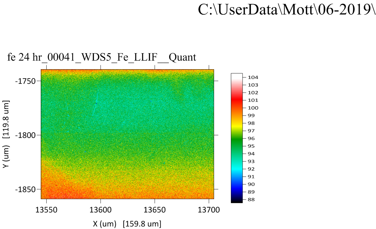

Here is the test map that Andrew did on his SXFive over a 24 hour period. For this test he simply mapped his pure Fe metal standard.
Here is the raw on-peak intensity map:
As one can see all of the beam drift occurred in the first few hours of the scan, and was over a 10% change (100nA to 89 nA). After the map is quantified, the beam drift correction is CalcImage is automatically applied and attempts to correct for the beam drift as seen here:
Unfortunately because the beam drift was so non-linear, the linear beam drift correction could only do so much. Of course when one's beam is drifting this much one should not even attempt quantitative x-ray mapping!  But at the time we we weren't quite sure exactly what the problem was so we ran a test acquisition to find out.

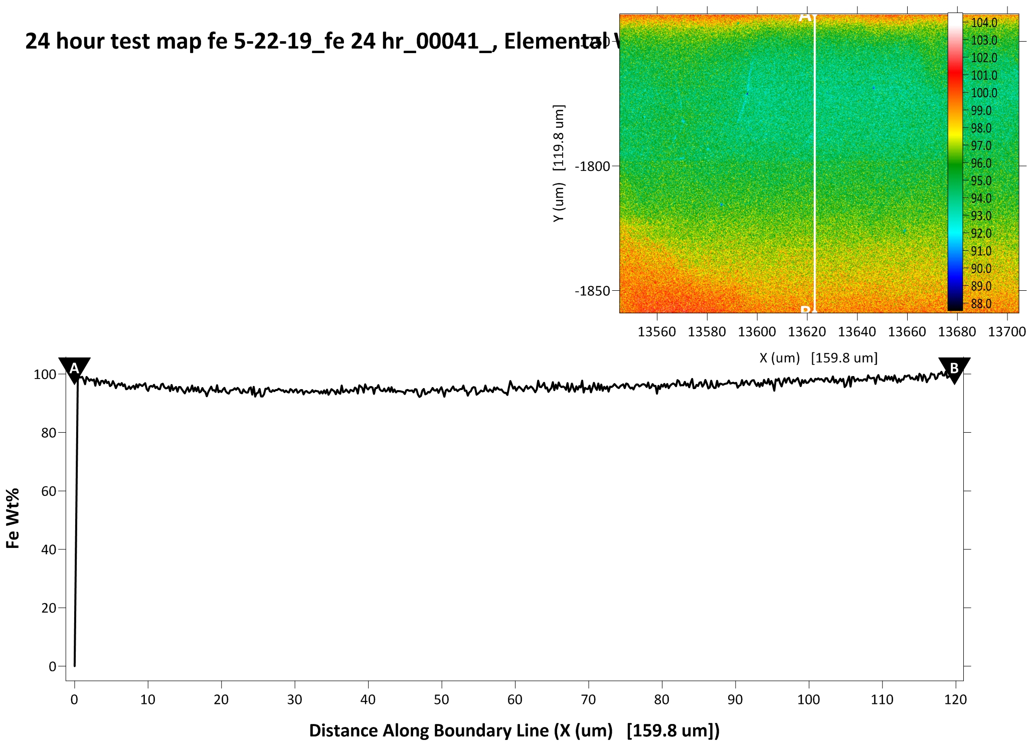

Here's what the quant map looks performing a slice script output in CalcImage:
Darn, looks like I picked a starting point slightly outside the map so it starts at zero wt%!  Anyway, this is why we found the object naming issue in the slice, polygon and strip scripts yesterday, which is now fixed in the latest Probe for EPMA v. 12.6.3 update.
