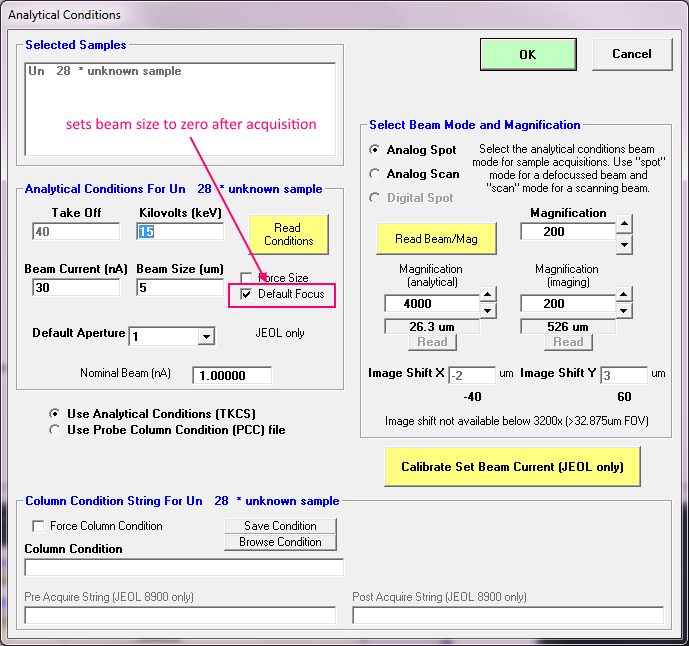

OK, we've made a small change in the imaging code that we think should avoid the issue that Bill Mushock is reporting on his JEOL 8900.
But it should first be pointed out that the "Default Focus" feature, seen here:
is key to this situation.  Basically, when this box is checked (in the Analytical Conditions dialog in PFE), whenever an acquisition or automation completes, the software re-sets the beam size to zero.  The idea being that one can then simply unblank the beam and image with a fully focused beam. This is the default mode in PFE as many of you already know, but it essentially has no effect if the default beam size is already zero (fully focused).
However, if the user prefers to leave the beam size non-zero (for whatever reason), simply uncheck this box and the beam will always stay at the specified (non-zero) beam size.
Now, when it comes to image acquisition, the latest v. 12.7.8 PFE will first check if the beam size is already zero, and if it is already zero, it will not change the beam size. We think this will take care of the OL changes that Bill is seeing on his JEOL 8900 when the beam size is reset to zero.
But if for some reason the beam size is left at a non-zero value, or reset by other software to be non-zero, the imaging code will reset the beam size to zero, ensuring that the image acquired is fully focused.
Please let us know how this works for you all.
Edit by John:  In summary, I suggest everyone use the Default Focus feature so the beam is generally at beam size zero. Then when one starts an image acquisition, the beam is already at size zero, so the beam size command is not sent.
