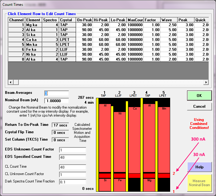

It's a legitimate concern if you are analyzing major elements using beam conditions for trace elements.  But what we normally do is run two conditions as seen here:
In this example (from a run by Karsten Goemann at the University of Tasmania), the major elements are acquired at 30 nA, and then the conditions are switched to 300 nA for the traces.  This is often done not only because of high count rates/deadtimes for major elements, but also to avoid beam damage effects for the major elements (regardless of the Bragg crystals utilized).
Of course, as mentioned by sem-geologist, this could be probematic for the SXFive instrument, which apparently takes time to stabilize after changing conditions, but Cameca Sx100 instruments and all JEOL instruments should have no issues with this type of acquisition.
