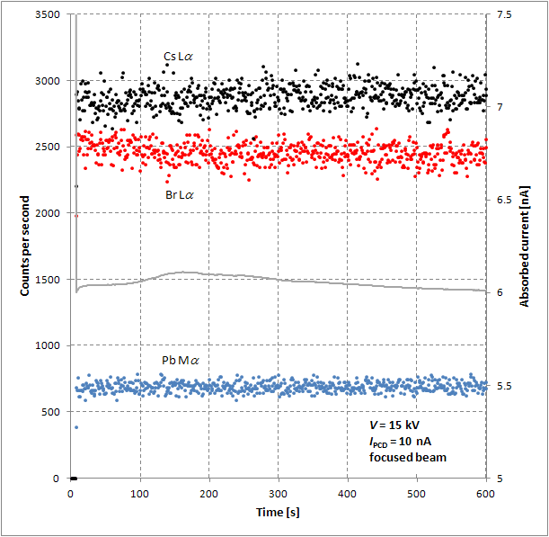

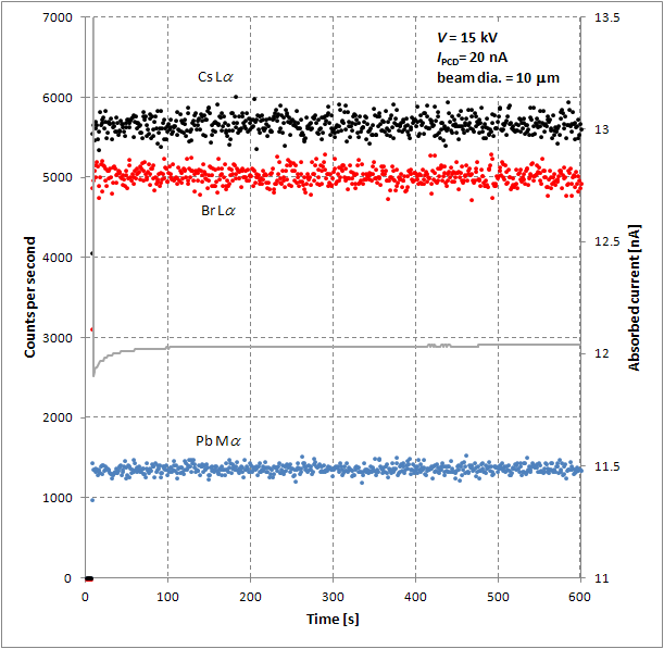

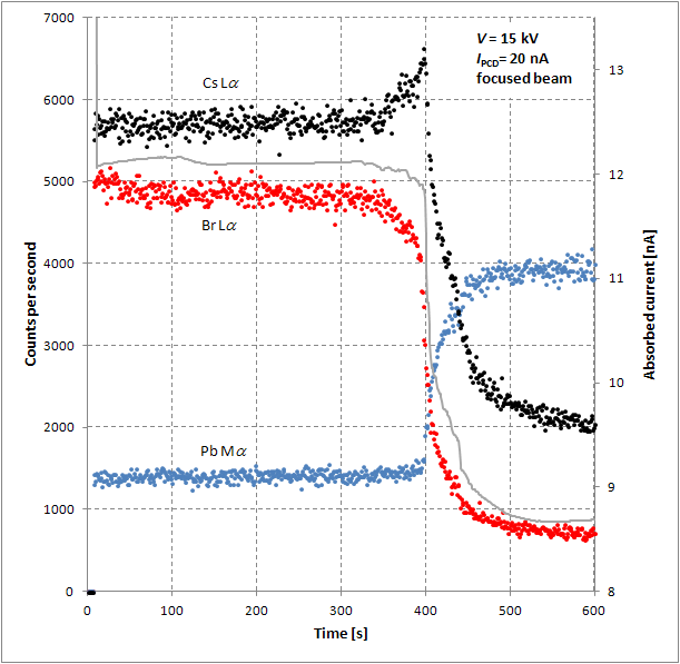

Following on the discussion of potential bromine standards, recently I had the opportunity to investigate some CsPbBr3 (22.92 wt% Cs, 35.74 wt% Pb, 41.34 wt% Br) grown by a graduate student in the Chemistry department here; I believe she used the Czochralski method to grow it.
Water should be avoided during polishing, as the compound is at least somewhat soluble in it.
Considering the composition, I was surprised at how well it held up under the beam.  At beam energy = 15 keV, beam current = 10 nA, and the beam finely focused (minimal astigmatism), the Br La count rate and absorbed current tend to be a little unstable.  In contrast, at 20 nA (focused), very bad things happen.  Working with a 10-micron beam diameter at 20 nA gives much better results.
It appears that the compound can handle beam currents below 20 nA (at 15 keV) as long as the beam is defocused to 10 microns.  I'm calling it a winner!
10 nA, focused beam:
20 nA, focused beam
20 nA, 10 micron beam diameter
Quote from: Brian Joy on February 16, 2021, 12:54:52 PM
