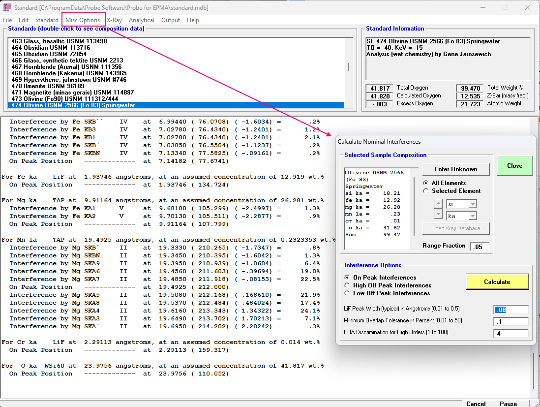

Using the Standard application (included with the free CalcZAF software) I selected an olivine standard (USNM 2566), edited the Mn line from Ka to La, changed the crystal from LiF to TAP, and selected the Misc Options | Interferences menu dialog and calculated the possible interferences:

The results from the (nominal) interference calculations are:
On Peak Interferences for : St  474 Olivine USNM 2566 (Fo 83) Springwater
For Si ka    TAP at  7.14182 angstroms, at an assumed concentration of 18.207 wt.%
  Interference by Fe SKB      IV    at  6.98090 ( 75.9239) ( -1.7502) =       .1%
  Interference by Fe SKB``    IV    at  6.99440 ( 76.0708) ( -1.6034) =       .2%
  Interference by Fe KB3      IV    at  7.02780 ( 76.4340) ( -1.2401) =      1.2%
  Interference by Fe KB1      IV    at  7.02780 ( 76.4340) ( -1.2401) =      2.1%
  Interference by Fe SKB`     IV    at  7.03850 ( 76.5504) ( -1.1237) =       .2%
  Interference by Fe SKBN     IV    at  7.13340 ( 77.5825) ( -.09161) =       .2%
  On Peak Position   -------------  at  7.14182 ( 77.6741)
For Fe ka    LiF at  1.93746 angstroms, at an assumed concentration of 12.919 wt.%
  On Peak Position   -------------  at  1.93746 ( 134.724)
For Mg ka    TAP at  9.91164 angstroms, at an assumed concentration of 26.281 wt.%
  Interference by Fe KA1      V     at  9.68180 ( 105.299) ( -2.4997) =      1.3%
  Interference by Fe KA2      V     at  9.70130 ( 105.511) ( -2.2877) =       .9%
  On Peak Position   -------------  at  9.91164 ( 107.799)
For Mn la    TAP at  19.4925 angstroms, at an assumed concentration of 0.2323353 wt.%
  Interference by Mg SKB`     II    at  19.3330 ( 210.265) ( -1.7347) =       .8%
  Interference by Mg SKBN     II    at  19.3450 ( 210.395) ( -1.6042) =      1.3%
  Interference by Mg SKA9     II    at  19.3950 ( 210.939) ( -1.0604) =      6.4%
  Interference by Mg SKA6     II    at  19.4560 ( 211.603) ( -.39694) =     19.0%
  Interference by Mg SKA7     II    at  19.4850 ( 211.918) ( -.08153) =     22.5%
  On Peak Position   -------------  at  19.4925 ( 212.000)
  Interference by Mg SKA5     II    at  19.5080 ( 212.168) ( .168610) =     21.9%
  Interference by Mg SKA8     II    at  19.5370 ( 212.484) ( .484024) =     17.4%
  Interference by Mg SKA4     II    at  19.6160 ( 213.343) ( 1.34322) =     24.1%
  Interference by Mg SKA3     II    at  19.6490 ( 213.702) ( 1.70213) =      7.1%
  Interference by Mg SKA`     II    at  19.6950 ( 214.202) ( 2.20242) =       .3%
For Cr ka    LiF at  2.29113 angstroms, at an assumed concentration of 0.014 wt.%
  On Peak Position   -------------  at  2.29113 ( 159.317)
For  O ka  WSi60 at  23.9756 angstroms, at an assumed concentration of 41.817 wt.%
  On Peak Position   -------------  at  23.9756 ( 110.052)
Note the interference of Mn La by the Mg Ka (II), second order line.  That's probably your problem.  You'll want to apply the quantitative interference correction in Probe for EPMA using an interference standard that contains Mg, but no Mn, say MgO:
