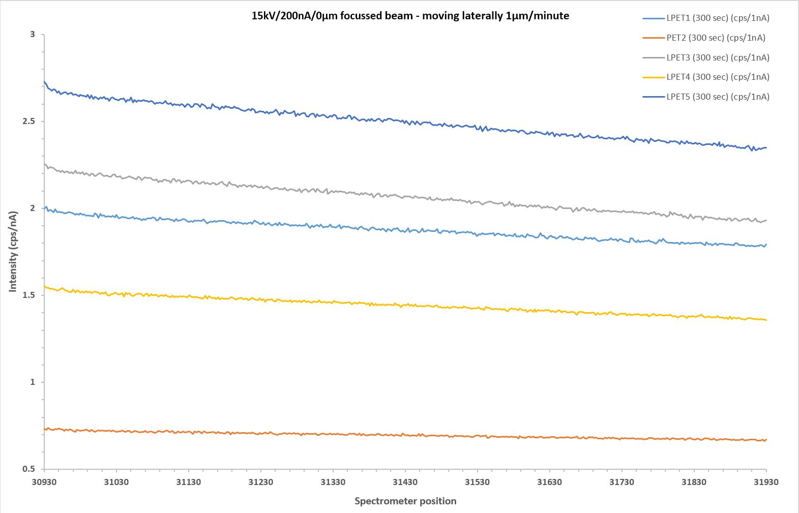

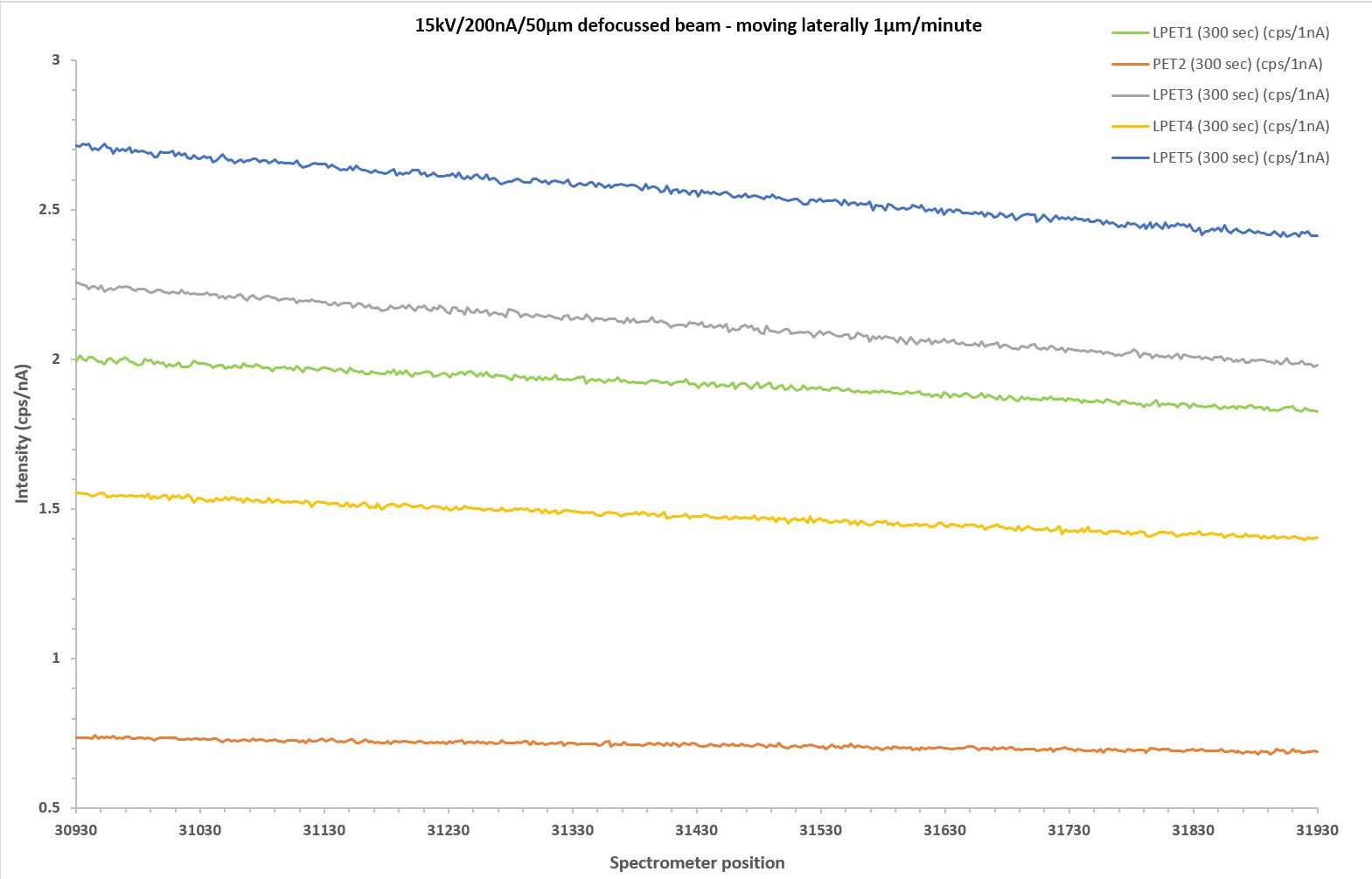

Here are the results from both a focussed and defocussed (50um) beam at 300s/point and 200nA on my Spectrosil glass. Again I still can't see any of the holes so suspect I may have got lucky..? As I mentioned my Spectrosil glass isn't completely pure (few ppm Ti), but I find it unlikely that it contains exactly enough concentration to "fill the holes" as it were on all five spectrometers which would in reality likely have different magnitudes of the artifact.
Thoughts?
Quote from: BenjaminWade on April 01, 2019, 04:43:26 PM
...but I find it unlikely that it contains exactly enough concentration to "fill the holes" as it were on all five spectrometers which would in reality likely have different magnitudes of the artifact.
Yes, I agree. Besides, while a small Ti peak might just fill the small hole right under the Ti peak position, it would not fill the larger hole just to the right.
So I would say either you got very lucky with your crystal manufacturing, or maybe Cameca got better at bending their crystals over time.  Your instrument being more recent vintage than mine (and Shui-Yuan's 8900).
I would still love to see similar scan data from JEOL (and other Cameca) instruments with PET crystals.  Can anyone else post some data scanning pure TiO2 with conditions similar to what Ben used?
