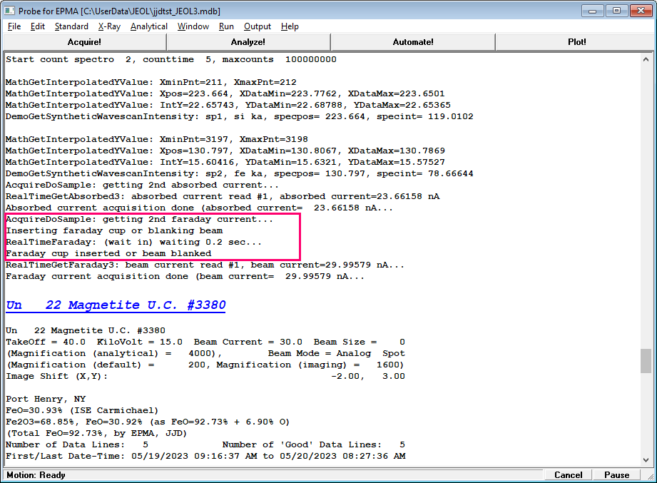

But that reminded me that there is a to see the current FaradayWaitInTime delay for the current run: and that is to acquire a data point with DebugMode turned on from the Output menu. Then one will see this output when the cup if first removed and measuring absorbed current (if that option was turned on):
After acquisition the cup is closed and the 2nd Faraday cup reading is performed as seen here:
In this case both the FaradayWaitInTime and the FaradayWaitOutTime values are set to 0.2 seconds.

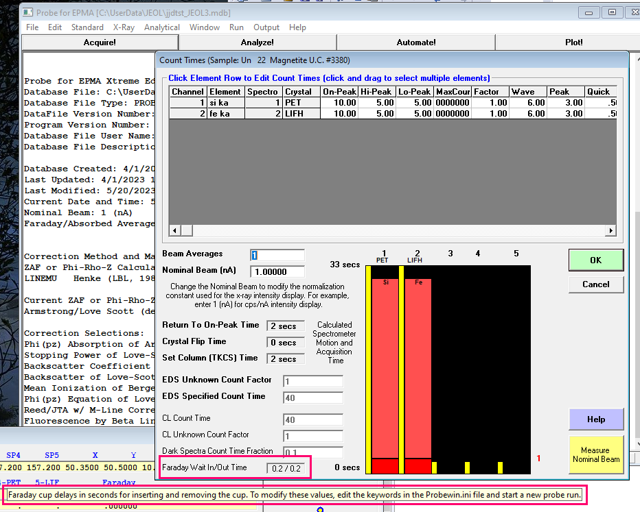

But just to make things even easier, we decided to modify the Count Times dialog and so now both these Faraday delay values are displayed as shown here:
