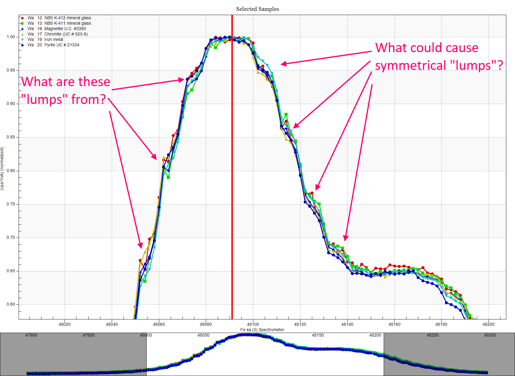

OK, so I ran another test run of Fe and also a Mn oxide and silicate against Fe and Mn metal primary standards and got more results.  Here are the Fe standards plotted in the Evaluate application:

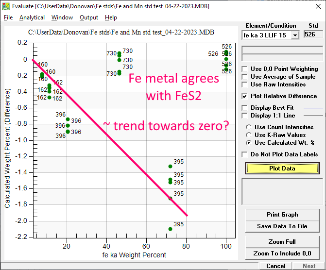

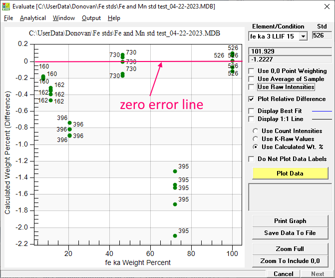

As you can see, the pyrite standard agrees excellently with the Fe metal primary standard, but the oxide, silicate and glass standards show a consistent error trend (in absolute wt% units) as one would expect if this is due to a systematic error.  Here is the analysis of magnetite:

So what could be causing this?  Next I will show some careful wavescans that might indicate the source of the problem...
So, to summarize the previous post in this topic, we appear to see a systematic error when analyzing oxide and silicate Fe and Mn samples using an Fe metal primary standard.  And this error appears to be somewhat larger for Mn Ka compared to Fe Ka. However, as Rom reported earlier, we do not see these accuracy errors when analyzing Fe sulfides using an Fe metal standard as seen here:
Now let's examine some high precision wavescans I did over the weekend starting with Fe Ka on the standards containing major concentrations of Fe:
These scans were run in my spec3 LLIF crystal (2 atm P-10) at 15 keV and aside from the strange artifacts in all the scans which we will discuss later, they all seems to be pretty consistent. Let zoom in a bit:
The artifacts are more visible and I've already asked several colleagues off-line as to what these may be from, as we do not seem them in the other spectrometers, but I'm guessing that they are some sort of mechanical issue. These are step/count scans (not ROM or continuous) using a step size of 2 sin theta units and 40 second count time for each point.
But again, the scans appear to be very consistent with no obvious differences between the Fe metal and the other secondary standards. The Fe metal being the cyan triangle symbols.

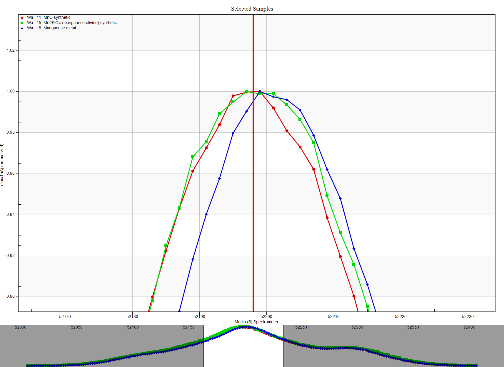

But now let's look at the Mn Ka scans on Mn metal and a MnO and Mn2SiO4 secondary standards:
There appears to be slight shift between the metal and the oxidized standards, and zooming in we can this shift a bit better:
I don't know if this explains the discrepancy we are seeing in the Fe and Mn oxide and silicate standards when extrapolating from metal standards, but it's worth considering. I guess even knowing that Mg, Al and Si ka show significant peak shifting between metal and oxide chemistry, I'm just surprised that Fe Ka and Mn Ka would still experience a detectable peak shift. I haven't tried this same test using a PET crystal, but I'll bet the peak shift for Fe and Mn Ka would almost certainly be less detectable.

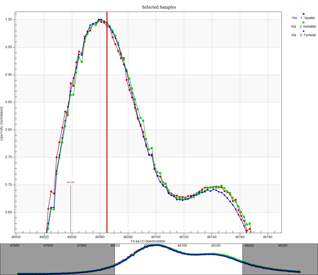

Thought I'd add to this as I had the machine to myself for a change and I've seen something similar before on both our Cameca when working on wustite/magnetite samples standardised to either Fe metal or hematite, and on our JEOL when working with steel samples.
I ran a few WDS scans overnight on our SX100 on Fe metal, hematite Fe2O3 and fayalite Fe2SiO4. I used the same conditions John mentions: 15 kV, step size of 2 sin theta units and 40s count time. I used a 20 nA beam defocused to 5 microns. I didn't peak centre first, hence the offset.
Here's the whole scan:
And zoomed in to a similar region as above:
Couple of things to note:
  • I can also see the "lumps", but much less pronounced
  • the Fe Ka1 peak seems much more peak like - there isn't a flat top on mine?
  • there doesn't seem to be a significant difference between the Fe Ka1 (K-L3) emissions for the various materials I've scanned
  • there does seem to be a difference in the Fe Ka2 (K-L2) position as a function of bonding environment
I mentioned that I was looking at steels on our JEOL - a few years ago, I was struggling to get decent totals between the samples and our standards, and did a few wavelength scans to work out what was going on. This is what I found:
That's two WDS scans on each phase, going standard-sample-standard-sample, using the same conditions on the same spectrometer. Count rates weren't particularly different between sample/standard. Wasn't expecting such a shift in the Fe Ka, and never really got to the bottom of what caused it!
Interesting that you are seeing these same "lumps" on your Cameca. I am going to ask our instrument engineer to clean the spectrometer gearing and see if that helps.
So the JEOL scans were performed on your Fe metal standard and another Fe metal standard?  If I saw such a shift like that I would assume it's some sort of mechanical glitch...
