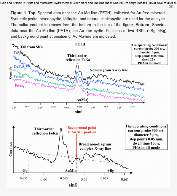

Here's a great example of a sample absorption edge artifact requring special treatment in a recent (Kovalchuk et al., 2024) paper:
https://www.mdpi.com/2075-163X/14/2/170
Yes, one could play all sorts of games trying to get one's off-peak positions adjusted exactly right, or... one could obtain a high purity synthetic (or even natural) pyrite with no detectable gold, and utilize the blank correction in Probe for EPMA.
