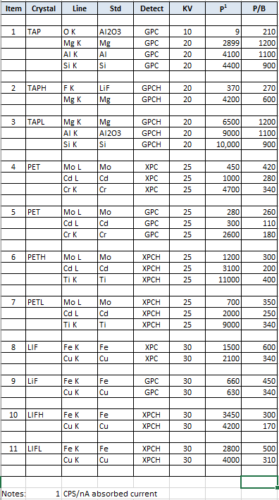

Does anyone have any experience (or data) with H-type vs L-type PET and LiF crystals? In particular, Peak-to-background and intensities. Thanks.

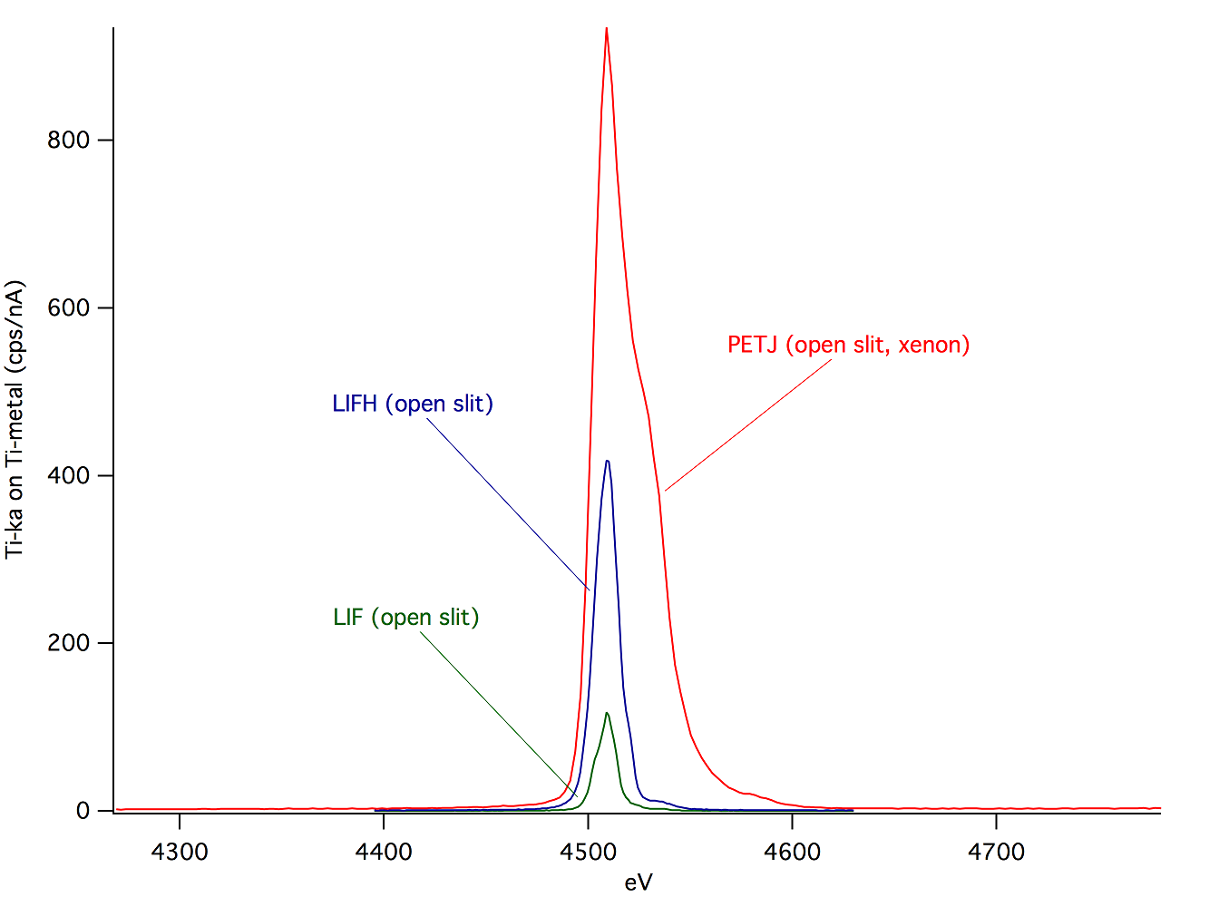

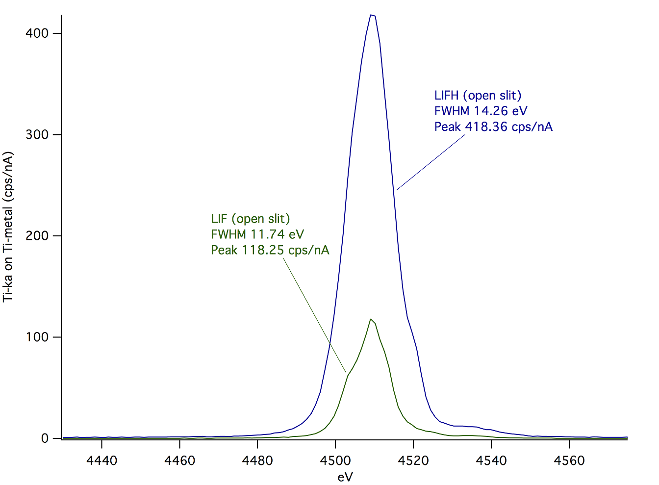

I would say that in general one should avoid the H type crystals as they are highly curved and tend to crack over time making them unsuitable for quantitative work. They also have a much smaller focal circle which lowers the spectral resolution. The L types are larger and therefore have more intensity and utilize the same focal circle (I think) as the normal crystals.
Here is a comparison of LIF vs LIFH vs PETJ for Ti ka on Ti metal from my old JEOL JXA-8900R at the University of Minnesota. I see if I can add the data for the L-variants as well.

I would agree as far as regarding the TAPH crystal but I have not heard of cracking of PETH and LIFH crystals (anyone has stories?). I personally think the L-type versions are the best of both worlds with great intensities at comparable spectral resolution to the regular-sized crystals but the H-type spectrometers are still widely popular in Europe (and probably beyond). The significant price difference between an H-type spectrometer and the same configuration with L-type crystals is probably the main reason behind this.

I think this is what you are looking for: A comparison of JEOL monochromator performance
